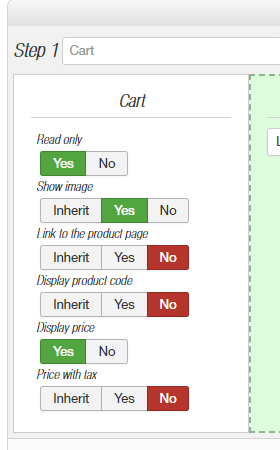

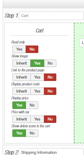

Followed the steps, I did have the "delete" button already on in the cart in the checkout, I just wanted to make it Readonly.
So I set readonly, and deleted, see attached and when I go to the checkout, there is no Delete Button.
The images below are
Step 1 set delete hikashop-cart-delete.png (delete set to yes)
Step 2 set readonly hikashop-cart-readonly.png (readonly set to yes, no delete button available)

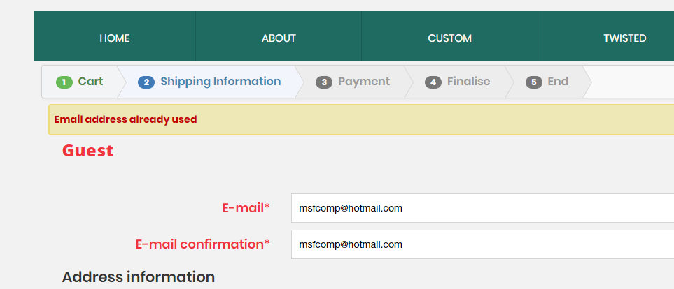

Also, another issue, A guest user returning, cannot user the same email address, the system says "email already used". hikashop-guest.png
Is there a way to get around this issue as well ???

  • Posts: 85952
  • Thank you received: 14142
7 years 11 months ago #296254
As Mohamed said, you can't have both.
Either you turn off the "read only" and you have the option to display or not the delete button, or you have the read only turned on and you can't display the delete button.
If you want both, you would have to turn off the read only option and then use either CSS or PHP modification in the show_block_cart view to hide the quantity input field.
