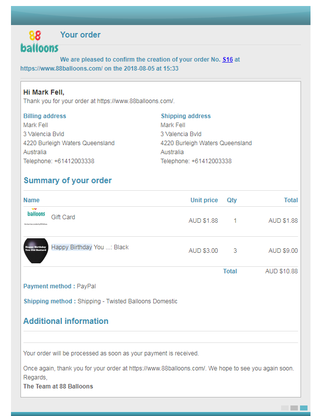

The giftcard custom field in the checkout when filled in and added to the cart, is see on the front end.
When checkout is complete. The custom field name and image is displayed on the invoice and email.
But the wording is not seen, nor is it saved in the database.

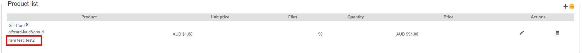

I can open the order in the backend, edit the custom field and add some text and it will then display in the invoice, shipping invoice and email.
What is missing that is doesnt happen at checkout ?
A side note, my second custom field, which is a file upload works, uploads the file and the name information is shown in the backend, invoices, and emails. The only difference this is a item with a field type "file" not "text" as the giftcard custom field.
Please see attached
Thanks in advance,
MSF

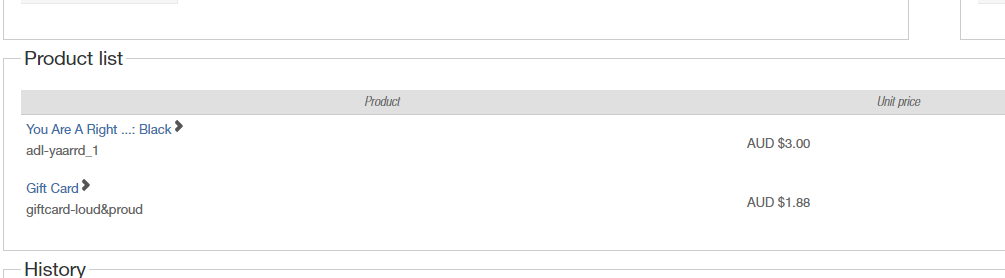

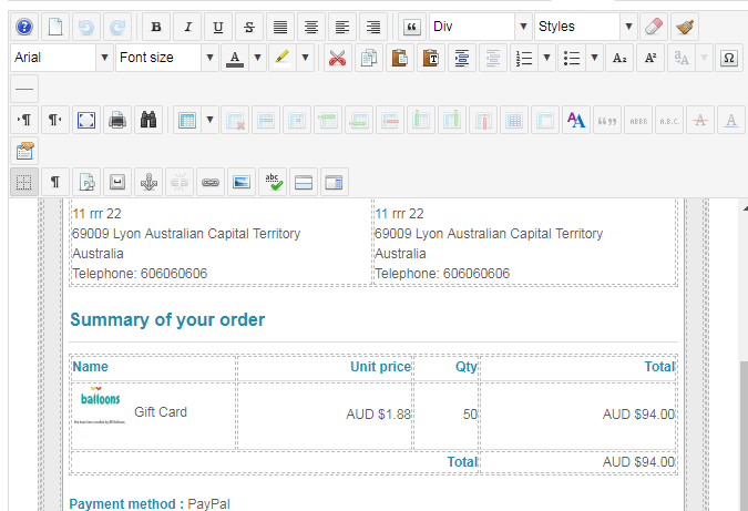

Last edit: 7 years 11 months ago by markfell. Reason: Did another test and looked in phpadmin at the order database, "null" Also added the images from the email.

You have a custom item field. Your screenshot from your database is from the table hikashop_order, however, the data of custom item fields is not stored in that table but in the table hikashop_order_product so you need to check there.

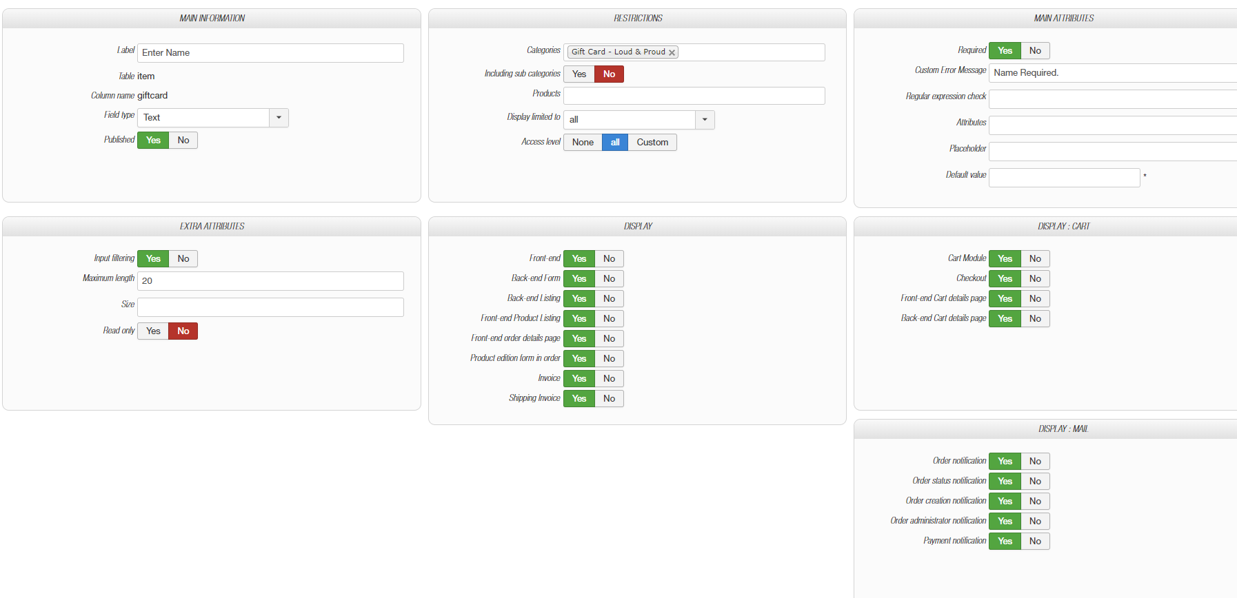

After a lot of tests we found that you issue was coming from your custom item field's "column name" value, can you test it after re-creating another custom item field with another column name ? Thank you.

Changed it to giftcard_name and works a dream.
Is "giftcard" a reserved word in the system ??
MSF
  • Posts: 85952
  • Thank you received: 14142
7 years 11 months ago #296443
That's because you must have previously created a custom field of the table "product" named "giftcard" and there is an issue in that case in the way the system works as it has to merge the data coming from the product in the cart and the data from the product itself at some point. And if you have a column "giftcard in the hikashop_product table and one in the hikashop_cart_product table, then the one in the hikashop_product table will take priority.
So no, that word is not reserved and that's why Mohamed didn't had the error on his end when testing on his own test website.
In the next release, we'll add a check so that you can't create a custom item field with the same column name of a column in the hikashop_product table. That will avoid someone else having the same problem.
