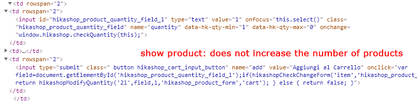

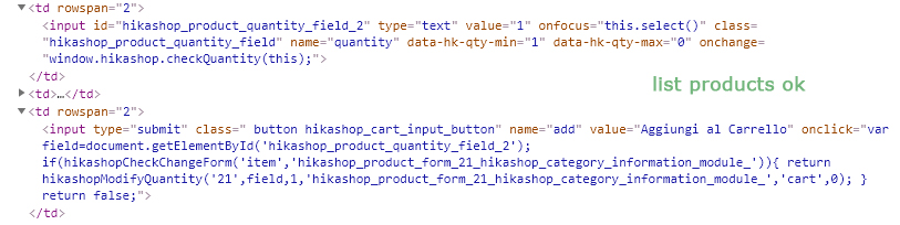

I have a problem with increasing the number of products before adding to cart.
It works regularly in the product list
it does not increase the number of products in the single product page
I saw that the button code to add more products to the cart is different in the product list compared to the product page
I attach a few screenshots of code to understand better

  • Posts: 42
7 years 11 months ago #296355
I tried to disable the legacy settings but the problem is not solved
But we must first understand the problem
try to follow these steps
1) add to cart more than one product from the product list (ok)
monosnap.com/file/Fp0sjQJigmvbsu2xnfqeFkxRxaJo5K
2) add to cart more than one product from the single product sheet (does not work)
monosnap.com/file/5cLb6jhDGYgB7vvIJSkI4B9xS3PT3Q
3) shopping cart:
monosnap.com/file/kIq9HZNiO7WcSUuKEZRFdG9BvBnooL
  • Posts: 42
7 years 11 months ago #296357
I tried to cancel my changes to the show_default.php page and now it works correctly.
Now I try to reload my changes one at a time to see which one is causing the problem
thank you
