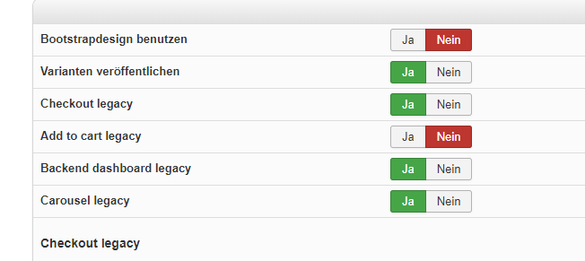

I have a problem but didn't know, if it never worked or since the update
When i put a product in the cart, it didn't refresh it self. The cart module didn't show any prodcts.
When i refresh the side manually, then it shows the product in the cart module.
Can i make a refresh anywhere in the hikashop settings?
I have the mini cart as module in the sidebar.
Same Problem with IE and Chrome.....

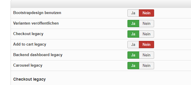

Ok afterdisabling the add to cart legacy in the settingsit works...
But there must be a problem in the legacy settings now right?

It's something linked to the update yes. You've updated the cart module but still using the old add to cart buttons.
Turning off the add to cart legacy setting is a good thing to solve that issue.
In fact, you should even turn off the other legacy settings. They are only useful to keep on if you have issues when turning them on. In fact, when you install a new HikaShop, they are automatically off since you normally want to use the new systems.

So i will turn all legacy settings of.
