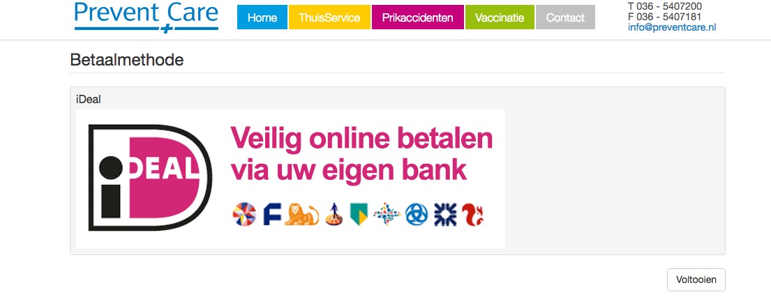

The checkout page flow changed after I updated to 3.5.1.
Before the update I when I clicked submit in the one page checkout the next page would be the actual bank selector page.
Now I get an extra page with the payment block
This is the situation before the update.
www.useloom.com/share/e2317ac59c0f46a39d305bf702a4fc3d

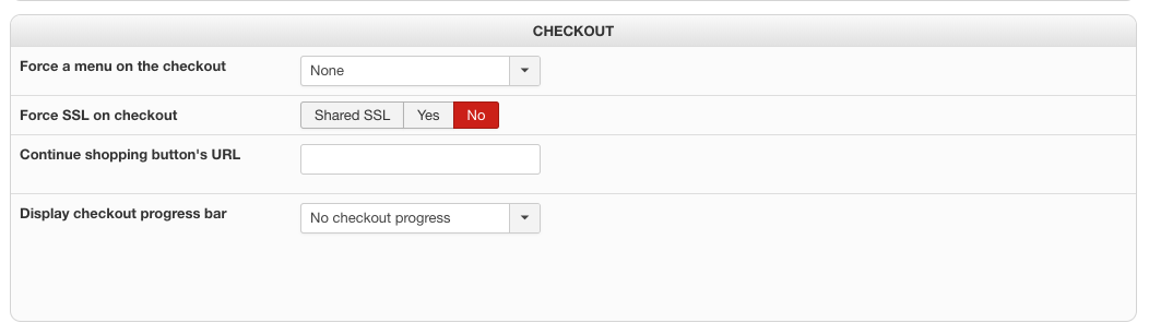

Could you provide a screenshot of the settings under the "Checkout" tab of the HikaShop configuration ?

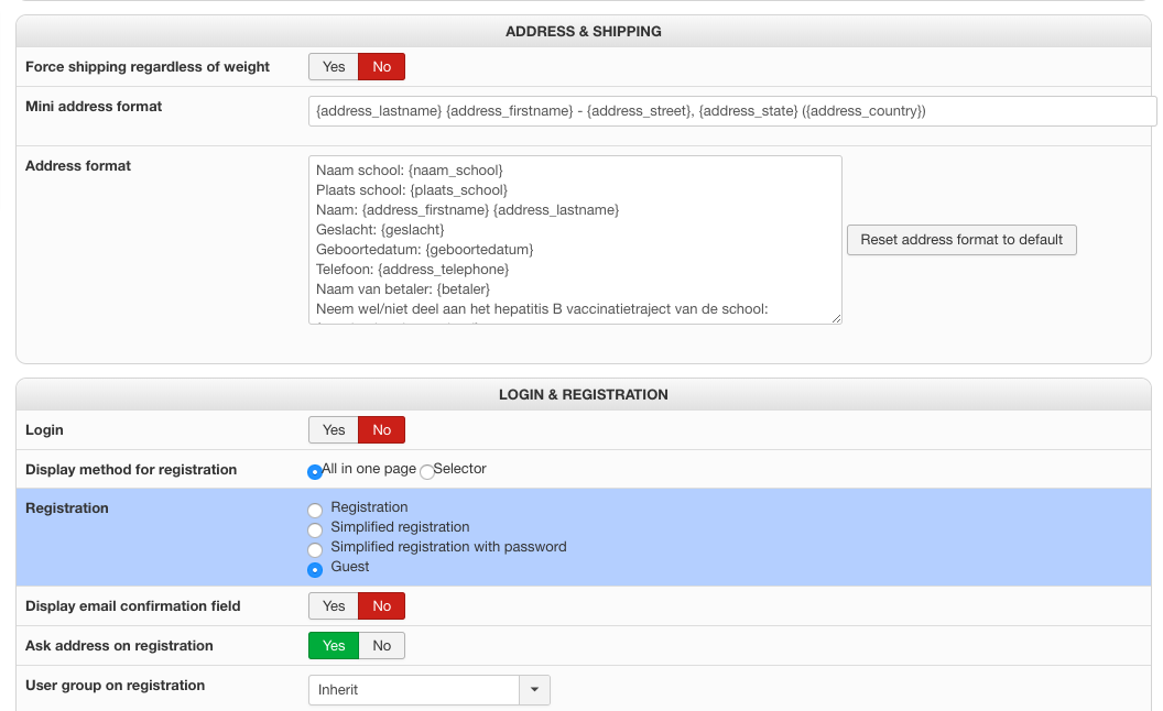

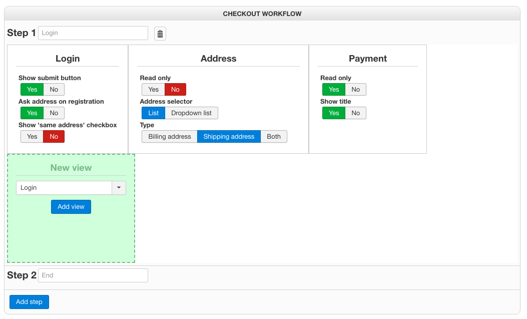

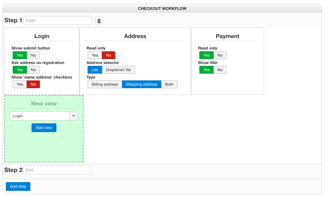

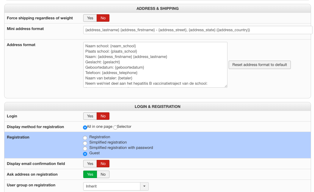

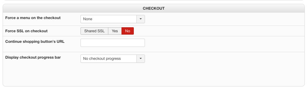

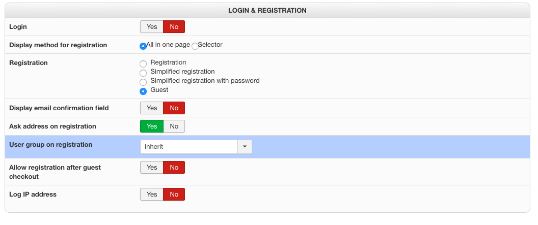

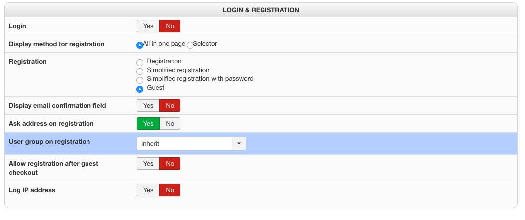

  • Posts: 8
7 years 11 months ago #297118
I installed the bank transfer payment method and the behaviour is the same.
I attached screenshots of the configuration.
