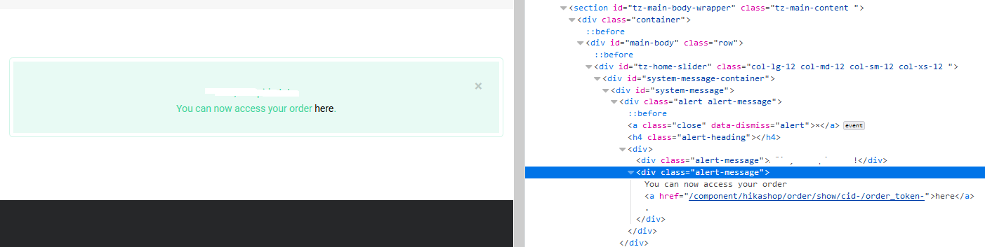

I have been customizing after_end.php file and found that if user is not logged in during checkout the order amount, order token and order number is missing. Basecly $this->order returns NULL if user is not logged in...
To be sure i also tried with default protostar template and received same issue.
Here is the screenshot of default after_end.php message with no order token as you can see so user can't access hes order after checkout....

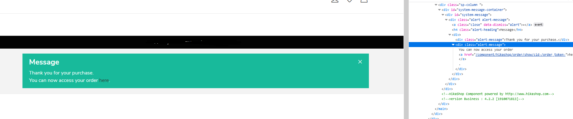

Not sure what happened but it seems that the issue is back. No order token for guest users and $this->order returns NULL if user is not logged in.
You will find build number in image attached.
