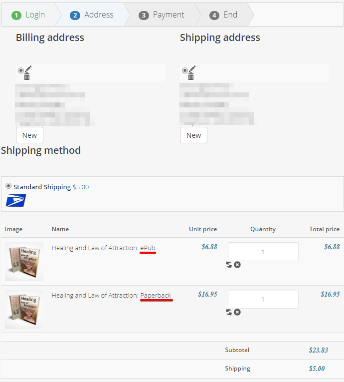

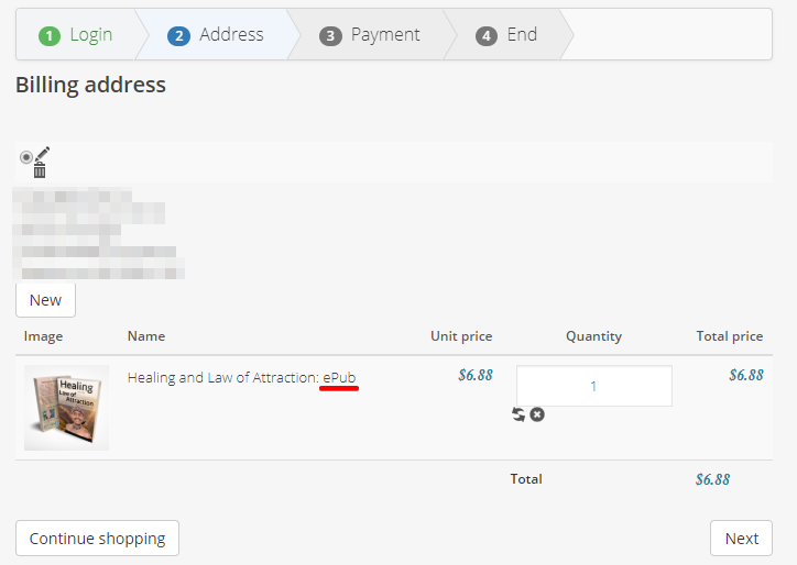

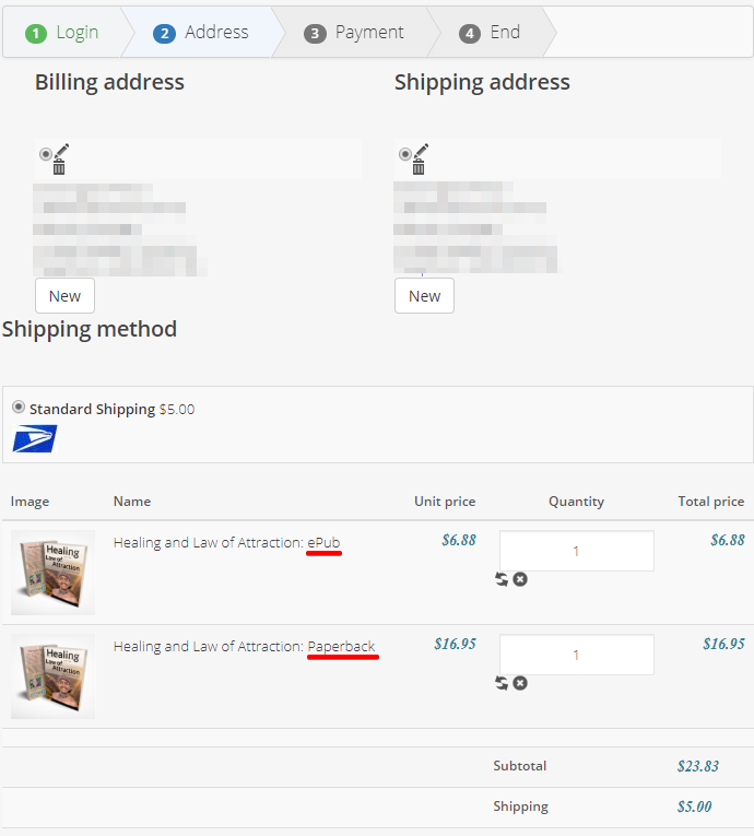

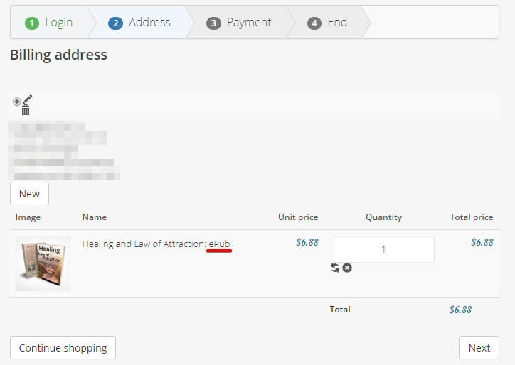

We just tested it with the "Healing and Law of Attraction" product and it worked fine (cf screenshots), can you test it again and tell us with which product your tested if you're still having your issue ? Thank you.
Kind regards,
Mohamed Thelji.
Last edit: 7 years 10 months ago by Mohamed Thelji.

It is not working fine. The problem is when you just order the ebook version. When you do that, it is asking for an address. What you have shown is ordering both an ebook and the paperback. With the paperback in the cart, it is going to ask for the shipping address. However, if you just have the ebook, it should not be asking for an address.
But when we tested it, only the billing address was displayed through the checkout workflow which is what should be done, as we need a billing address for every orders, and a shipping address only for order with weight.
