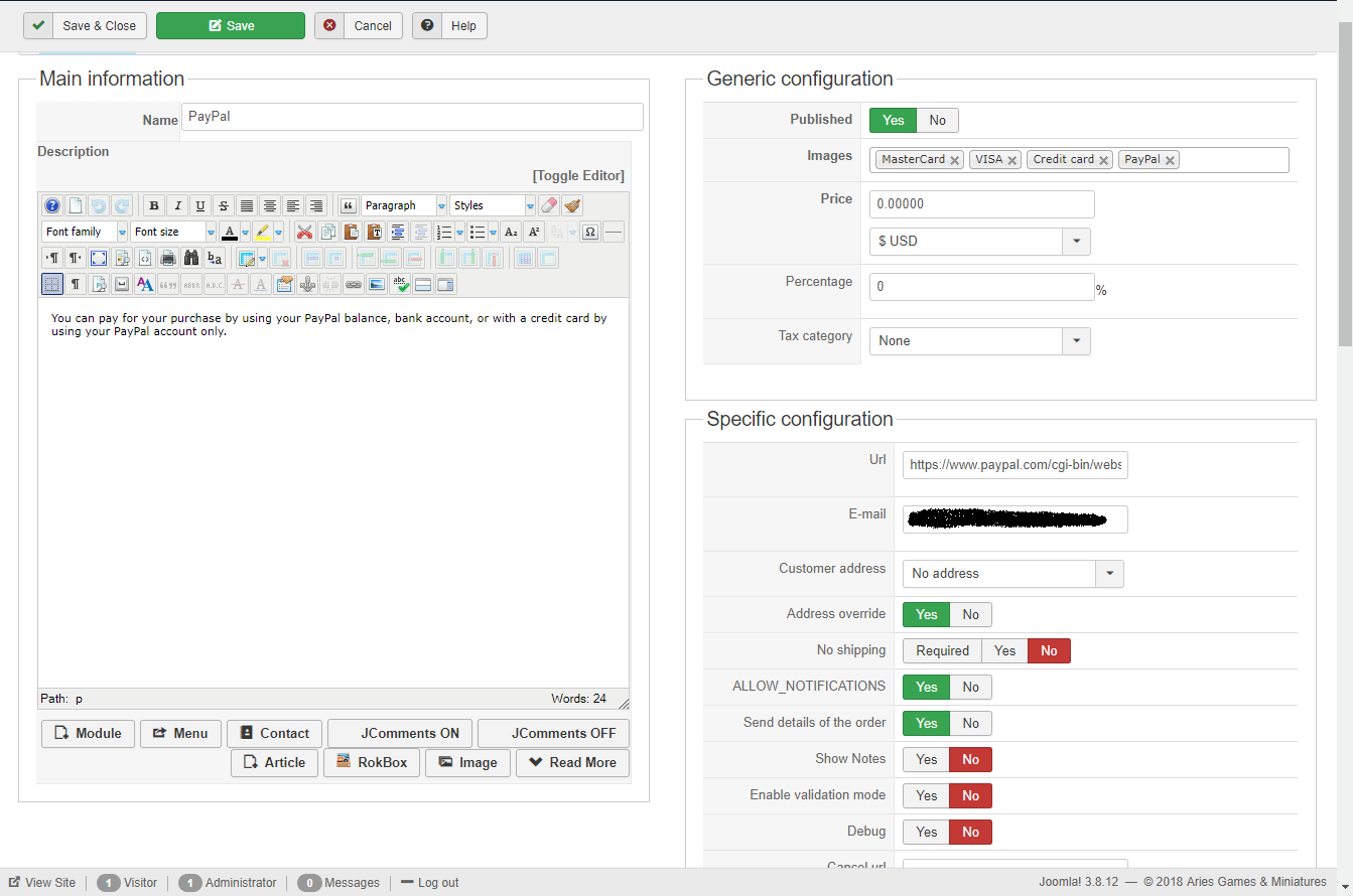

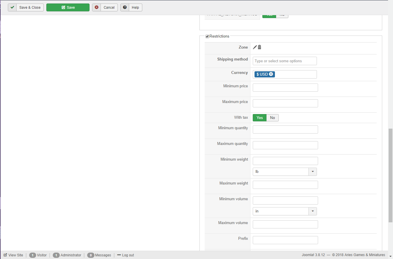

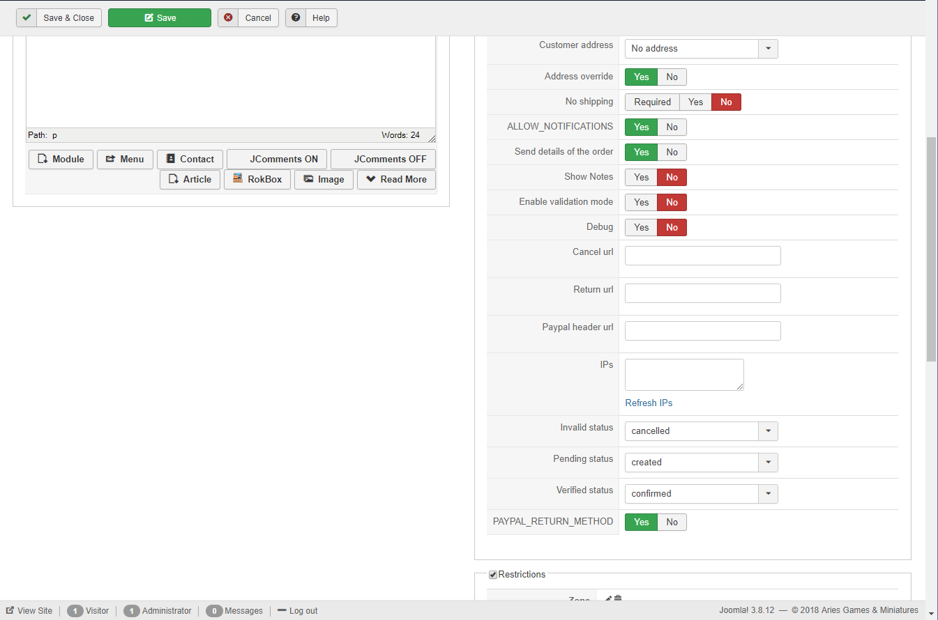

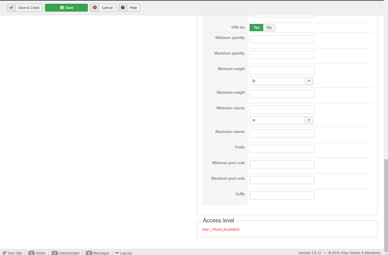

So I don't have time to check right now as I have to go into work, but can you take a quick look at the attached screen shots? I've changed nothing in the past week on my site, so my issue of a customer placing an order, and paying for an order...then not having the order automatically change to confirmed came out of nowhere. It was working fine in the morning, then somewhere in the early afternoon, it just stopped working properly.

The settings are fine.
Turn on the debug setting of the payment method so that for the next order the payment notification data will be logged in the payment log file that you can find in the HikaShop configuration.
Then, provide the data in that log file ( you can use our contact form with a link to this thread) and we can check what you have.
Also, on your PayPal merchant account, there is a section regarding the result of payment notifications. So it can be interesting to look there too.
