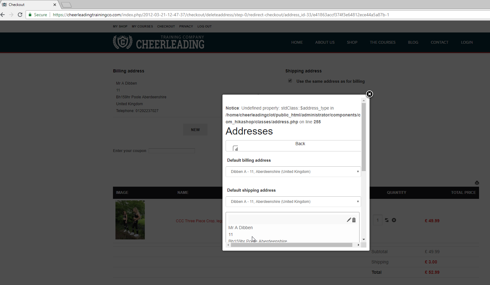

-- Error-message(debug-mod must be tuned on) -- : Notice: Undefined property: stdClass::$address_type in /home/cheerleadingclot/public_html/administrator/components/com_hikashop/classes/address.php on line 255
Addresses
Fatal error: Call to a member function display() on null in /home/cheerleadingclot/public_html/templates/gk_storefront/html/com_hikashop/address/listing.php on line 15
When a new user gets to checkout and adds an address it will produce an error after submitting. Are you able to check this for me?

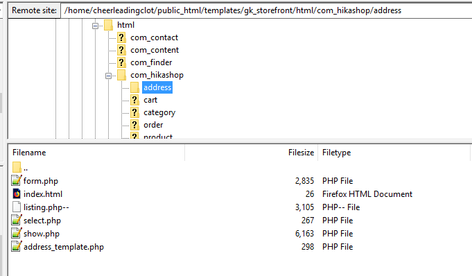

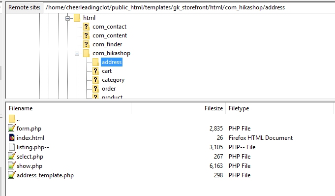

Also, the fatal error comes from your template. Rename the file /templates/gk_storefront/html/com_hikashop/address/listing.php via FTP in order to deactivate it and that should fix the problem.
  • Posts: 377
  • Thank you received: 7

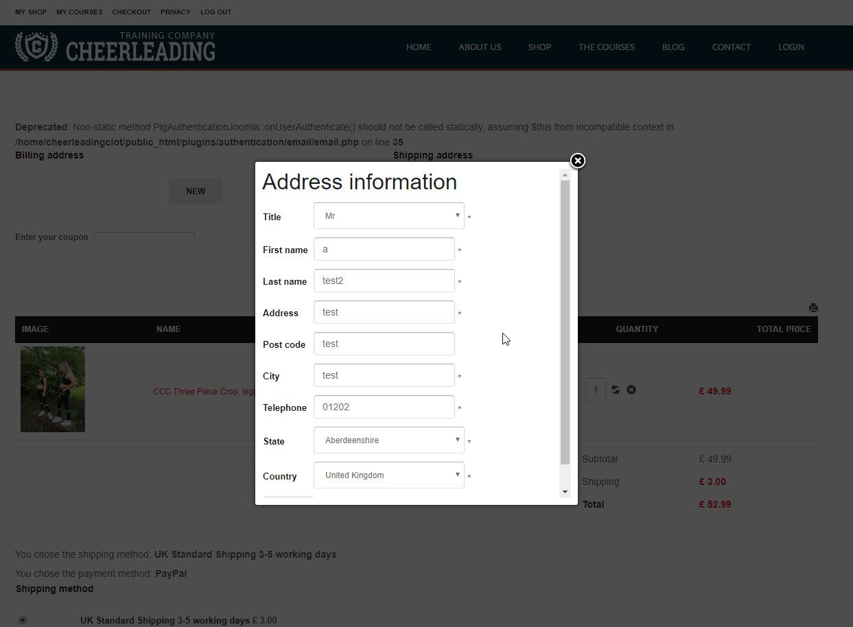

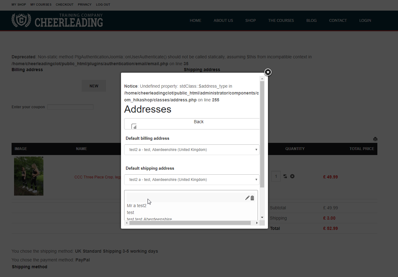

7 years 10 months ago #297898

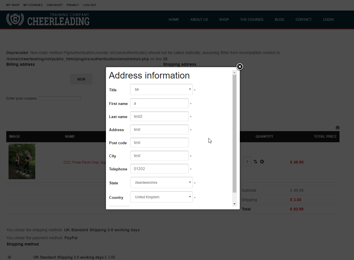

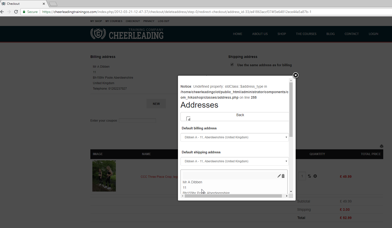

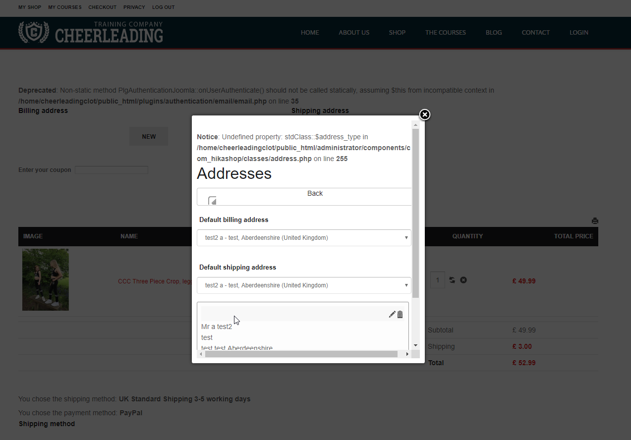

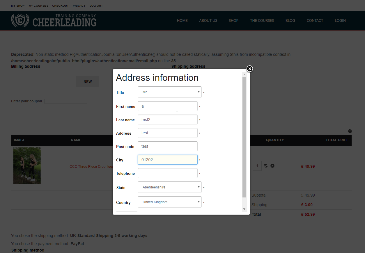

Thanks for your reply, I renamed the file, please see attached. I also installed the latest download (attached). Then go through the checkout steps as a new user and it looks like two new errors are now showing. One is below lightbox at the top and another within the lightbox. It will not save the address unless i close the lightbox then refresh the page the address will show but of course the customer will not know to do this.
