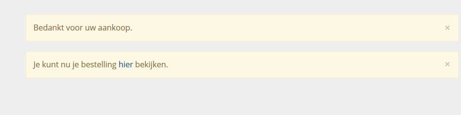

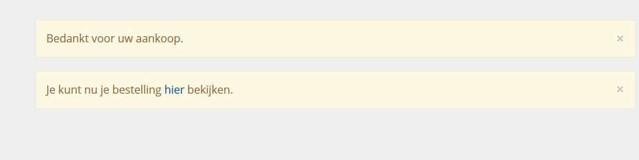

This happens when hikashop is set to "legacy checkout = yes". When we have "legacy checkout = no" we have the following problem. The text from the "after end" will show (see attachment). But will not redirect.
Also the after_end will have the option to see the order, which once you click that will goto login page. The guest user has no account, so thats a problem too. I know how to change the after_end view to not show that link. So could solve that problem.

2. The link there is working in such case for us. If the link is not working in your case and goes to a login page, this indicates that the URL there is missing the parameter order_token which allows the guest user to access his order page thanks to a secret token.
I suppose that this comes from a view override of the after_end view file in your template or if it's not a view override, you have an old version of HikaShop which doesn't have the patch with the order_token. In that case, updating would fix the problem.

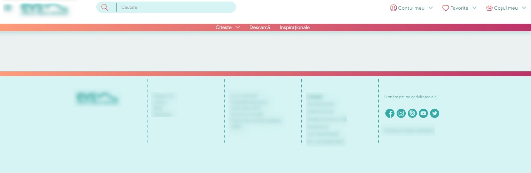

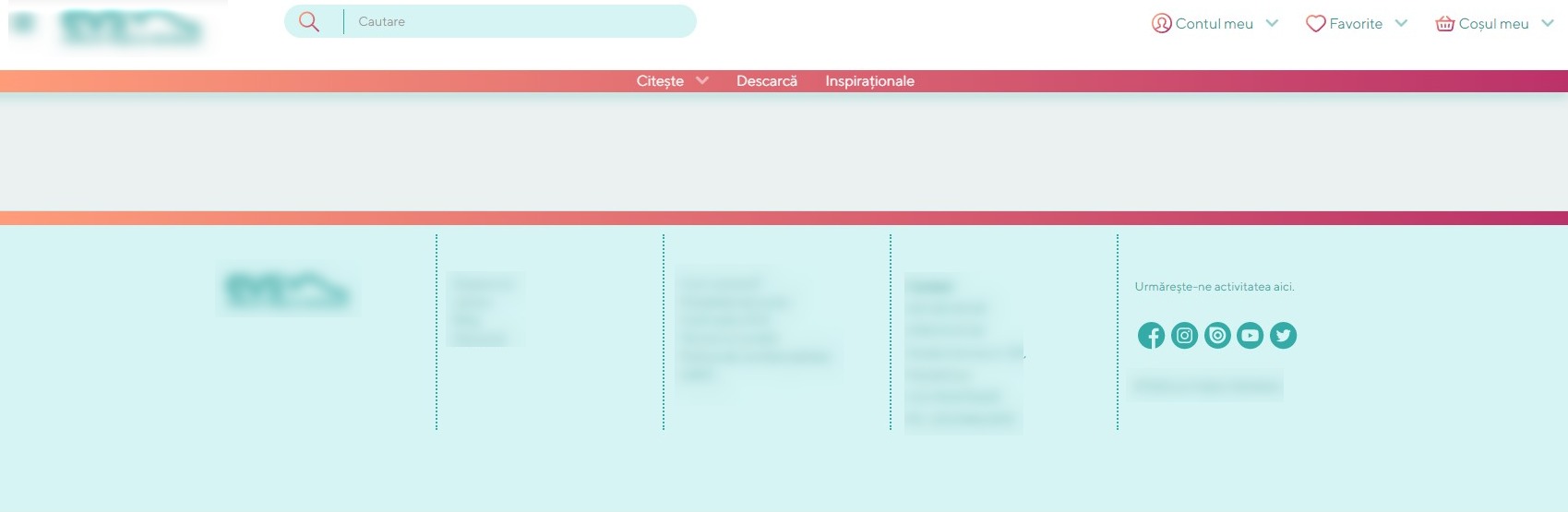

4 years 8 months ago #338234
I have this problem with hs 4.4.4, I've made the update to 4.4.5 same problem (php 7.4) .
I use a plugin made by euplatesc.ro, to process the payment.
This is the url that I get redirected after I make the payment
/index.php?option=com_hikashop&ctrl=checkout&task=after_end&order_id=246&Itemid=275
And this is what I see, a blank page:
This can be a problem from the payment plugin?
  • Posts: 86179
  • Thank you received: 14217
4 years 8 months ago #338237
It's probably coming from the template not displaying the system messages:
www.hikashop.com/support/documentation/6...issues.html#messages
If you can, try to test with the default template of Joomla, and you should see the messages on that same page, confirming that it comes from the template.
