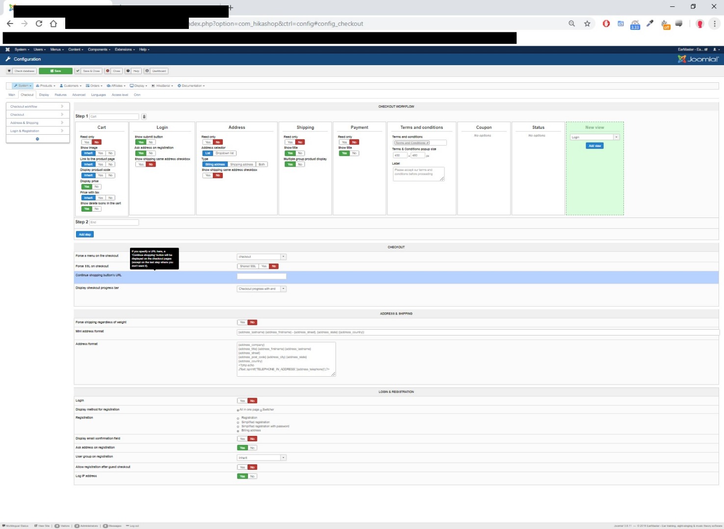

It's a shame you didn't give a link to the shop so that we could reproduce the problem, or a screenshot of the checkout tab of the HikaShop configuration so that we could see how you configured your checkout.

The reason we didn't provide a link is because we are experiencing these issues on our test server which is at the moment only accessible internally, however we can patch you through should this be required. As for the screenshots of the configuration is simply me forgetting. (Fixed now, see attached image).

Normally, you should have an error message which indicates what is the problem.
If you don't, try again after activating the default template of Joomla and activating the "error reporting" and "debug mode" of the Joomla configuration.
You should hopefully get more information that way.
Also, if you could provide a screenshot of the page before you click on the "finish" button of the checkout and a similar screenshot of the page after, that would help us understand the situation.

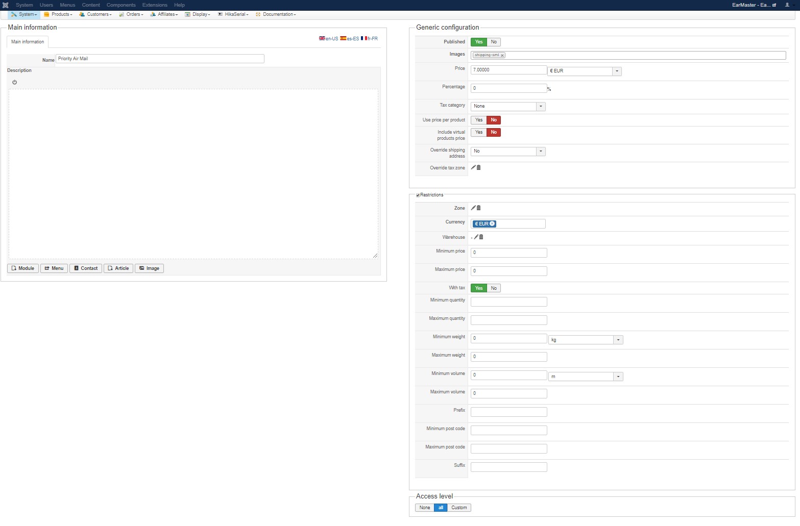

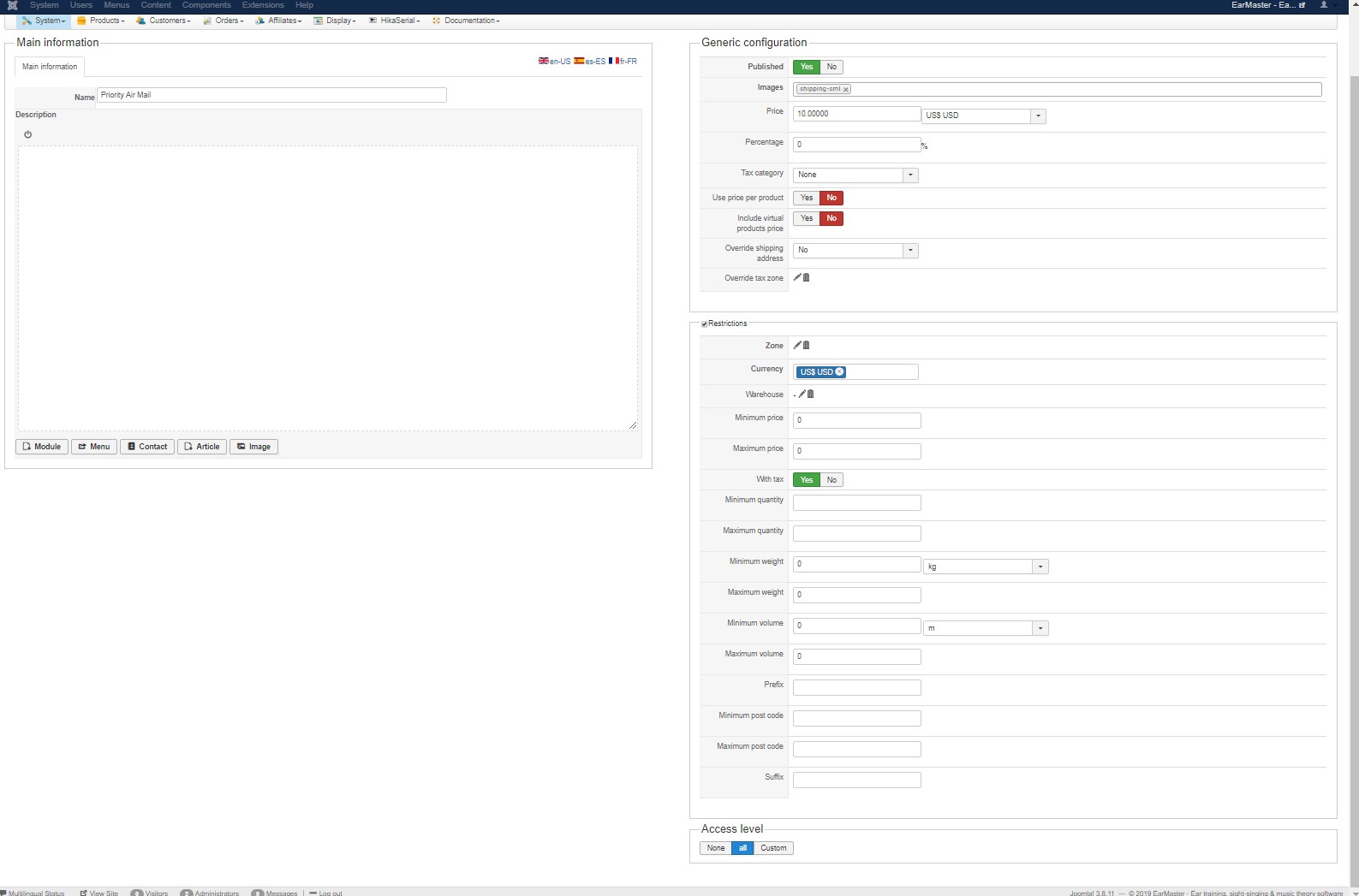

I think I've misread your message about the shipping methods config / missed that part, I've attached two screenshots of our two shipping methods and I hope that it's the correct ones.
