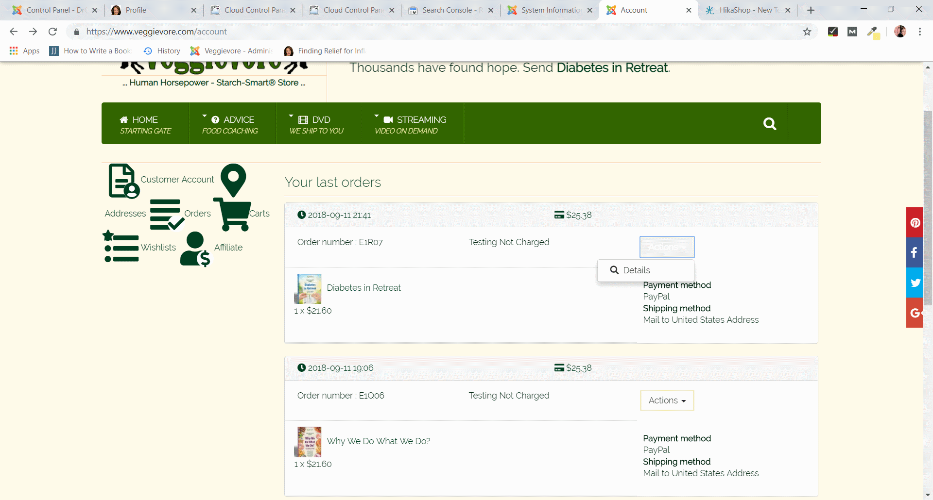

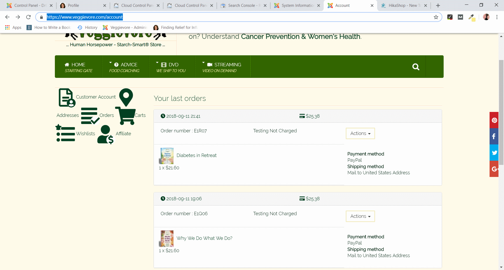

It appears that users can no longer check out and pay after the upgrade to HikaShop 4.0.0
I just had a new user create an account and add a product to her account. Then she is not sure how it is that she was not able to pay. I had her login again and go to her account page. And, once she was there she could not figure out how to checkout and pay even though she could see the order she had created.
I then logged in through the front end where I also have a test order that I created. I also was not able to find a way to pay for the order.
I can see the list of the orders and there is an actions pull down but there is no option to pay for the order. There is an option for details but the details page also has no option to pay for the order.
