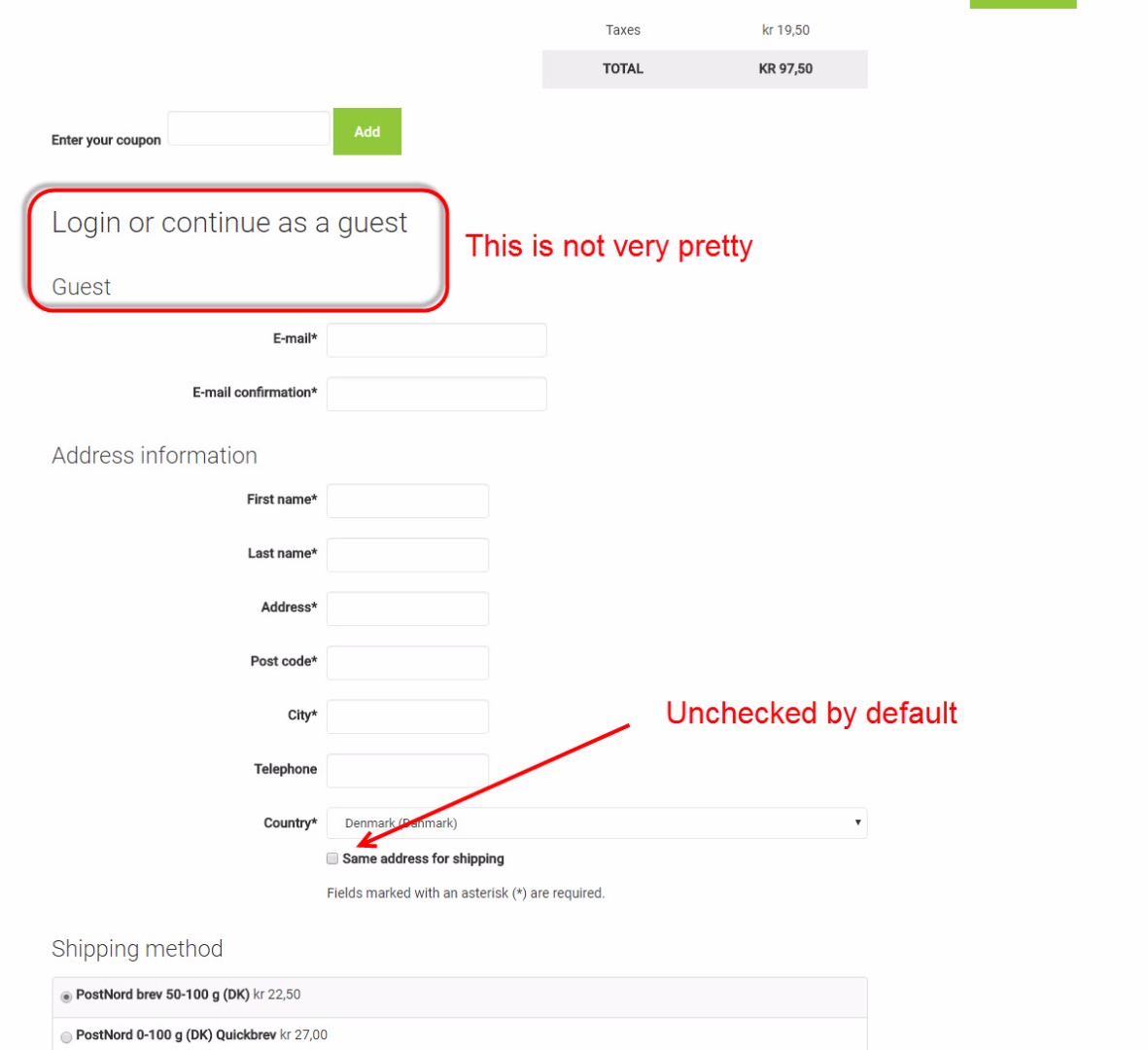

When entering the cart I see this:
If the user wants a separate shipping address, then there are no fields to use for filling this information. The checkbox is not checked, so it should be possible to fill in this extra information.
Only possibility for the user is to continue and press the finish button.

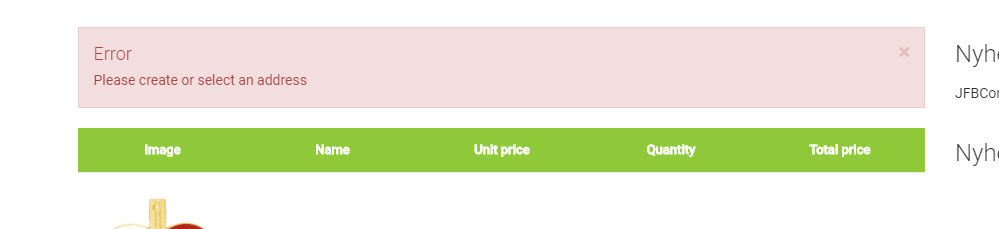

Then this error is shown:
And further down this shows:

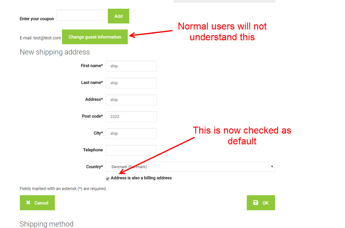

Now the box is checked and this creates now 2 billing and 1 shipping address.
This flow is not very user friendly as it is now.
I see some options:
1. The checkbox (Same address for shipping) should be checked by default on the first screen. If a user unchecks it a second addressfield appears to fill in the shipping address.
2. There are 2 address fields from the beginning and if a user checks the field (same address for shipping) then one address field should dissapear.
I like the idea that you can register on the website, but if you don't need that, then the whole guest-thing is really confusing :unsure:

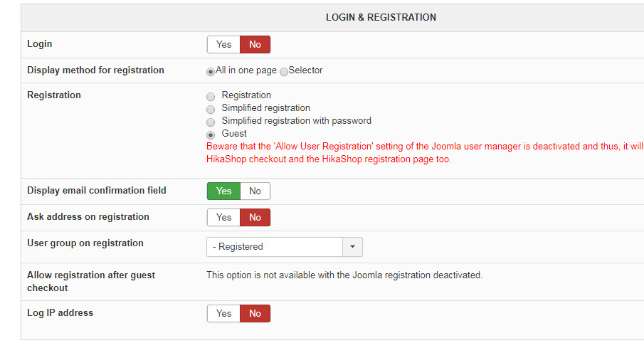

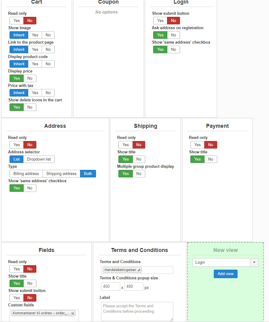

Here are some screenshots of the settings:

1. Removing the main title when the login form is not activated is a good point. I've added a change on our end for that.
