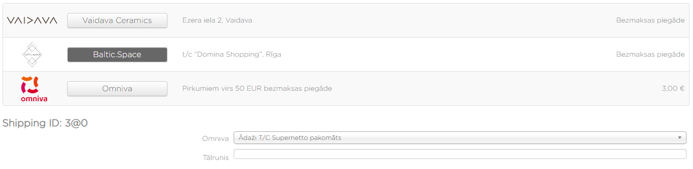

First of all I want to say that I enjoy to build web shop with Hikashop. I am creating on-page checkout and all things are going well. I need to make costumers possibility to choose one of predefined shipping addresses. I did it with custom drop-down field which is perfect. There is only one thing I cant do by myself. The problem is that I want this Drop-down option to show only for one of three shipping options.
I have done that "show_block_fields.php" view understands which shipping_id is selected but only after full browser refresh button pressed (or F5) it gives the real value.
So I need than after changing shipping method AJAX is reloading also Fields block, not only Payment and Cart blocks.
