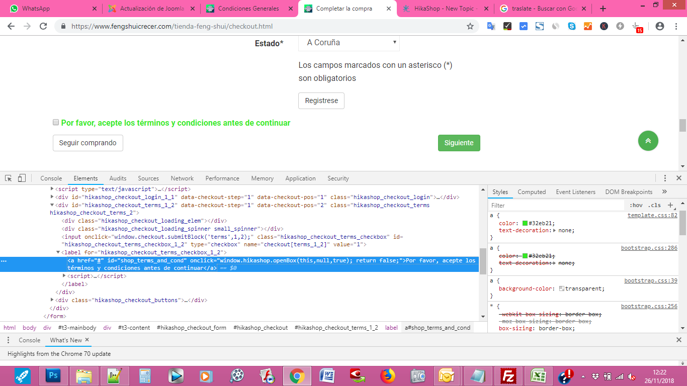

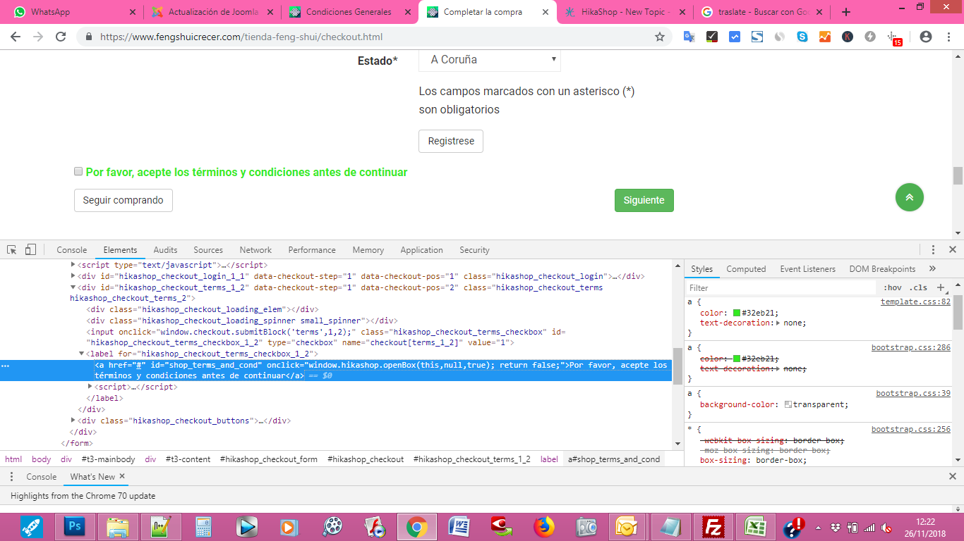

Hello the checkout button of terms and conditions to accept takes a url that is not the one of the article that I have indicated.
In this case it always takes
<a href="#" id="shop_terms_and_cond" onclick="window.hikashop.openBox(this,null,true); return false;">Por favor, acepte los términos y condiciones antes de continuar</a>
My url is www.fengshuicrecer.com/condiciones-generales.html
I want you to take my url of general conditions
you can help me?
I incorporate image from the web

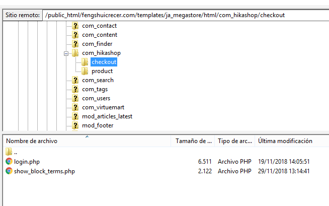

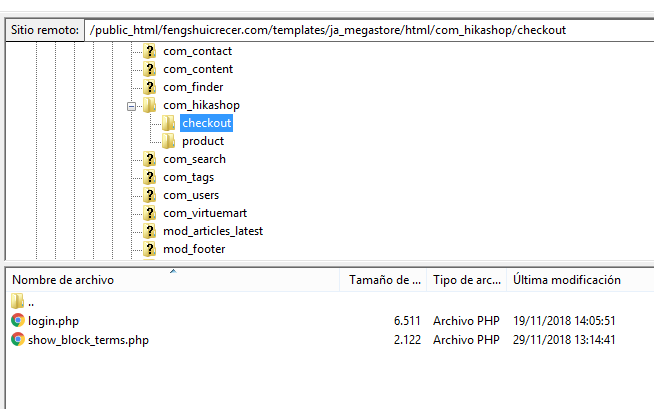

  • Posts: 9
7 years 9 months ago #301059
Hello
That file did not exist
I have included the file copying from the component, it does not work either
I think I did it well, attached screen
  • Posts: 86216
  • Thank you received: 14222
7 years 9 months ago #301060

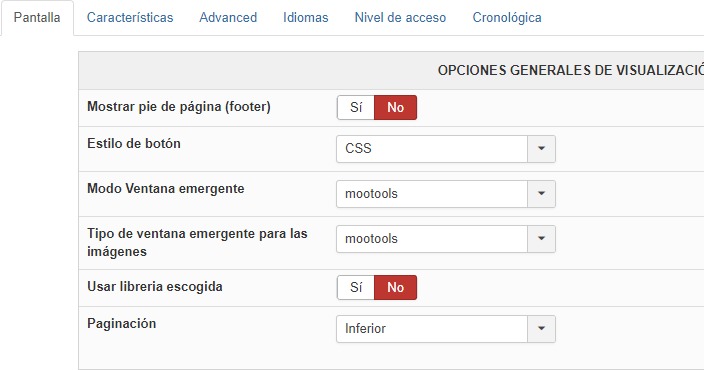

Ok, then please check that the setting "popup mode" is set to "vex" in the HikaShop configuration.
That should fix the problem.

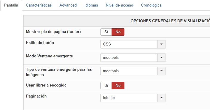

  • Posts: 9
7 years 9 months ago #301098
perfect, I changed this configuration and it works. I attach the image in case it helps someone
Thanks for your help, happy day
