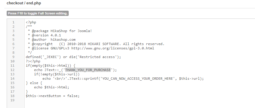

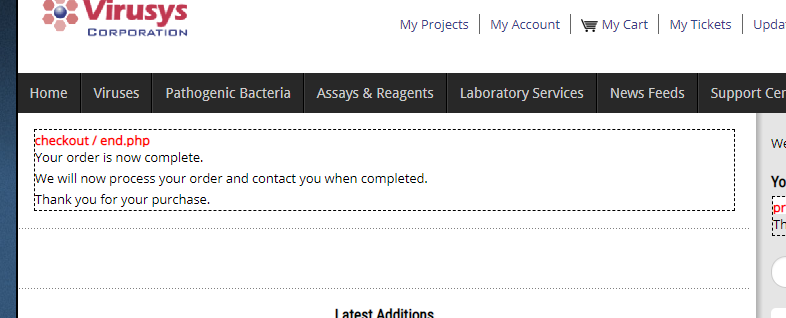

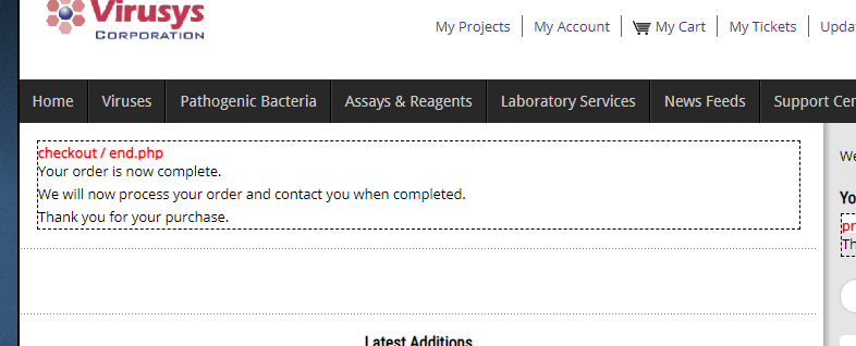

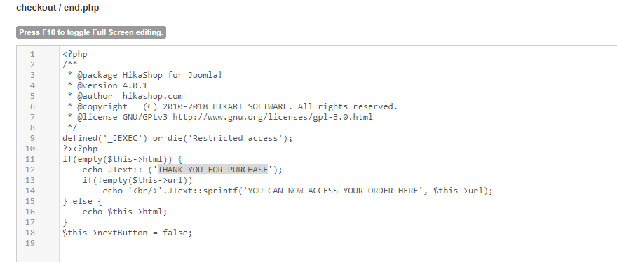

I'm trying to understand how to modify checkout/end.php.
The THANK_YOU_FOR_PURCHASE can be found in the language hikashop.ini and can be seen below on the last of three lines.
Where is the rest of it coming from??

Since $this->html is not empty, it's not that THANK_YOU_FOR_PURCHASE which you see there.
The THANK_YOU_FOR_PURCHASE you see comes from the plugins/hikashoppayment/XXX/XXX_end.php file of your payment plugin where XXX is the folder name of your payment plugin.
