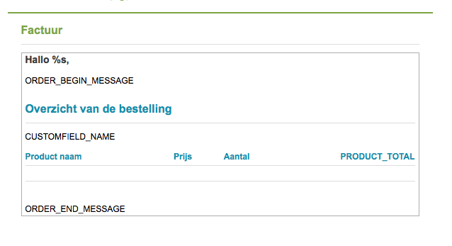

I am also experiencing another issue after the backup: I saw that there is an option now to override the notification emails per order status. I have customized these notification email before but since the update it seems to break things (things like 'username' are not retrieved and the items the client ordered are not shown correctly). This happens after even a very small change to the email notification.

Also, what do you mean by "the items the client ordered are not shown correctly" ? It looks like you imply that they display, but there some glitch on the way they display ? How so ? Could you maybe do a screenshot ?

2. I can customise the email template, it will work. but whenever I use the 'per status override' the things like {TXT:HI_CUSTOMER} will result in 'Hello %s' instead of 'Hello John'. I've added a screenshot. The ordered item is also missing, if I don't use the 'per status override' the ordered item will show up correctly.

Is that screenshot from your email inbox ? Or from the "preview" button of the email edition interface ? Or something else ?
