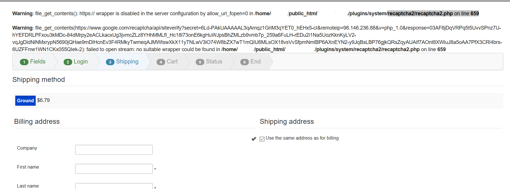

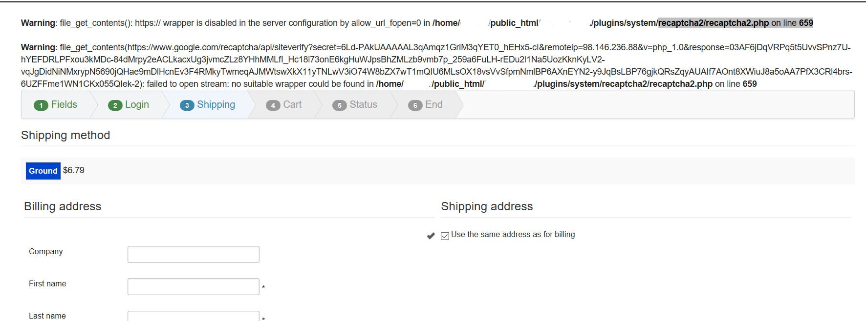

I had setup recaptcha2 successfully and it seemed to be working great. However, all of a sudden I get the following message?
Warning: file_get_contents(): https:// wrapper is disabled in the server configuration by allow_url_fopen=0 in /home/citysur/public_html/iadecor.com/plugins/system/recaptcha2/recaptcha2.php on line 659
Warning: file_get_contents( www.google.com/recaptcha/api/siteverify?...FFme1WN1CKx055QIek-2 ): failed to open stream: no suitable wrapper could be found in /home/citysur/public_html/iadecor.com/plugins/system/recaptcha2/recaptcha2.php on line 659
Your help is appreciated
Charles
  • Posts: 301
  • Thank you received: 6
7 years 7 months ago #303805
Fixed by host:
It appears that "allow_url_fopen" was not enabled for this domain. We have enabled these options at this time through cPanel using MultiPHP INI Editor. We confirmed this setting has been applied by navigating to the phpinfo page that was already located in this directory.
