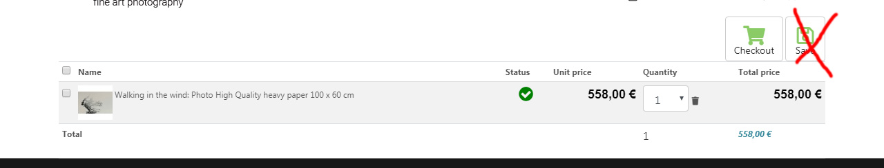

Hi there
I' d like to ask you how to remove - hide the save button for tool bar?
I have attached a screenshot to help you , what i need

7 years 7 months ago #303886
You would have to edit the file "show" of the view "cart" via the menu Display>Views and add such line at the top:
<?php unset($this->toolbar['save']); ?>
Note however that if you remove that button, then when the customer changes the quantity he will have no way to apply the change.
