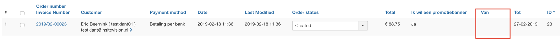

During checkout there must be a choice for promotional material. So I configured a radio (table order) for no (standard, value 0) or yes (value 1). Based on this choice 2 (advanced) datepickers (also in table order) appear (from which date and till which date). De first datepicker should only allow future days, the second datepicker should only allow dates starting datepicker 1 till 7 days later.
I'm no coder but, with Jquery, I have the datepickers working. There is only 1 problem: The first datepickers input is not saved to the database. When choosing Hikashop -> Orders the Radio and datepicker colluns are visible but the first datepicker shows blank, even if a date is entered during checkout.

Any idea why the input from the first datepicker is not saved (see attached image where the "Van" value is not visible)?
When I remove the above code all values are saved including the first datepicker. So something in the code prevents the first datapicker from saving but I have no clue (due to too little coding knowledge).

From what I can see, the problem is that the hidden input field generated by the calendar is not being updated when something is selected in the calendar of the "van" custom field.
From what I understand, this is because you override the "select" function of the datepicker for that van custom field with the code:
onSelect: function() {
        var begin = $(this).datepicker('getDate');
        var eind = $(this).datepicker('getDate');
        eind.setDate(eind.getDate() + 7);
        begin.setDate(begin.getDate() + 2);
        $('#promotiebanner_tot_input').datepicker('option', 'minDate', begin);
        $('#promotiebanner_tot_input').datepicker('option', 'maxDate', eind);
But you don't update the hidden input in that function. Apparently you'd have to do that yourself if you override that select function.
So, you'll want to also do something like that in there:
$('#promotiebanner_van').value = $(this).datepicker('getDate');
Now please understand that this is something way out of normal HikaShop user support. If you need help with custom javascript development, I would recommend to seek help on stackoverflow, like I do when I'm working on development projects and need help with code.
