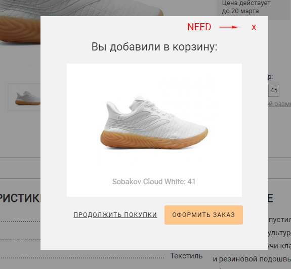

Hi! Please tell me how to add a pop-up button to Close the window VEX

Thank you! That's right, I'm using the vex dialog on frontend, and the default setting is showCloseButton of vex set to 0. Please tell me how to initiate it to 1?

The pop-up window is called by the plugin "HikaShop Card notification Plugin" method popup, by clicking on the " Buy " button in the product card

Then try adding the code:
vex.defaultOptions.showCloseButton = 1;
after the code:
vex.defaultOptions.className = "vex-theme-default";
in the file plugins/hikashop/cartnotify/cartnotify.php

Thanks Nikolas! I understand the principle and read the documentation github.com/HubSpot/vex/blob/29b137d92b18...ex.dialog.coffee#L42 found that correctly you need to specify with DIALOG
vex.dialog.defaultOptions.showCloseButton = 1;
it work!
