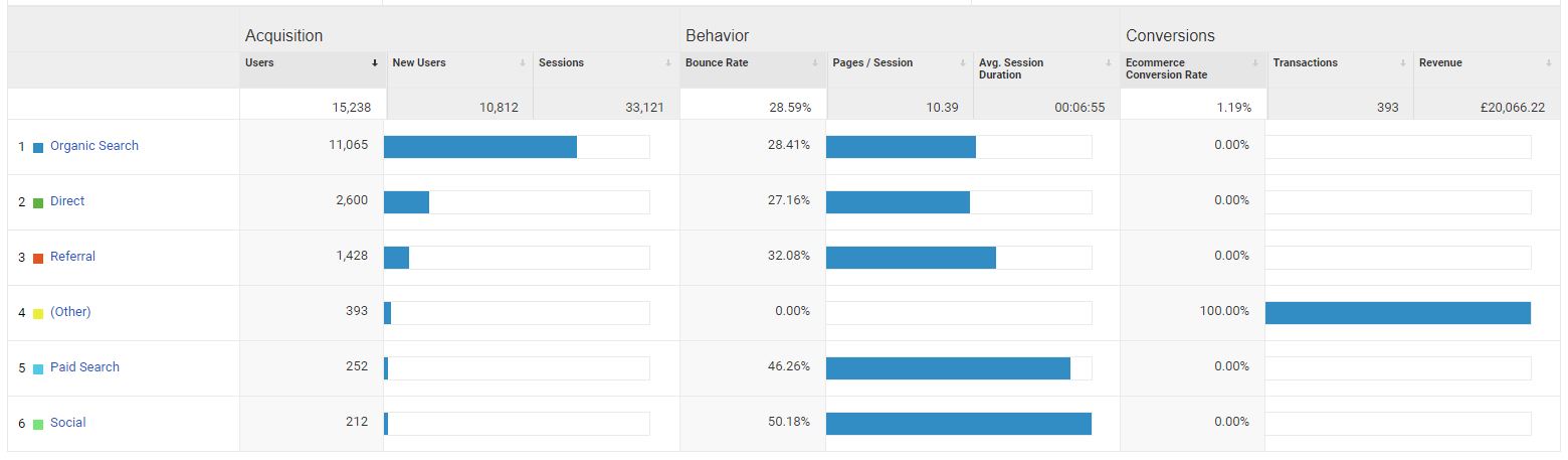

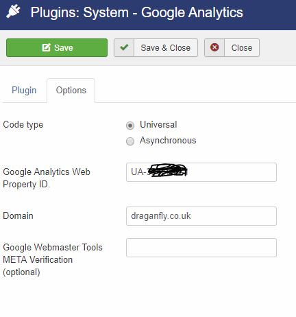

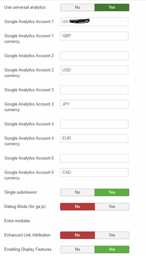

I just wanted to check that I have Hikashop correctly set up to be sending ecommerce data over to Google Analytics.
- Please find attached a screen shot of how the current Hikashop plugins are set up. I've also attached a screen shot of what our acquisition overview looks like, the only traffic that's being registered is (other). When looking at the source/medium, we only seem to be registering (not set) / (not set).
Any advice would be most appreciated.

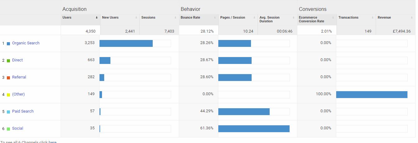

I've left the GA account for a short while after updating to Hikashop 4.0.3, I've attached a screen shot of what the Acquisition overview currently looks like, I've set the time period from the 09/03/19 to the 09/04/19. I think we may still be having problems with order being placed through the 4.0.3 version?
- I've taken a look at phpmyadmin and the order_payment_params are currently all blank.
