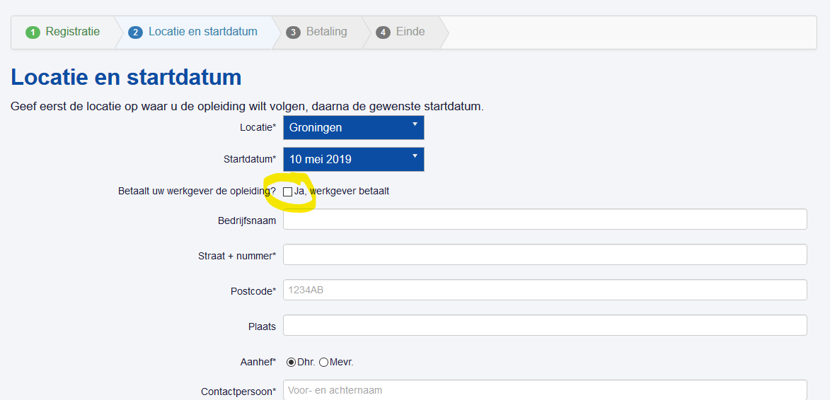

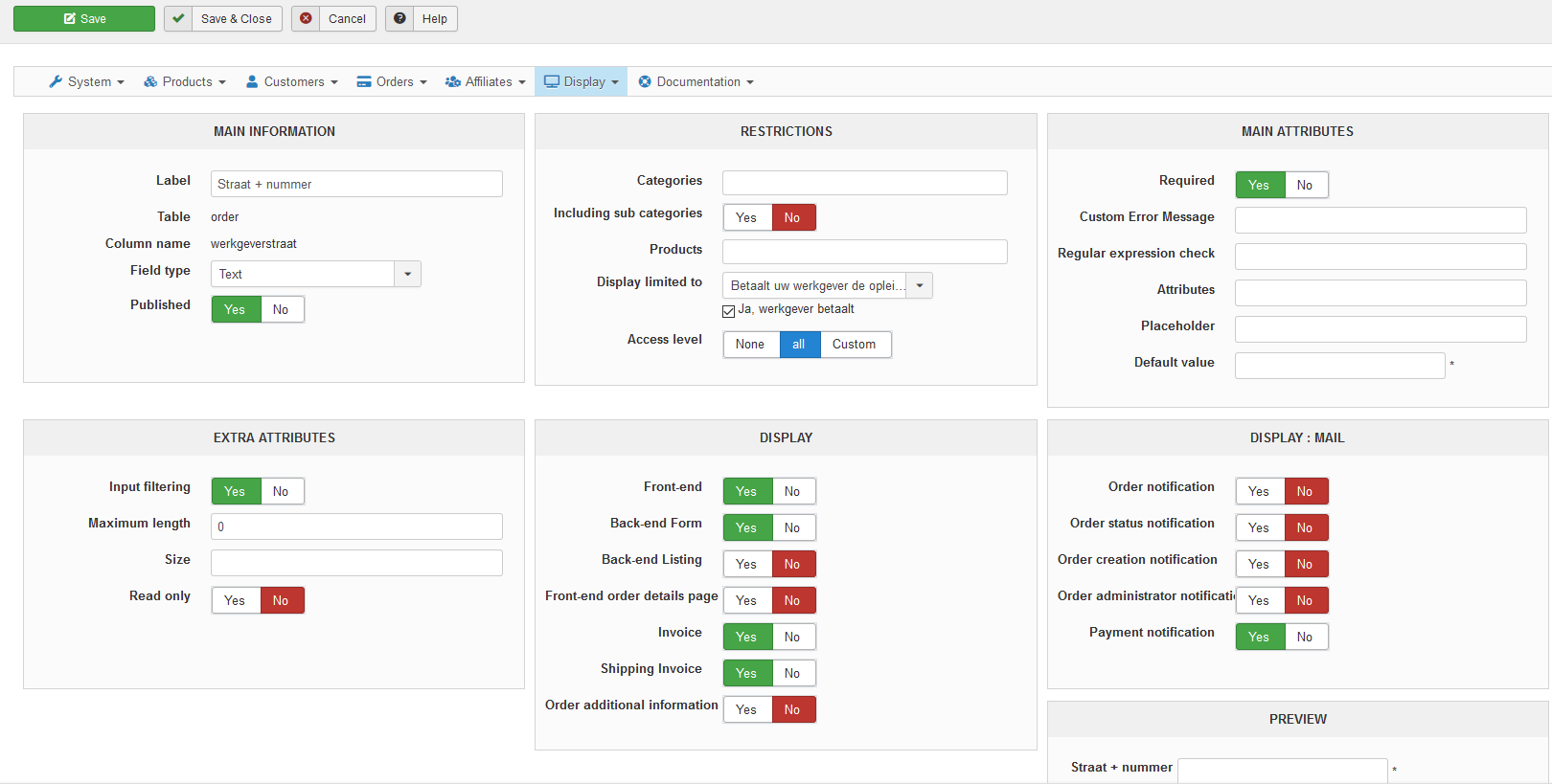

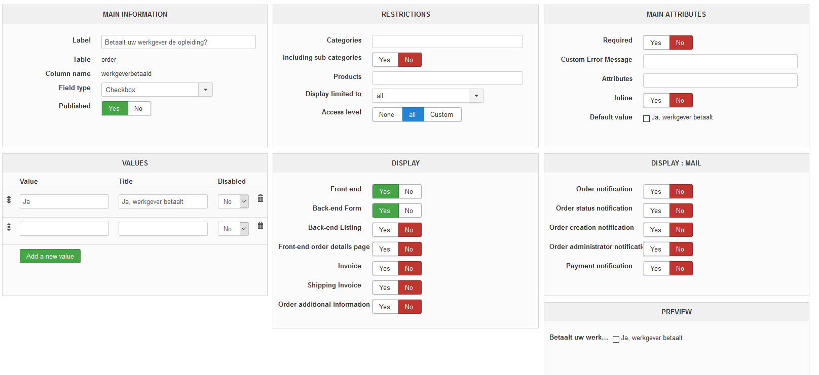

I have some custom fields in the order-table with restrictions "display limited to" a checkbox-value. When checked, the extra custom fields should show up, when unchecked the fields should be hidden. At least that is wat I expected.
Unfortunately the restricted fields are only hidden at pageload. When checked, the fields show up, but on uncheck the fields stay visible.

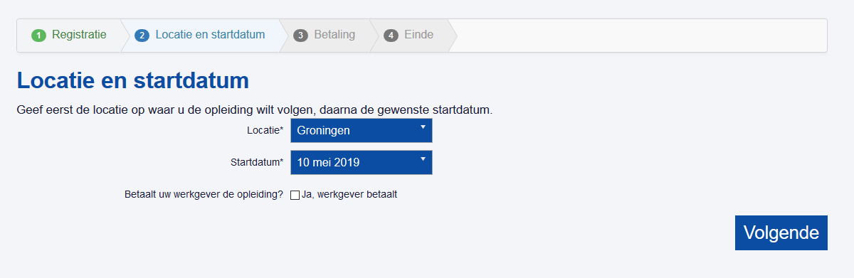

7 years 3 months ago #307042
hi,
Sorry for not giving you all the information in the first place. Here are the screenschots you asked for.
  • The problem occurs during the checkout process[/l]

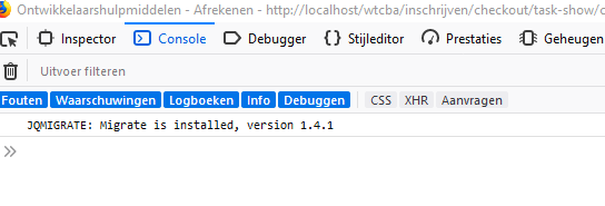

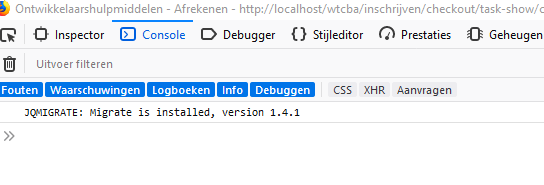

  • There is no javascript-error in the console during the checkout process
You can reproduce the issue via the following URL;
On this website search for "export" as an example, click on the blue "meer info" buttton that is behind a product, and then click on the green "inschrijven" button to put it in the shopping-basket.
I created a login for you:
After login click "volgende", then you find the page like the screenshot with the "ja, werkgever betaald" checkbox custom field.
Hope this is enough information for you to find out about this problem.
No javascript-error:

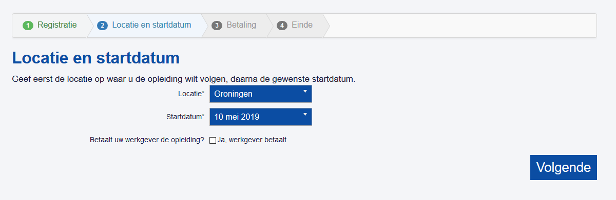

front-end checkout first page:

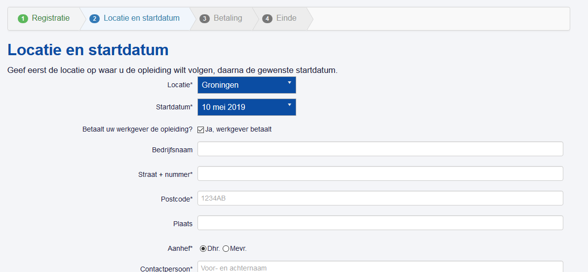

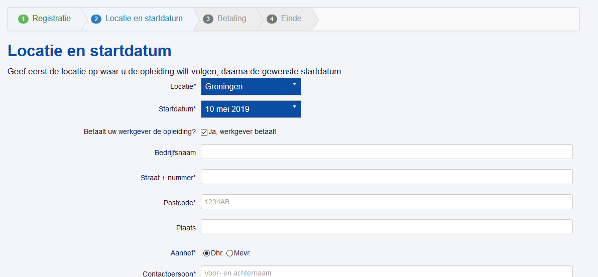

after clicking on the checkbox:

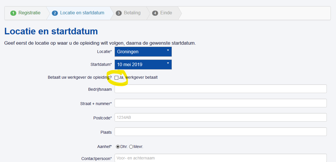

after clicking againg: other fields stay visible:

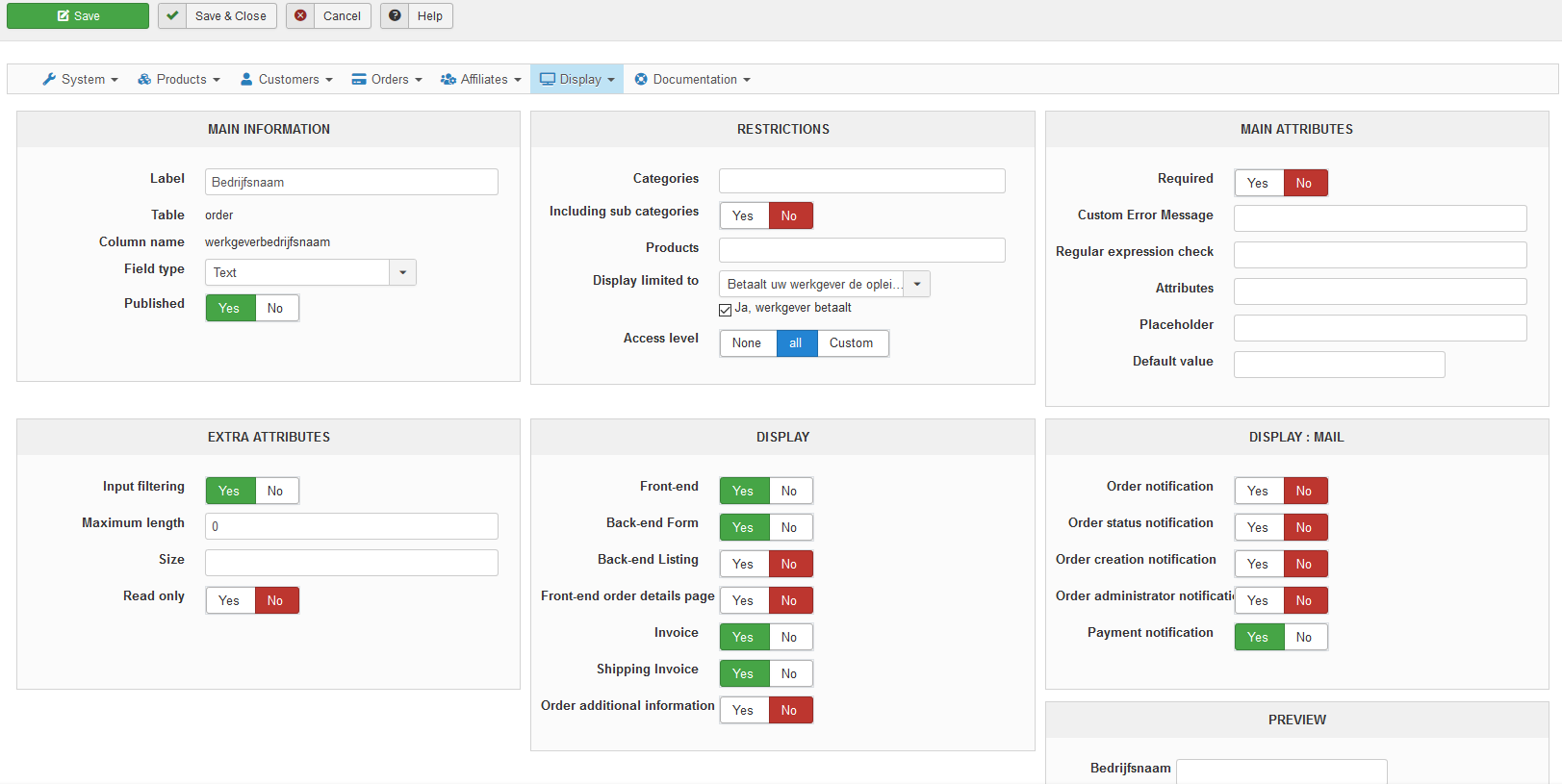

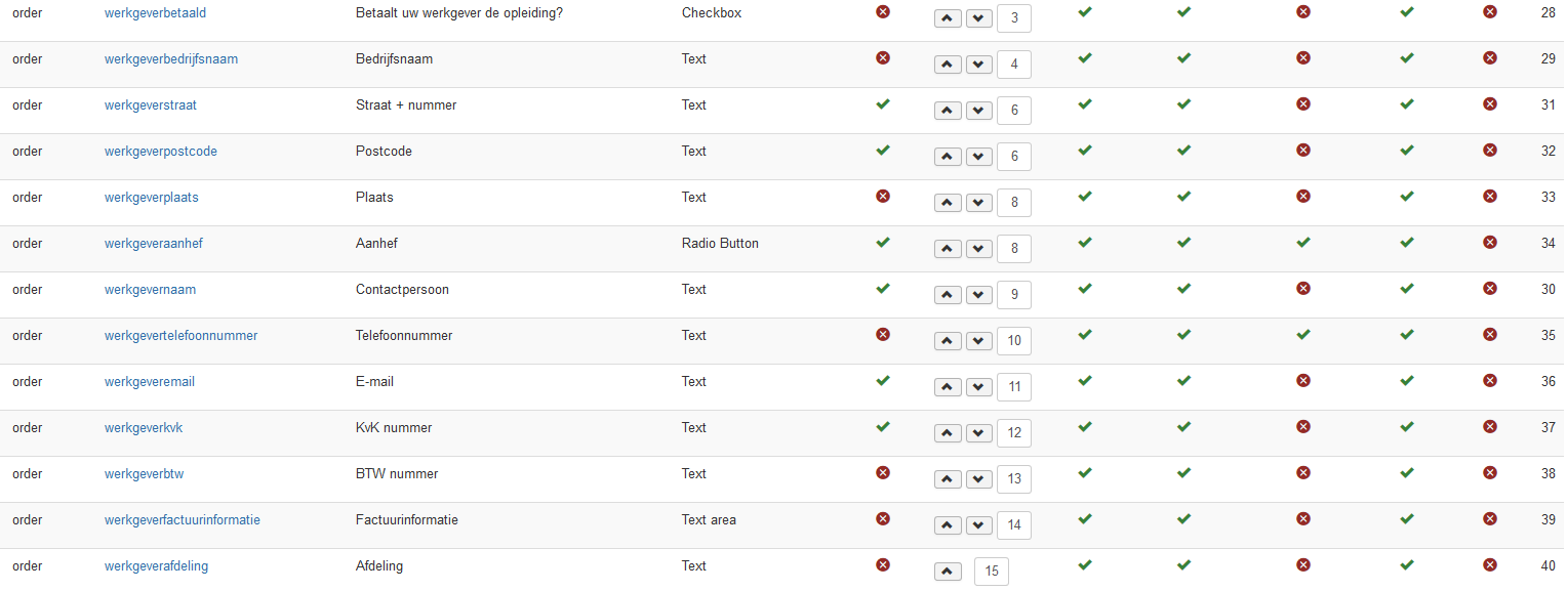

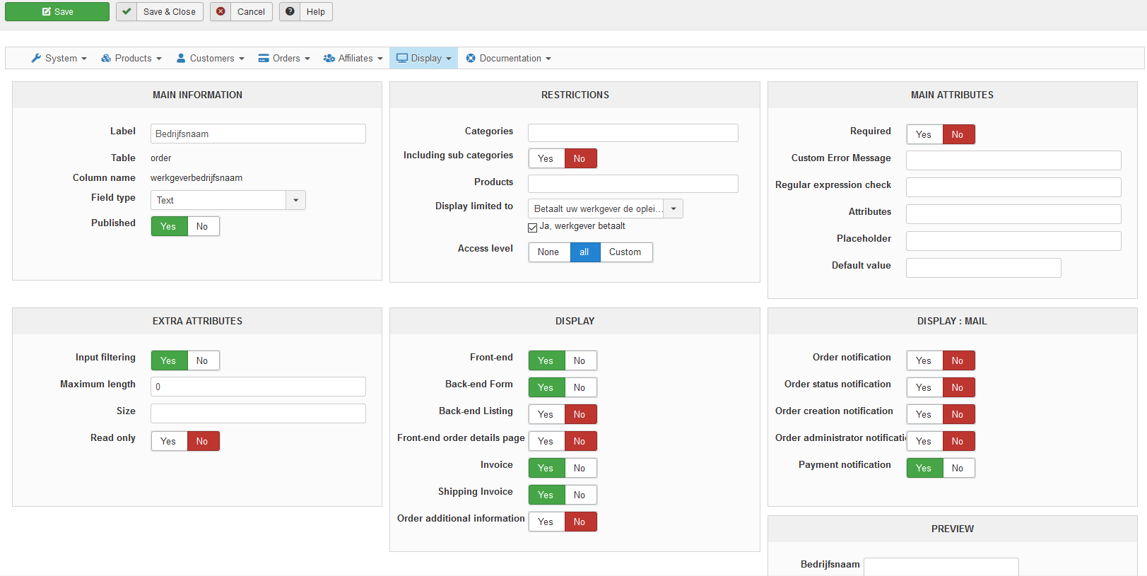

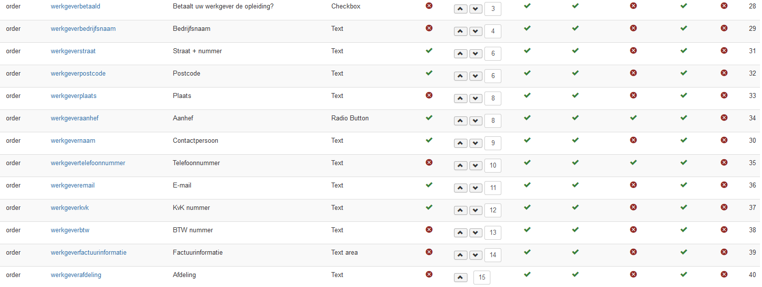

All fields that should hide:

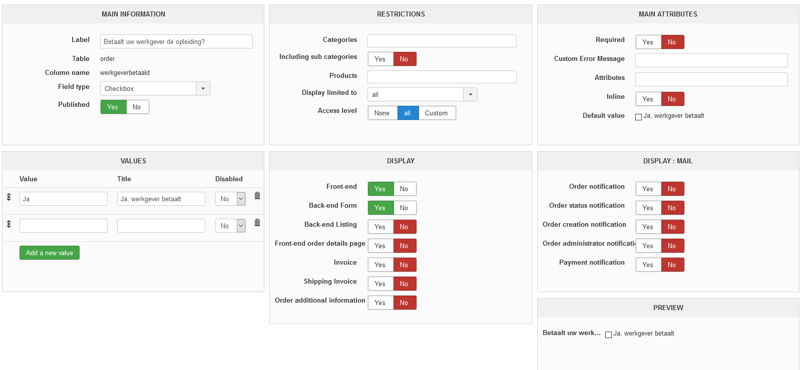

Custom field checkbox:

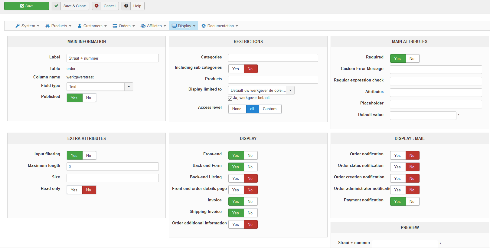

Two examples of custom fields restricted
  • Posts: 86216
  • Thank you received: 14222
7 years 3 months ago #307098
Thank you for all this. It was really helpful. I was able to reproduce the issue on my local test website and add some patches to fix the issue.
