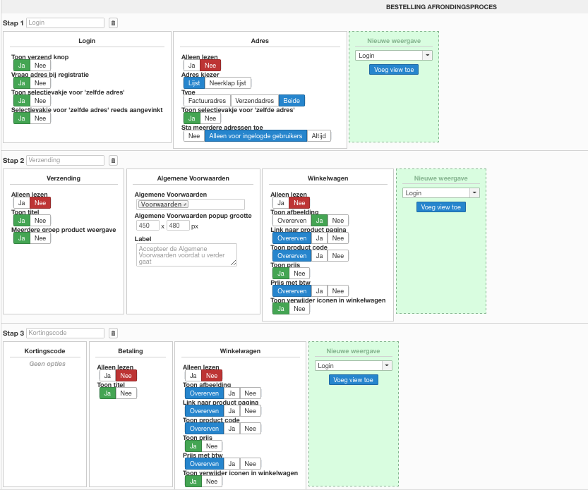

Hi, I have the same issue. In checkout there is no redirect to Paypal nor Ideal. But after selecting the shipping, and the payment options, the enduser is shown the " end & confirmation"
The default order status is set on "created"
Also, no order is created and no confirmation is sent by email.
attached you see my checkout schedule
I use Joomla versie, 3.9.10.
Hikashop essentials 4.1.0
any help is welcome!

  • Posts: 85952
  • Thank you received: 14142
6 years 11 months ago #309553
Update to HikaShop 4.2.1 and it should work fine.
It is a know issue of some builds of HikaShop 4.1.0 in some cases (it depends on how your checkout is configured, how your menu items are configured).
