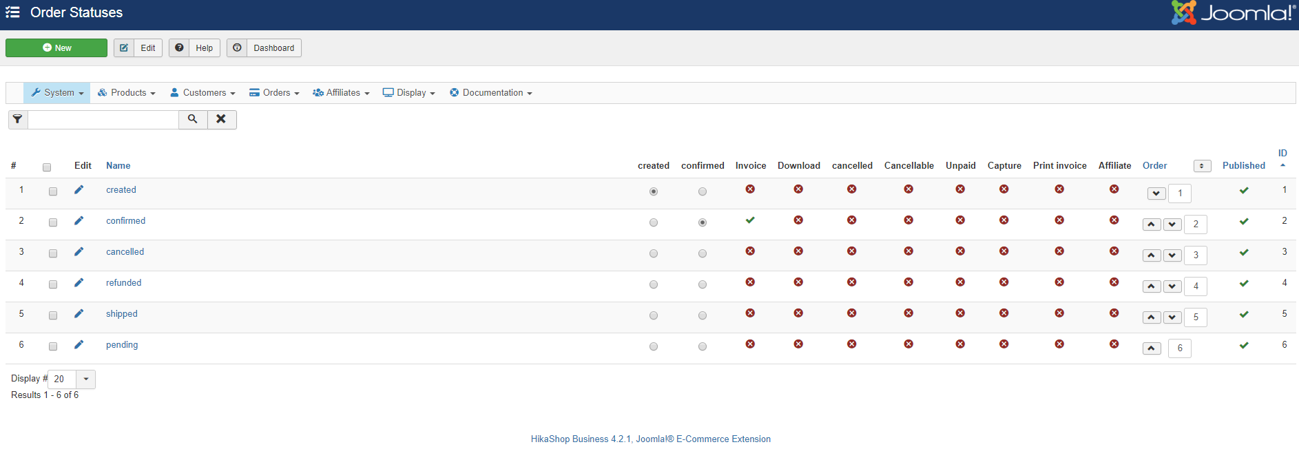

I have 2 attachements:
- the email settings
- the order status

7 years 2 months ago #310840 by nicolas
The order status notification is sent when:
- the order status is being changed
- a "send notification" flag is activated
This "send notification" flag is activated either:
- when you manually change the status of an order in the backend and activate the "send notification to customer" checkbox
- when a payment plugin changes the status of an order and set that flag.
So basically, if it's not because you've changed the status manually with the notification checkbox checked, but it happened automatically during a payment notification to the payment plugin which changed the status of the order automatically, the issue comes from the payment plugin you're using.
Which payment plugin are you using ? I've never heard such issue with the payment plugins we developed ourselves so if it's a third party developer, I'm afraid you'll have to contact them for further help on that issue.

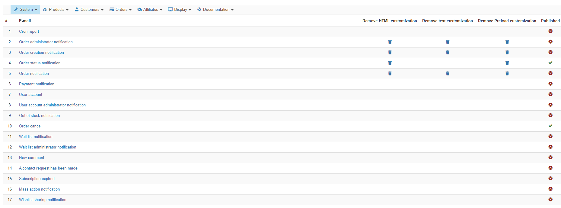

7 years 2 months ago #310931 by Mohamed Thelji
Hello Robert,
Is it possible not to send the mail if the order is canceled?
If that is not an option: it is possible to change the subject of the mail with your own text. Is it also possible to adjust the text of the mail if an order has been canceled?
Sure,
You'll be able to do both via "Hikahsop->System->Emails" by managing emails sent to your customers.
We wish you a nice day!
Kind regards,
Mohamed.
7 years 2 months ago #310953 by jivesand
Hi Mohamed,
That's now working right now. We are using 'Order status notification' and it can return both mails. The mail when a payment is succesful is sent. But also the mail is sent when a payment is cancelled.
The problem is that this is the same mail. So it looks like the customer made a succesful order while he cancelled the order. In that case he doesn't need to receive the mail.
Greets, Robert
