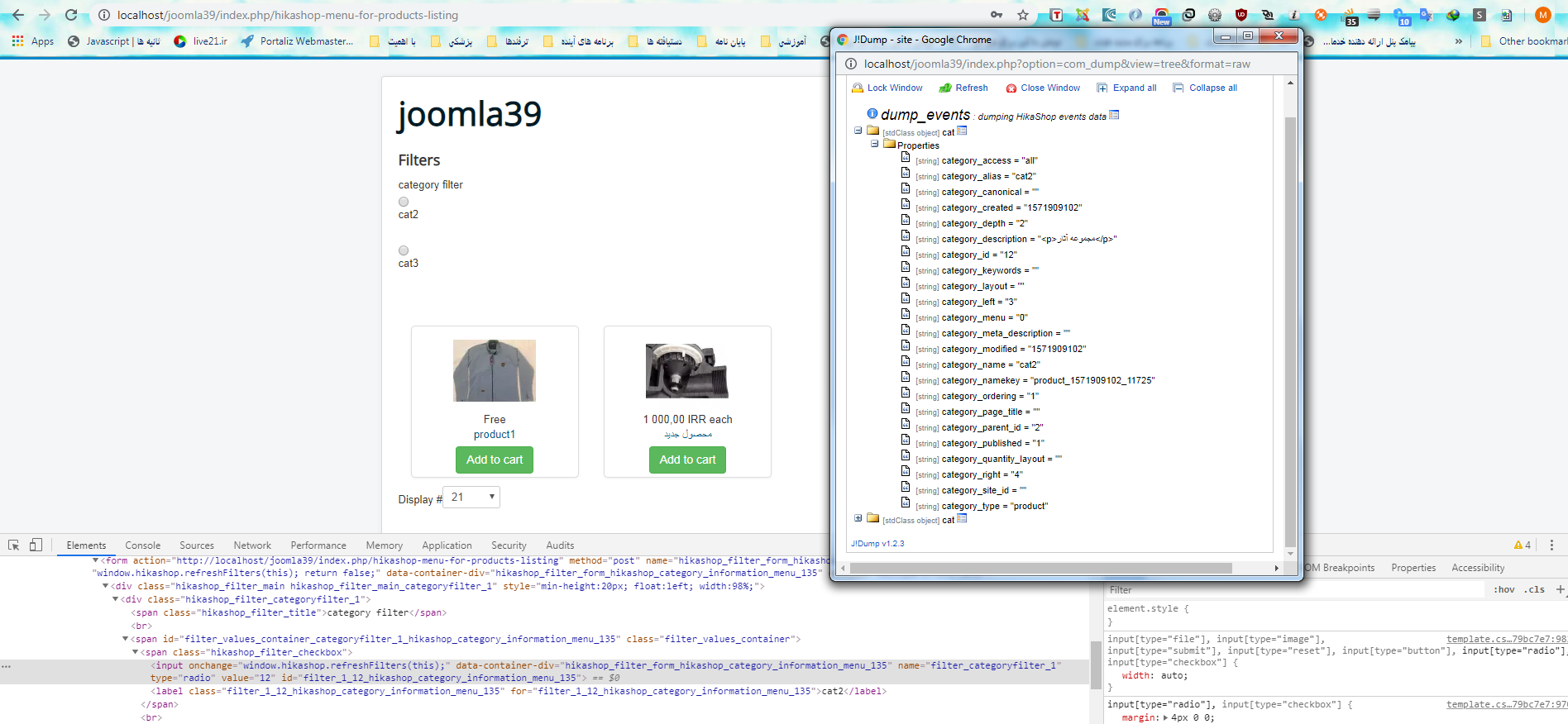

i find back/classes/filter.php line 1783 and get this picture after dump $html:
but i can't see image in the cat object.what is php function to get image of category? also i hack the core. can you give me simple example to how use onFilterDisplay to change any thing in filter category name.
also i check this demo page:https://demo.hikashop.com/index.php/en/other-features/products-with-serial-number
but my questions is still without response.(if it need to modify View please say what of that?)

3. To have the products listing refresh below a category listing without changing the page, I also think that the solution is to use a category filter.
And indeed, there is no option to display the image of the category in the filter.
Modifying classes/filter.php will be the easiest.
To get the image of the category, you'll have to use such code:
$db = JFactory::getDBO();
$db->setQuery('SELECT * FROM #__hikashop_file WHERE file_ref_id = '.(int) $category_id .' AND file_type=\'category\'');
$image = $db->loadObject();
$config = hikashop_config();
$image_options = array('default' => true,'forcesize'=>$config->get('image_force_size',true),'scale'=>$config->get('image_scale_mode','inside'));
$imageHelper = hikashop_get('helper.image');
$img = $imageHelper->getThumbnail(@$image->file_path, array('width' => 100, 'height' => 100), $image_options);
echo '<img src="'.$img->url.'"/>';
It's going to be difficult to do that elsewhere than directly in classes/filter.php
What you could do is actually override the whole classes/filter.php with a system plugin:
www.hikashop.com/forum/checkout/878018-c...asses-field-php.html
www.hikashop.com/forum/development/88665...le-in-hikkashop.html
