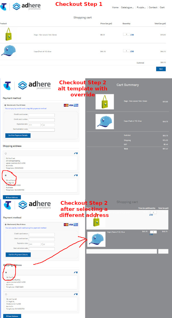

Hi Guys,
I have a custom view for show-block-cart.php however when someone chooses a different address in the checkout, the page refreshes with the original show-block-cart file. This seems to be somehow related to Ajax. If I then refresh the browser it again finds the correct file. I need to resolve this as a matter of urgency as the site is live.

6 years 10 months ago - 6 years 10 months ago #313541 by rodfarrell
That is a concern. We do have a different template for the last step of the checkout precisely because the customer wants a cut down view of the cart in that step and for them it is non-negotiable (this is a product portal for one of Australia's biggest companies and they are not at all flexible on styling issues). The first step of checkout is the full cart display. The site is a private portal so I will send the access details separately. Steps to reproduce are simple. Got to checkout and select an alternative address.

6 years 7 months ago #315836 by rodfarrell
Back on deck with this project. I have narrowed down the cause of the problem to a custom shipping plugin (I miss typed as payment earlier). The shipping plugin was created as a modification of the older Australia Post plugin some years ago (not the current one). I have looked through the code but not sure what I should be looking for. Are there specific events or code that I should be checking for?
