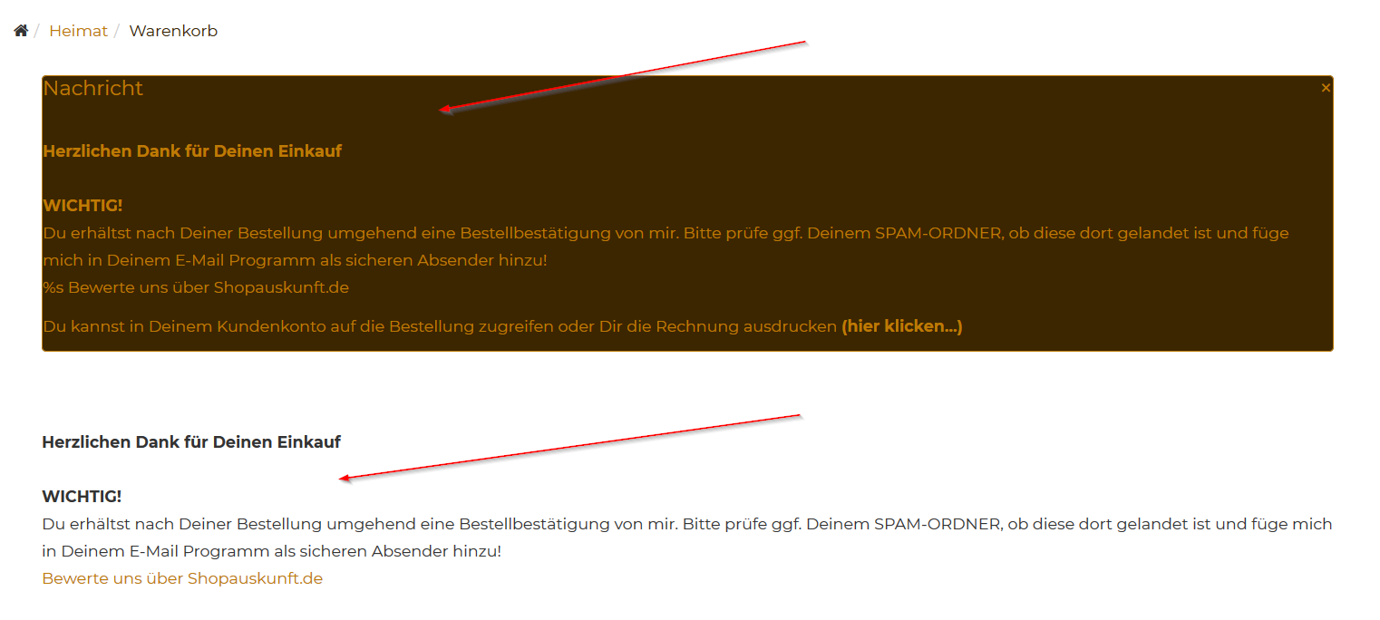

thanks for the correction. Now it works - BUT - with a double message :) (see screenshot
Without your code(s) I normally get after PayPal the brown screen with the messages (this can also be closed on the open right on the "x"). Nothing beneath.
With the code from above I get also a message below directly in the white page (that's even netter the this brown "popup" above). But the dirrerence it - in the brwon box I additionally have the sentence with: here you can access your order - that's missing in the white part.
How can I eliminate the brown section after PayPal sucess and only get all the information for the user in the normal white website section. Also with like: Summry of showing E-Mail Adress, Order Number, Ammount of Purchase etc. I think it would be enough just to give me one example how to access these varibels so I can adapt it the the other ones (just need to know how thex are names) :)

That's because you didn't remove the line:
$app->enqueueMessage( JText::_('THANK_YOU_FOR_PURCHASE') );
