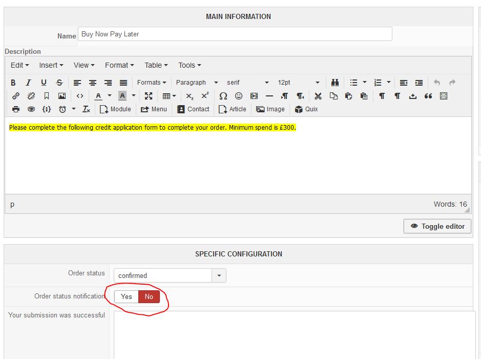

The main issue is that the customer gets notified that the order is created before they have completed the application form, so I thought that by going into the payment method and selecting NO under order status notification then it would prevent anything being sent to the customer? (BTW, there is no Hikashop help available for this page).
However I still get an order created email - is there a way to prevent this and I can send a manual email when the finance application has been accepted?

HikaShop sends two emails to the customer:
- the order creation notification which is sent when the order is created at the end of the checkout
- the order status notification which is sent when the order status is changed to confirmed automatically (or when you change it manually and activate the notification to the customer)
So from what you're describing, you want to disable the "order creation notification" via the System>Emails menu.
That way, only the second email will be sent, and that will be only the case if the "order status notification" setting is turned on in your payment method.
You can check the emails sent to the customer in the Customers>Emails history menu.
