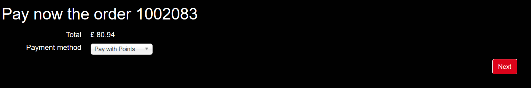

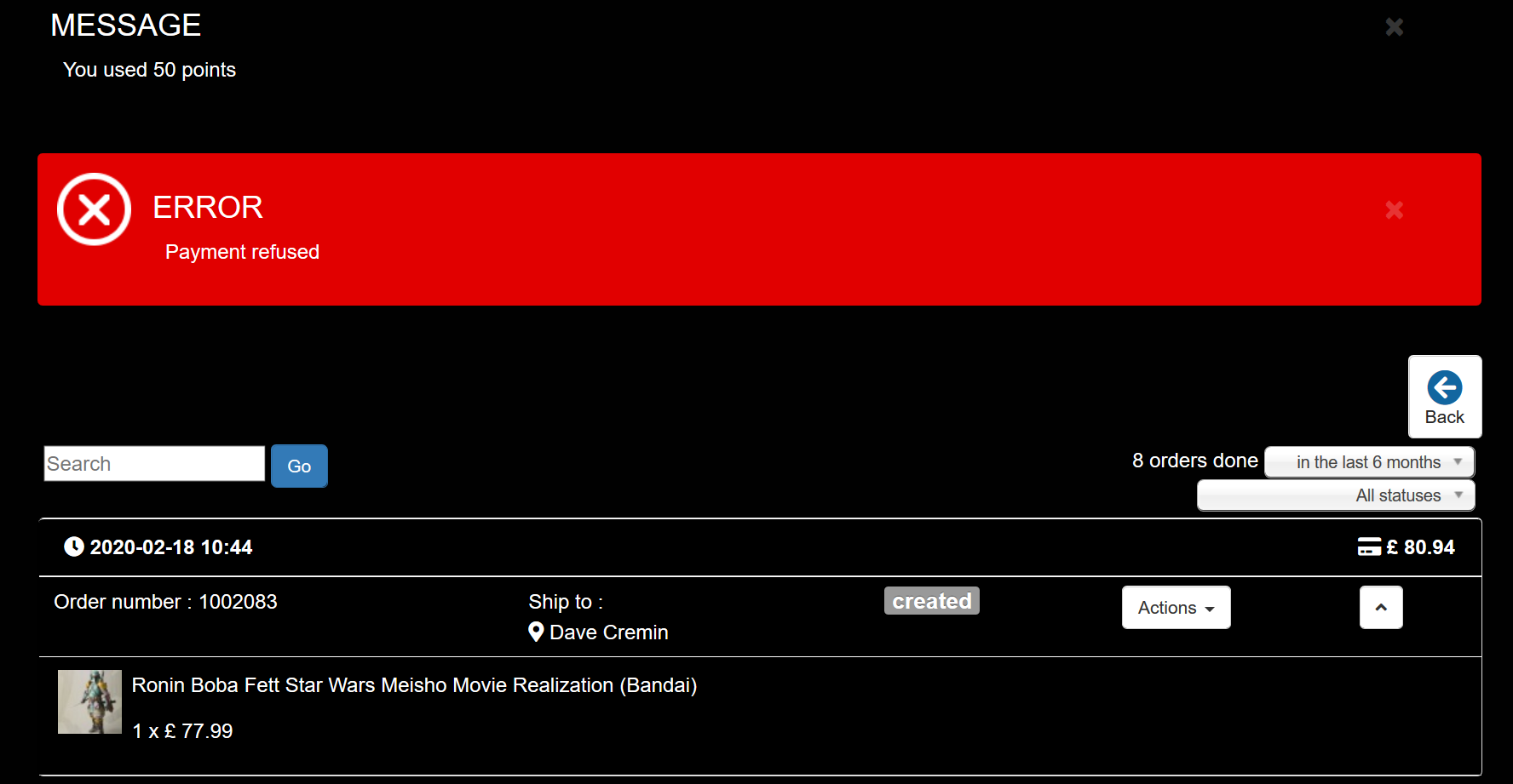

I am trying to configure the pay with points option. I have a couple of queries.
The site currently allows people to make a deposit payment as an order. When the product is available another order is created in the admin area and notification is sent to the user which give them the option to make payment.
When the pay now button is clicked they get the Pay Now screen (image Pay now). There is Paypal, Stripe and pay with points. Pay with points is selected, I click next and get an error. (image payment page). This action also removes the points from the user but the order is not paid.

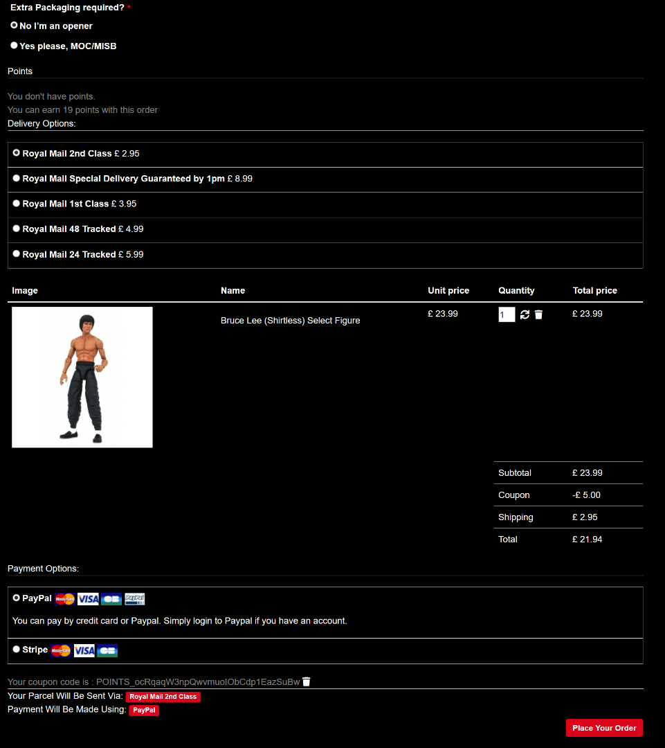

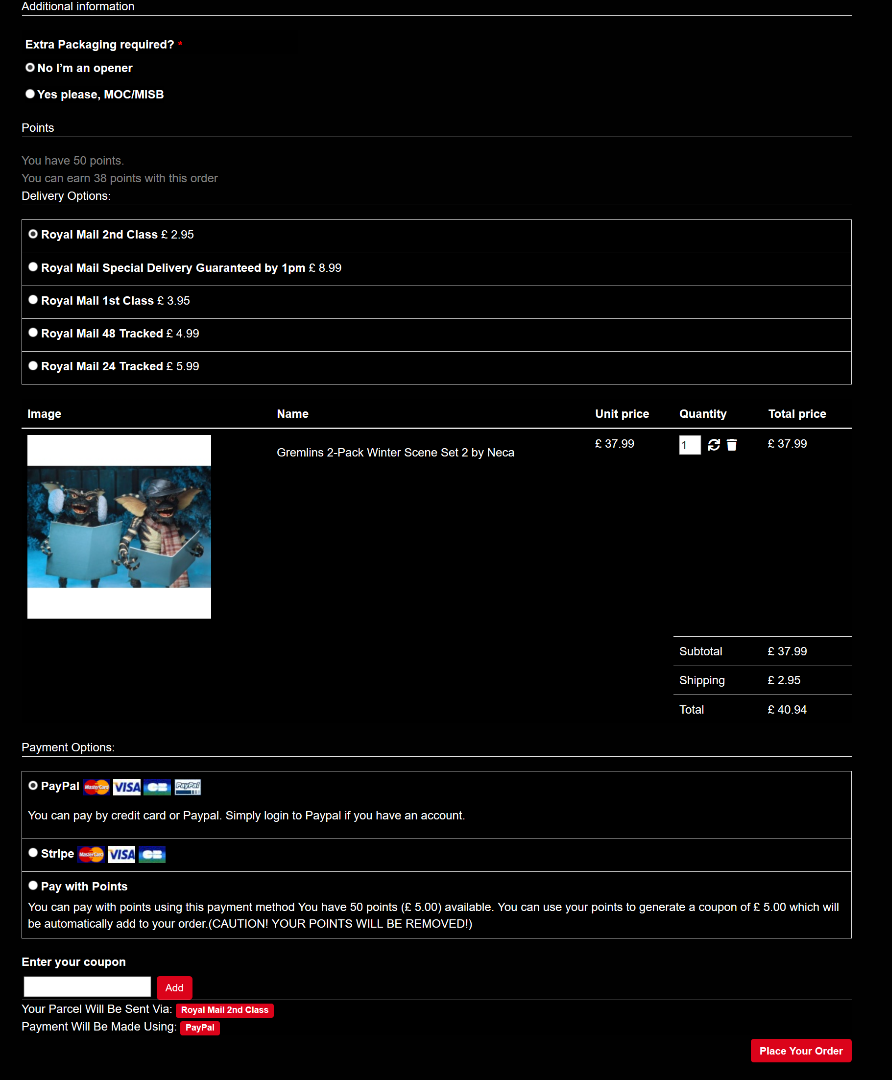

I have tried placing an order on the site and I can pay the order with points. However having allowed the points to be used is then asks to place order with the remaining total. Clients may think they are being asked to pay twice?

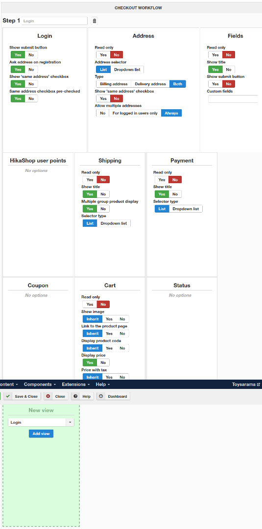

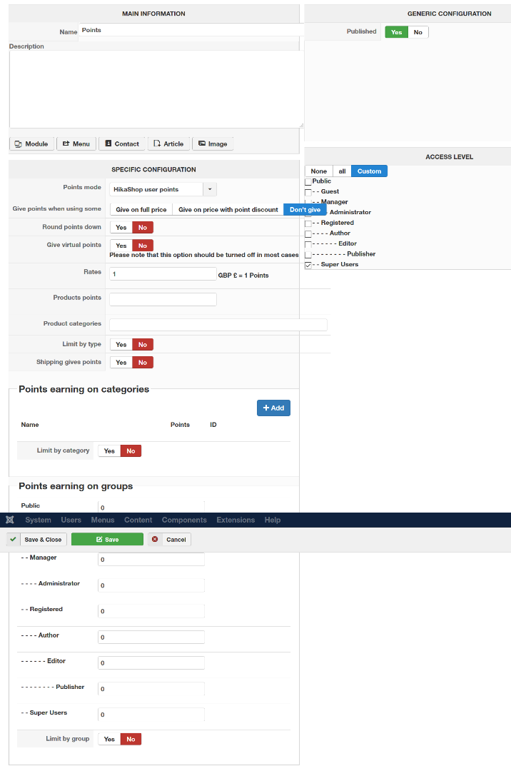

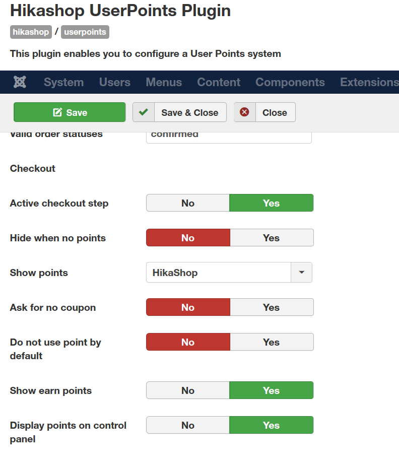

I have attached the checkout workflow, user points and payment user point plugin settings. Perhaps you can check those for me please?

6 years 7 months ago #315810
I tried to reproduce the issue, with different setups but every time I'm not even able to select the user points payment method in the dropdown there (which is normal as it works in a specific way adapted to the checkout and not to this interface).
Also, you didn't provide a screenshot of the settings of the user points payment method (which is the most important here), so I don't know how you set it up (which is also probably why I can't reproduce the issue).

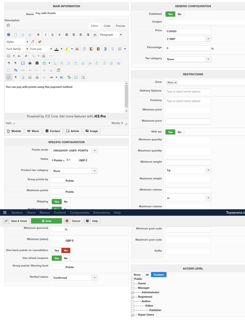

6 years 7 months ago #315830
Hi Nicolas
I thought I had added that screenshot. Now attached

6 years 7 months ago #315880
Since you do have the "pay with points" in the payment listing BUT your point payment plugin is configure with the "virtual coupon" mode ; that scenario is not possible.
So I do have the feeling that you have another "points payment" plugin configured.

6 years 7 months ago #315882
That's indeed possible during the checkout. But as I said, the points plugin is not made to be able to do that on an already created order.
So that's why it's not displaying as a payment method option when you pay an order on the "pay now screen".
The fact that you see it there is the mystery here. As Jerome said, it might be possible with the "virtual coupon" mode setting turned off in your payment method, but on my end, even with that setting turned off I don't see the payment method there due to other checks.

6 years 7 months ago #315891
I checked your website but as expected I'm not able to reproduce the problem.
First, on the checkout, contrary to your screenshots, I don't see the user points payment method as a payment method but with the points view:
monosnap.com/file/06bEwSi4Uajno0PXKlHOoqRFgJPw8g
And if I go to my account and try to pay for an order waititng for payment, I can't select the user points payment method:
monosnap.com/file/VdhnFXlshSLVD3qKCBJzHQOScppgLV
So what I suppose you did is that you must have created an order via the checkout while the "Use virtual coupons" of the user points payment method was turned off, and then you checked the order payment on your frontend, and since that payment method was selected in the order it was in the dropdown even though it cannot work there.
So I think that the way you set it up now is all good and you can just leave it like this since it can't happen to others now that the "Use virtual coupons" setting is turned on.

Thanks for the reply. I have looked again today and now do not have the option to use points on an order created in the admin. However if I create an order through the normal process I have an option to use points, these are automatically deducted if select yes for using them.
So if an order is created in the admin a user will not have an option to use points as part of payment. Is this something that could be implemented in a future release? I cannot see an option for the admin to pay any of the order using the points either, so this is not possible?
