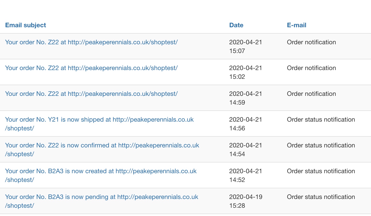

For some reason I don't receive any HikaShop emails regarding the creation and processing of orders.
After order creation, nothing received, but it is recorded in the system (and the email history suggests it has been sent)
If I then go into the Order and change the Status to say Created or Confirmed manually and scroll down and send an email (addresses look ok and are valid addresses) and click OK - no emails ever arrive.
If I then look in the Customer Emails History - I can see all the emails that it should have sent, admin, status, creation.
Question is why? Have I missed something somewhere? I'm assuming it's me and not HikaShop?
I've spent a lot of time looking at this and finally decided to ask to help. Attached a pic of the order history email screen, if it helps.
Suggestions very welcome!

If you see the emails in the email history of HikaShop, it means that HikaShop sends the emails to your server / hosting 's email server which then cannot send the email or it can but the receiver email server refuses it. So not much you can do in HikaShop itself (and it's not a bug of HikaShop either).
So there are two possibilities:
- You have a problem with the settings in Email section of the Joomla configuration or you have a problem with the Email section of the HikaShop configuration. So what you can do is contact the support of your hosting with a screenshot of the details of an email from the email history and a screenshot of each email configuration sections and ask them why the email was not delivered. They should be able to tell you what happened to the email looking at the logs of the email server on their end.
- You server is flagged as spam or your emails for one reason or another. you can use the website www.mail-tester.com/ to test your emails with it to see if you have spam problems. Again based on what it tells you, you might need to seek advice with your hosting support.
