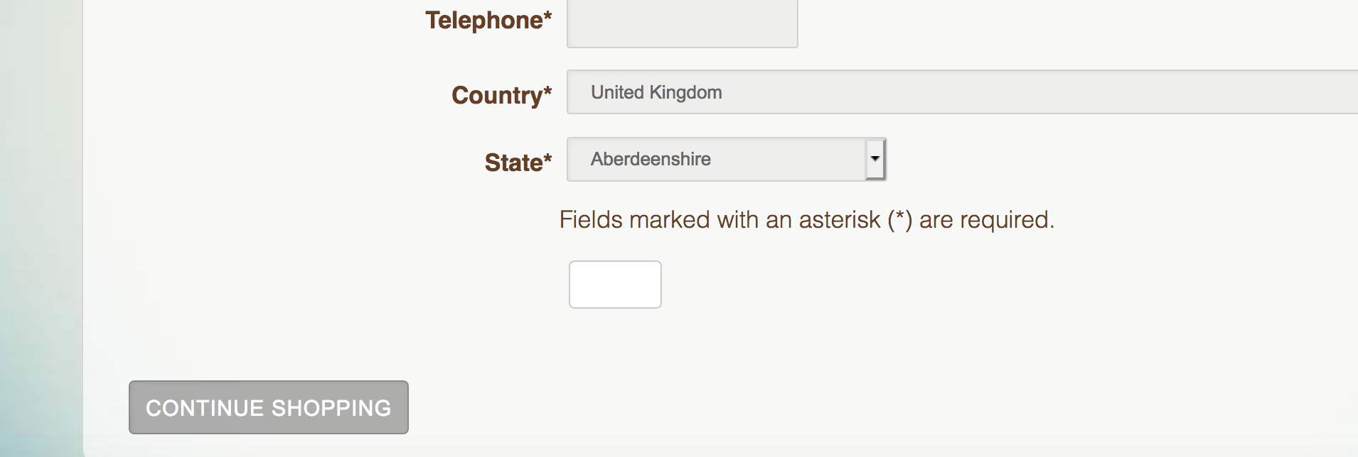

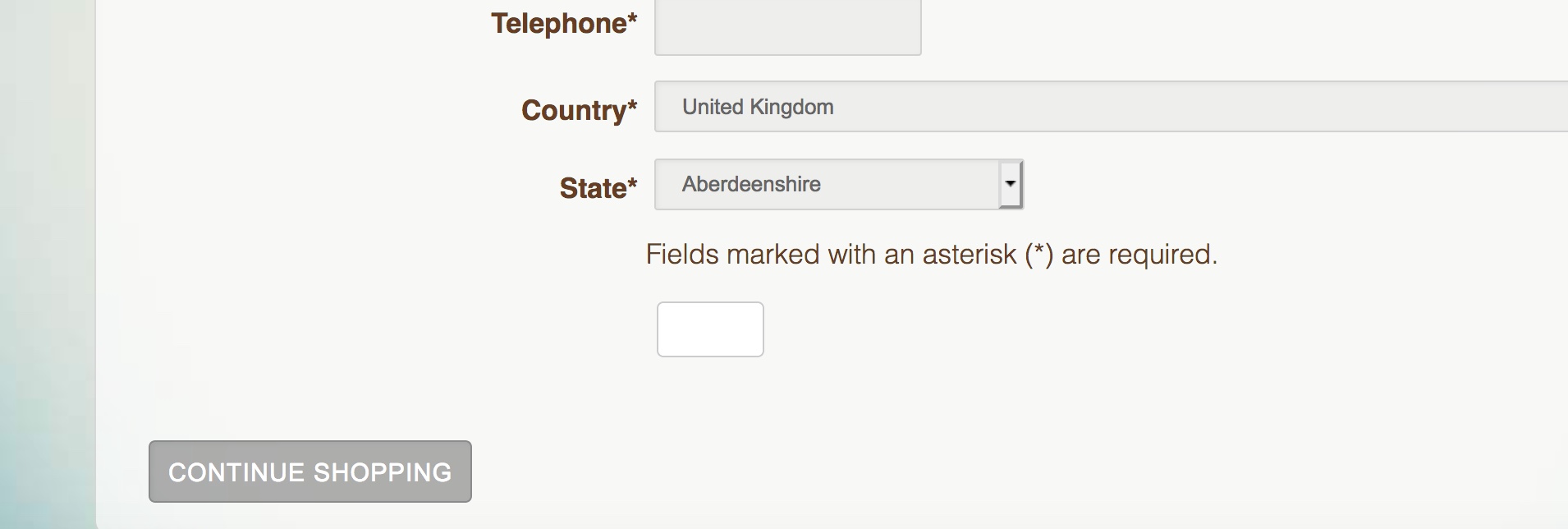

In Step 2 (Address) in Guest checkout there looks to be 2 issues with the NEXT button...
1) It's indented to under the address unlike all the other NEXT buttons which are hard left
2) It looks blank - until you hover over it and then you can just see the text NEXT which isn't very obvious to a user. All the other NEXT buttons have much more contrast so the text can easily be seen.
I have attached a screen shot showing the problems.
Is there anyway to fix these issues? Mostly point 2)
  • Posts: 86214
  • Thank you received: 14221
6 years 4 months ago #318048

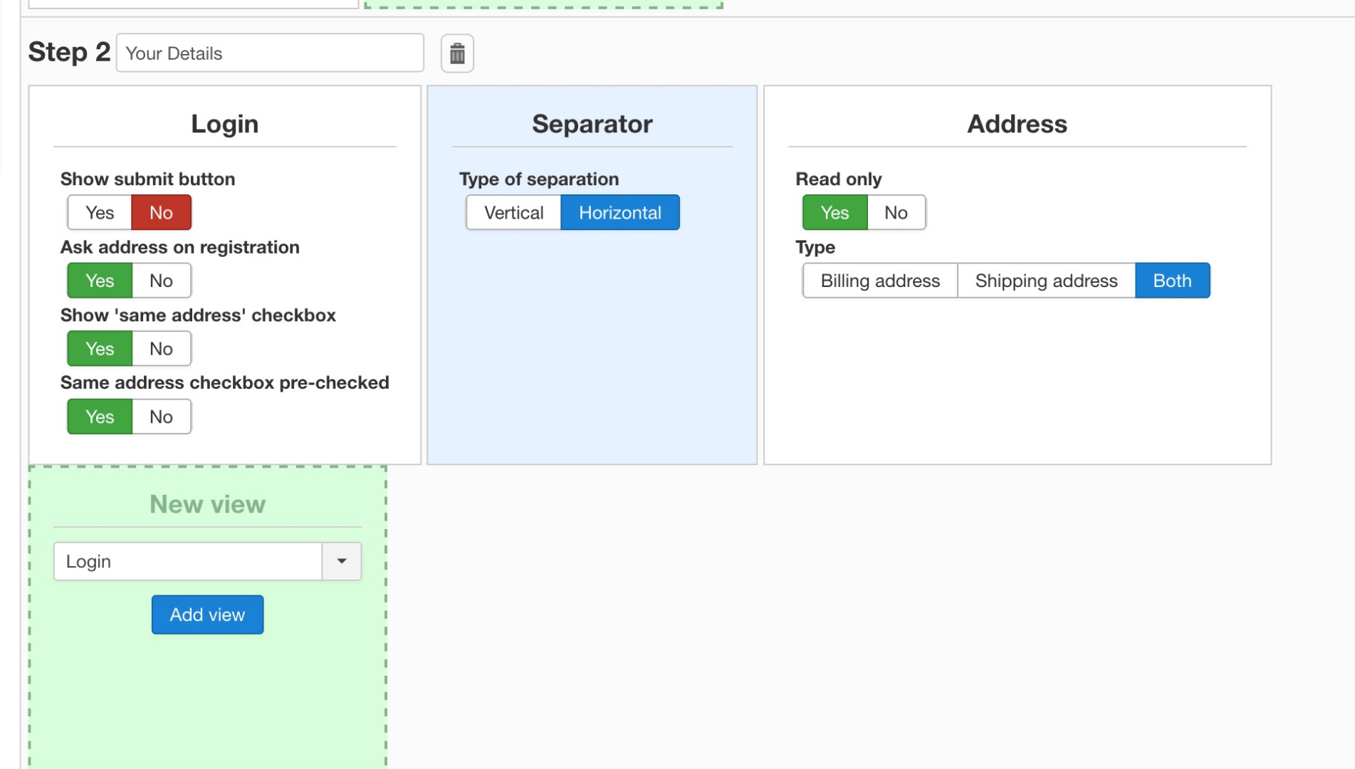

This next button seems to be the one from the registration form, not the main one on the checkout page.
So if that's the case, you can remove it by deactivating the "Show submit button" setting of the "login" view in your "checkout workflow" in the HikaShop configuration.
And continuing with this hypothesis, you should have another next button at the same level as the continue shopping button. If you don't see it, I can only think that it has been removed either with a view override or CSS code for some reason.

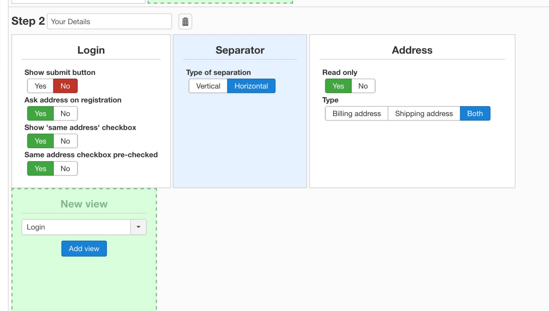

  • Posts: 29

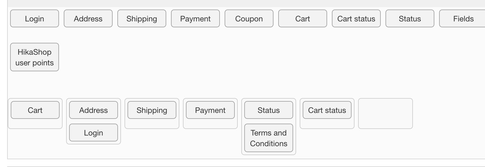

So I started messing with the Login button/step in the workflow, since I'm using Guest checkout I tried removing it and also moving its position around a bit but I couldn't advance beyond the initial Cart step. However, after returning this Login step back to the Address step (but below the Address step) the issue seems to have resolved itself... I think. Not entirely sure why though.
So the Login tab/step in the checkout has changed to Address instead, which is fine, but it seems to take 2 clicks, of the now correct Next button, to advance the process if a Shipping address is added... why would this be?
I may have listed the wrong site URL? Try this one, it does have Products now...
peakeperennials.co.uk/shoptest/index.php/shop-all-plants
I've also attached the step workflow, if it helps.

6 years 4 months ago #318079
I don't think the situation has changed, it's just that you logged in, so you now see the address view instead of the login view.
Looking at your screenshot, I can see that you're using the old checkout of HikaShop.
Turn off the "checkout legacy" setting of the HikaShop configuration and save. You'll then see the new checkout workflow editor interface with the "show submit button" setting I was talking about.

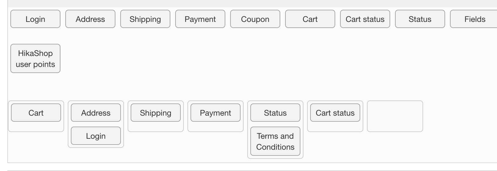

  • Posts: 29
6 years 4 months ago #318143
Thanks, getting there! New checkout flow config is very good. Why isn't it the default?
I think I've sorted it now. I can only enter 2 addresses now and seem to be able to edit them and see the changes. However, to exit the address changing you have to click NEXT which exits Step 2 and goes to 3 so you're not sure it you've got them right. You have to go back to Step 2 to check. No point in adding a 2nd address view/step as a check as you could wind up with 2 sets to addresses being shown. Probably just leave it as it is, unless you have a better idea!

Looking at the concrete examples the Login views don't have options.. mine always do! Do I need a login step? I tried without one and I don't then get the email boxes... I was getting quite confused.
The rest of the checkout seems to be fine.

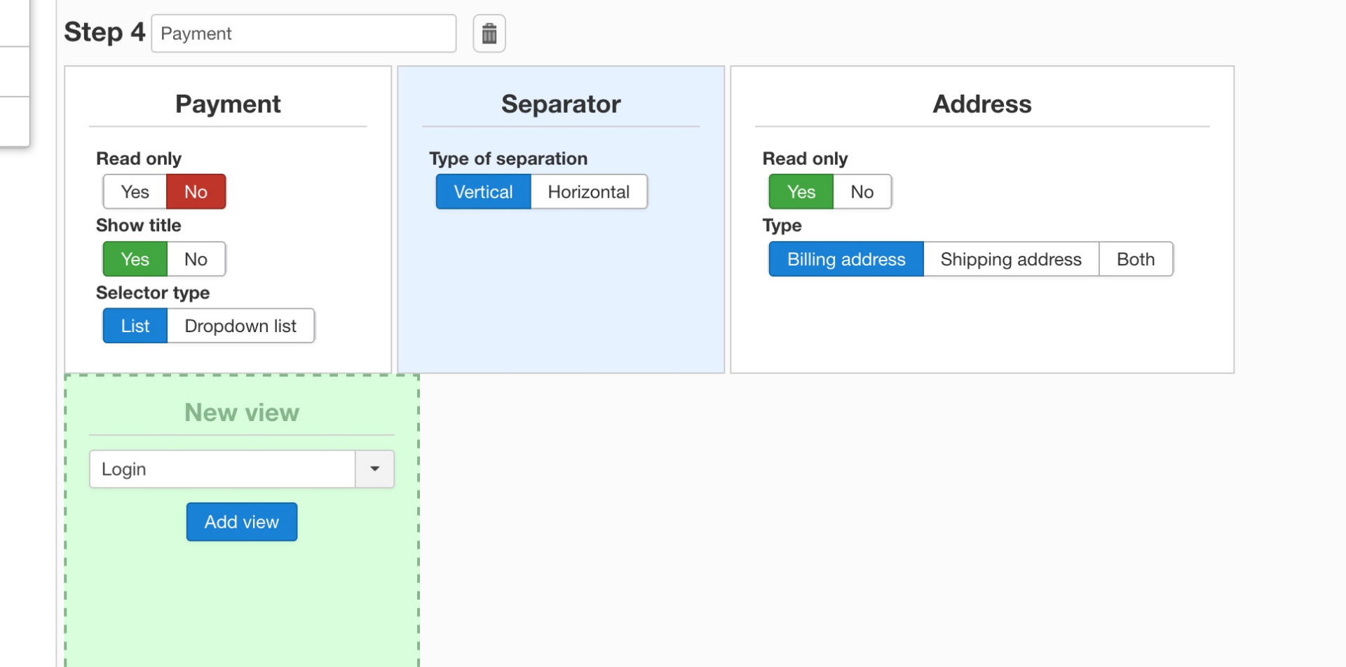

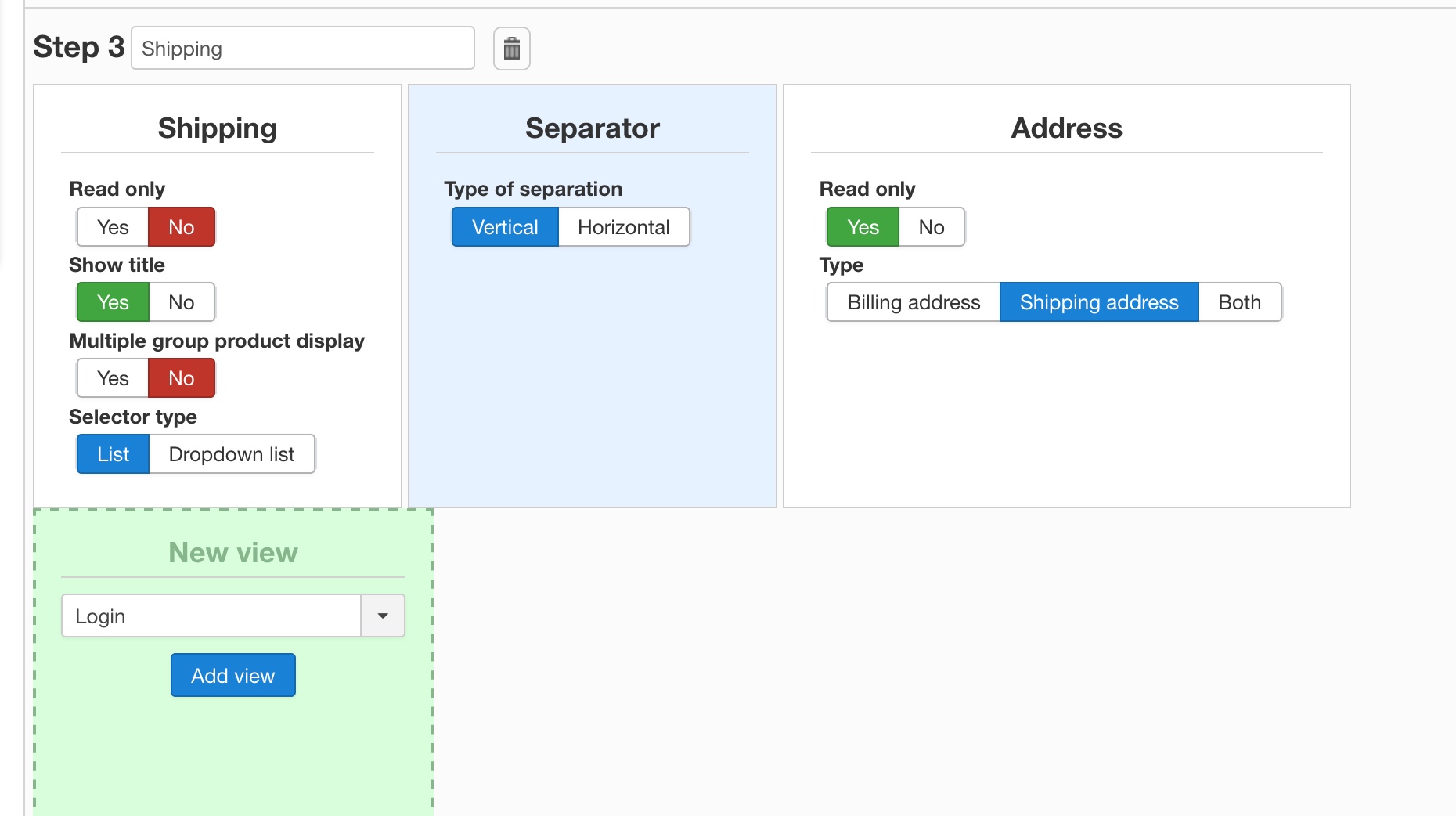

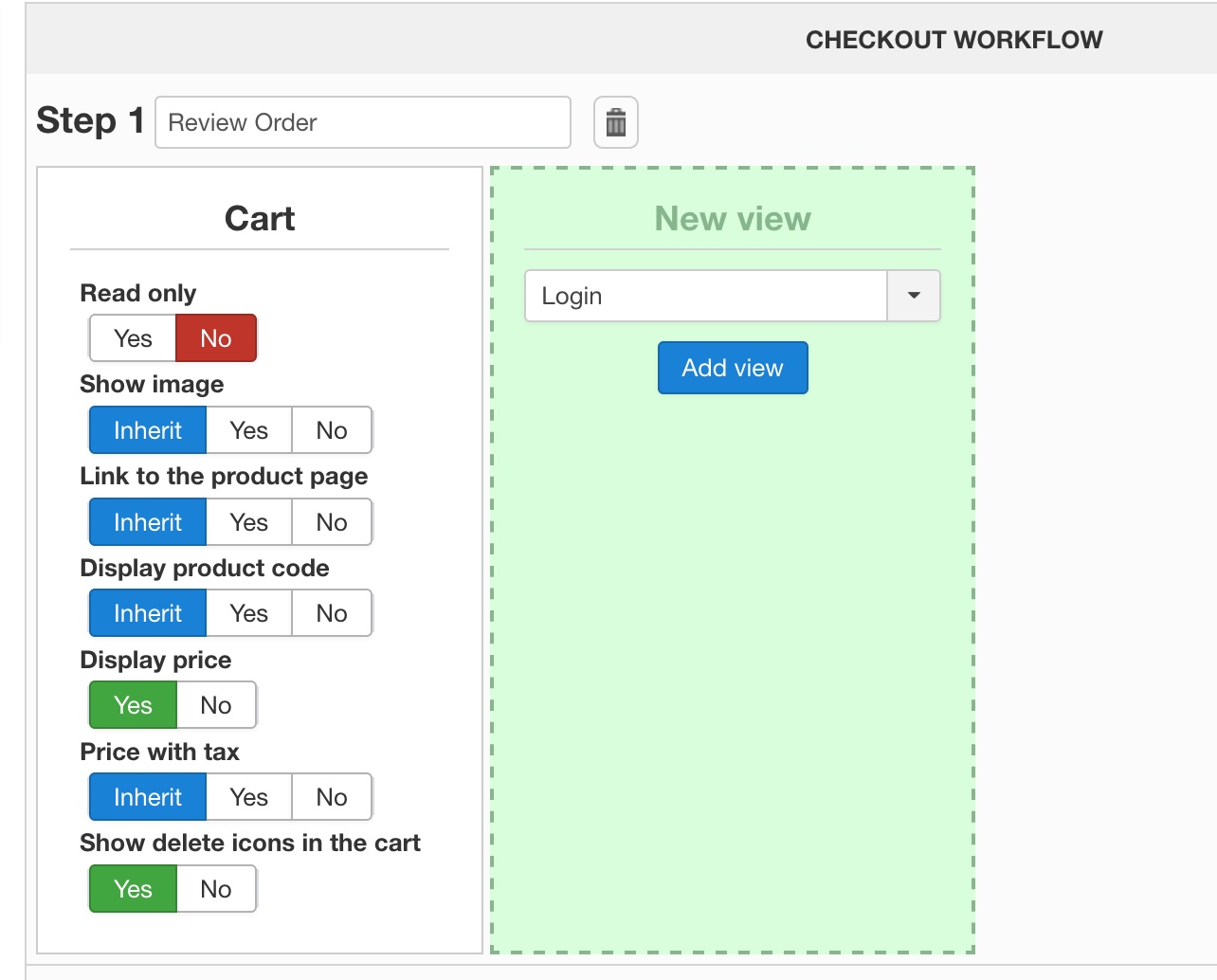

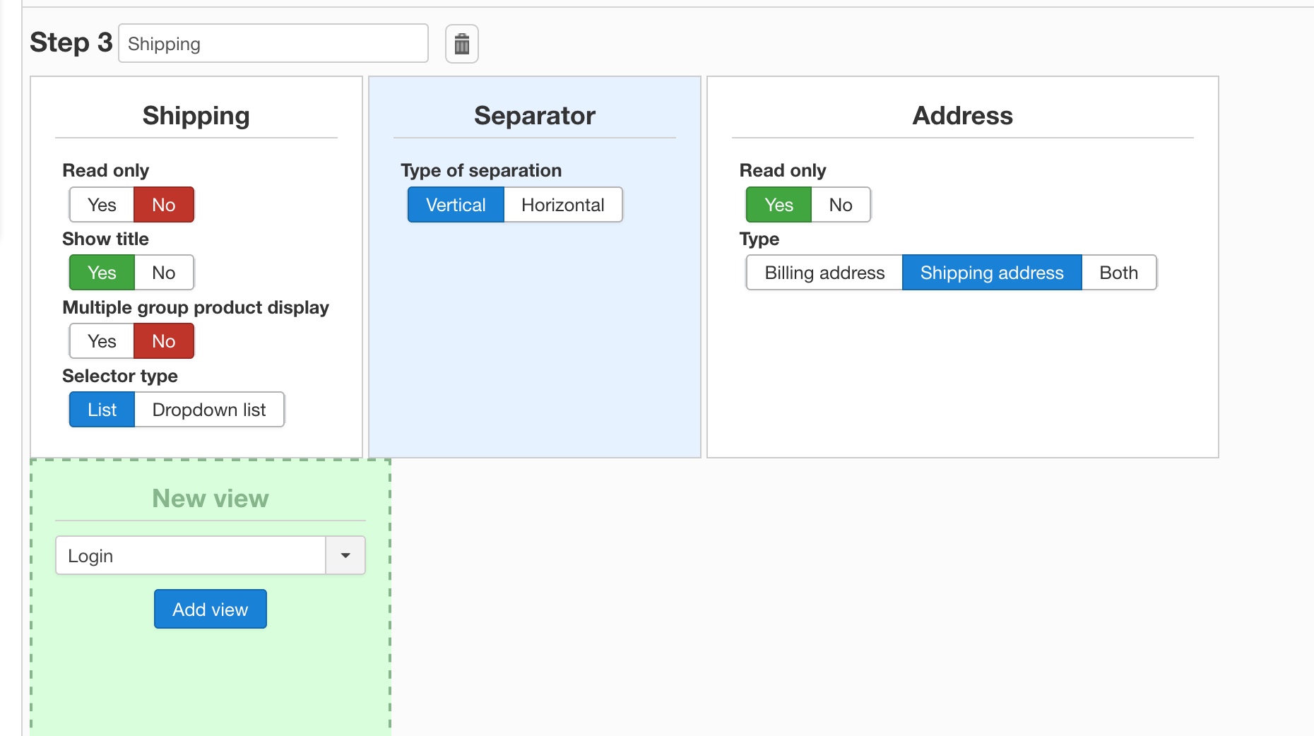

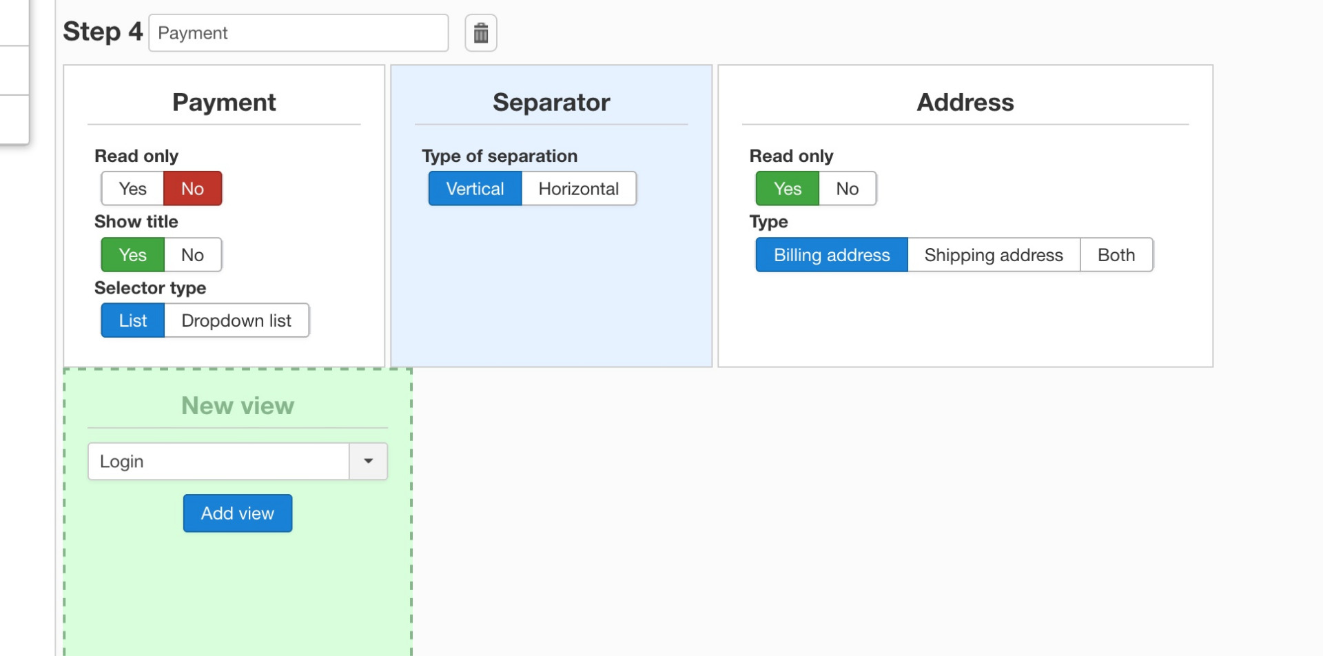

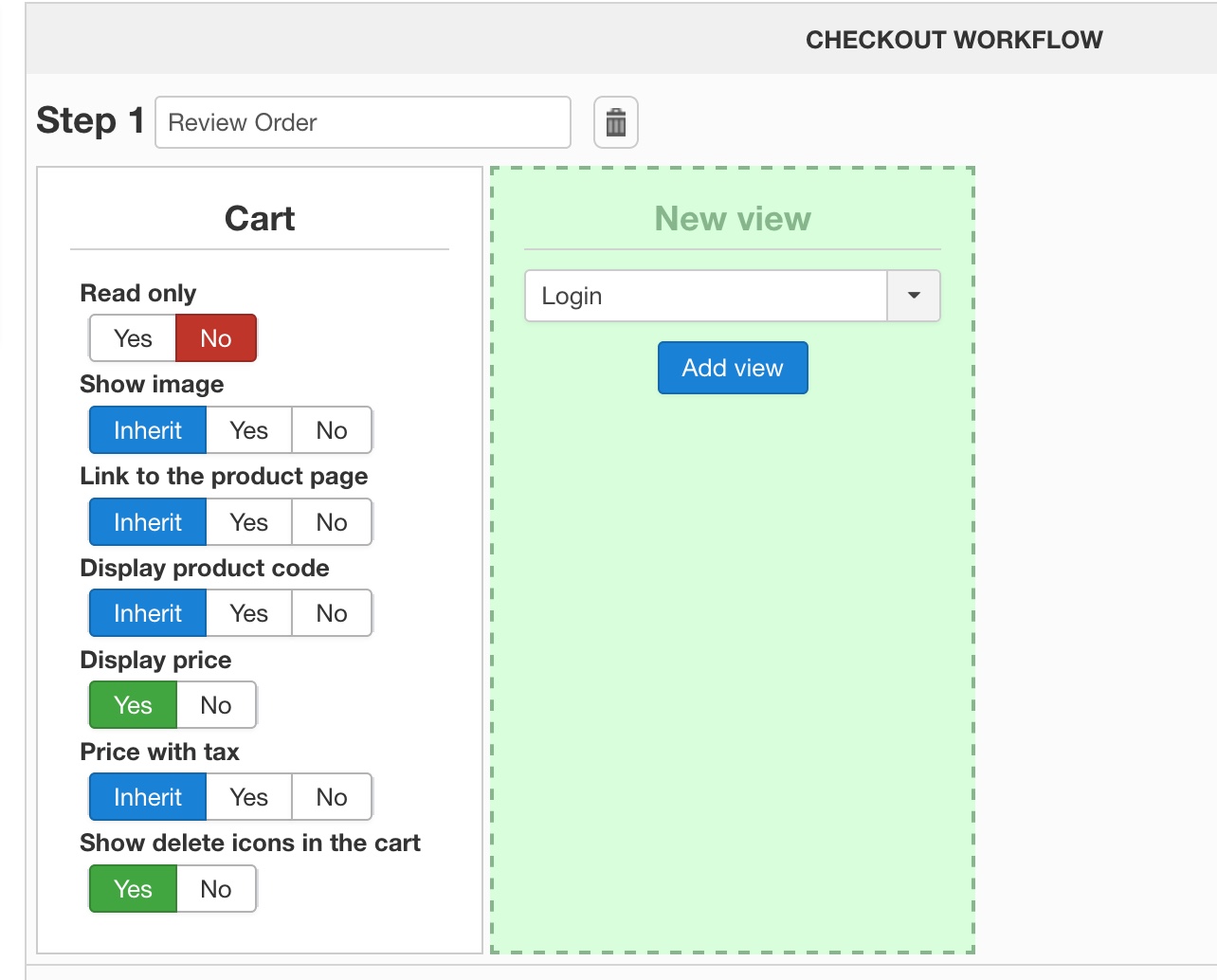

Attached a shot of the relevant workflow steps in case they are needed.
  • Posts: 86214
6 years 4 months ago #318151
It is the default one. It's not if you updated your HikaShop from an old version so that your website checkout doesn't change after the update. Because if your have customizations then you would loose all your customization after the update and people would come here and complain that the update made them loose their customization and that by default the update should keep the old checkout by default ;)
You do need a login step.
