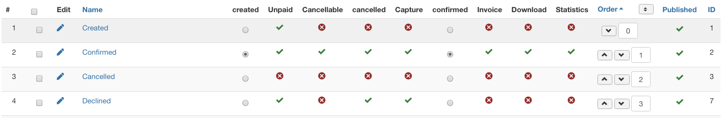

FIRST (EMAIL):
We changed the wording from 'canceled' to 'declined' — Hopefully the emails will have the correct wording now.
