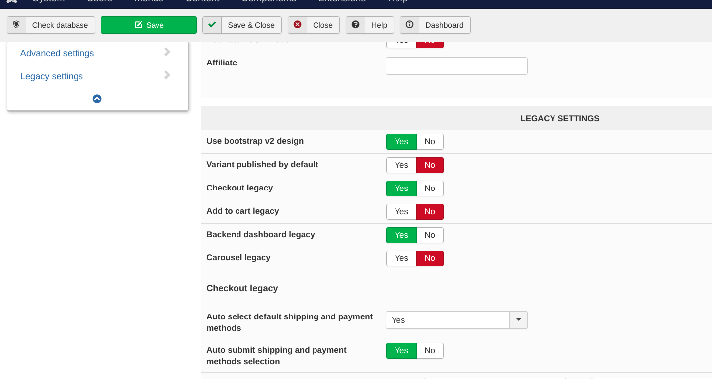

  • Posts: 13
6 years 3 months ago #318793
Great. I could not look in debug mode as it is my customer's tablet. But I have changed some of the options in config. advanced and put 'yes' for checkout legacy, in that case the checkout even does not work on my computer. It seems there is something wrong with the checkout. I wanted to check the checkout options in demo.hikashop.com but the configuration panel is not available. Any reason why we can't access it in the demo version, that would be very helpful.
I could give you access to my back-end if it would be helpful for you to look at it. I'm loosing a few customers because of that.
Martial
  • Posts: 86095
  • Thank you received: 14199
6 years 3 months ago #318795
I wouldn't recommend activating the "checkout legacy" setting. This would switch you to the old checkout. It won't work as great as the new checkout especially on recent versions of PHP as it was made years ago.
And the demo website configuration page is not available so that people can't mess with it (to avoid abuse which we got in the past).
The thing is that I don't have the issue on our demo website (which is not using the legacy checkout) with an old android tablet.
So this means that the javascript error is not in HikaShop but on something else on your website.

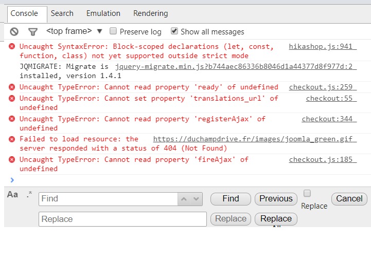

  • Posts: 13
6 years 3 months ago #318823
We (my brother) had fixed the pb, he followed @ stackoverflow.com/questions/33001246/unc...st-function-class-no . He added "use strict" at the top of hikashop.js. If it safe to do so? At least it now works on all the devices tested. The error message we got before to add "use strict" on the tablet is attached.
Thank you
Martial
  • Posts: 86095
6 years 3 months ago #318826
Thanks for the feedback.
I see what's the problem.
It comes from the line:
for(let i = 0; i < refreshAreas.length; i++) {
The browser on these android devices doesn't like the "let" command (which is valid).
The use strict solution is good yes.
However, I would only add it at the top of the refreshFilters function where that let is.
Can you confirm that it works like that too so that we can include it by default ?
monosnap.com/file/T1FAV4WTY1e6L0qO85LnWtGU4AGTH2
