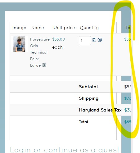

Mobile Display of checkout fields are too wide

On desktop and tablets it's fine but on mobile displays, the rows overlap the edge of the screen (screen shot attached), also happens with the input fields for address etc.
How can i make the checkout more responsive in mobile view?

By default, the HikaShop checkout is responsive, here there is something that mess up your display in mobile.
From this, several things you can try in order to better understand your issue :
1. Try to process some test with a default template (like ProtoStar)
2. Try to switch off Bootstrap.
From Main HikaShop Configuration & Advanced tab
If use a default template solve your issue, check that you haven't some HikaShop override view, and if not, this can mean that your root issue come from your template.
then contact your template creator support.
Note : Documentation around HikaShop override view
Hope this will help you to progress on your issue.
