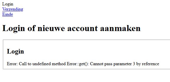

error when customer trys to login was created by Polleke
Last edit: 6 years 5 months ago by Polleke.
6 years 5 months ago #319135
by nicolas
Replied by nicolas on topic error when customer trys to login
It's because you're using the old checkout from HikaShop 1.x and 2.x, which isn't compatible with PHP 7.3.
Turn off the "checkout legacy" setting under the advanced tab of the HikaShop configuration to switch to the new checkout and it will work fine.

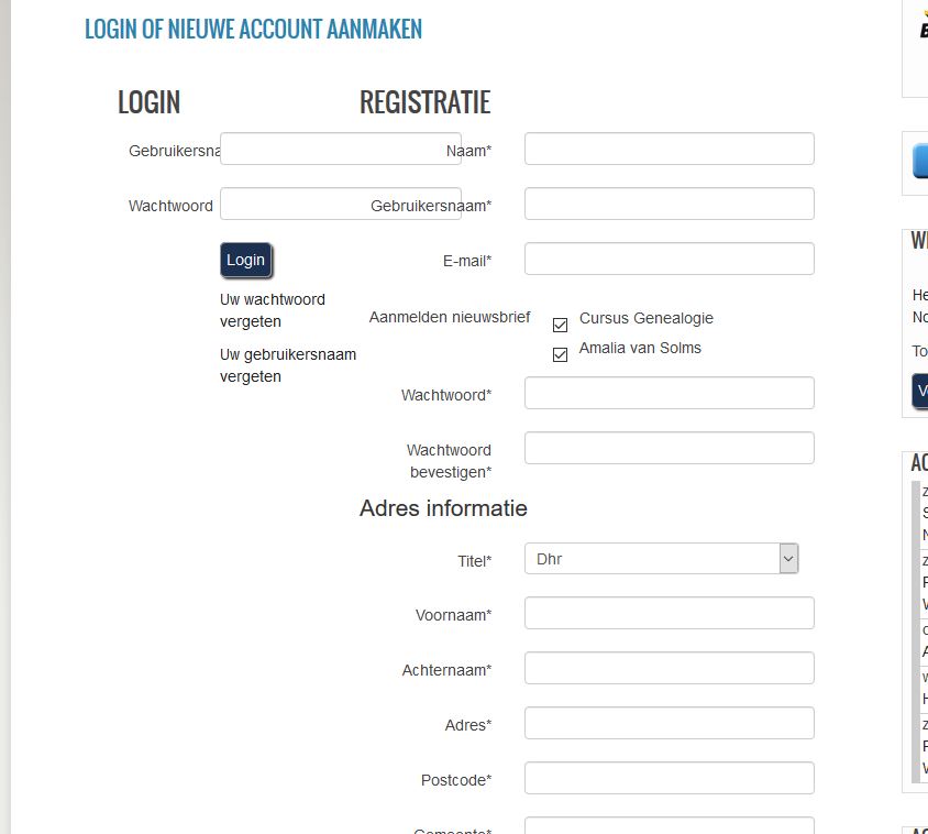

6 years 5 months ago #319215
by Polleke
Replied by Polleke on topic error when customer trys to login
6 years 5 months ago #319235
by nicolas
This just looks like it needs a bit of CSS.
I checked your website but I couldn't find any way to access the checkout.
I went to the page vereniging-2/aanmelden-activiteiten but the products are not sold so I can't add them to the cart.
Could you provide precise instructions to access the checkout so that I could look at the situation with the CSS there ?

6 years 5 months ago #319265
by nicolas
You can add such CSS on your website and it will display properly:
Regarding the checkboxes, they are added by the AcyMailing (auto)subscribe plugin. So you'll need to configure AcyMailing to change that. I would recommend to contact AcyMailing's support regarding this in order to get the exact steps to do what you want with these checkboxes.
Code:
.hikashop_checkout_login .hkc-sm-4 {
width: 100% !important;
text-align: left !important;
@media (min-width:768px) {
div#hikashop_checkout_registration {
margin-left: 100px;
6 years 5 months ago #319335
by Polleke
great job.. Problem solved. Thank you very much
