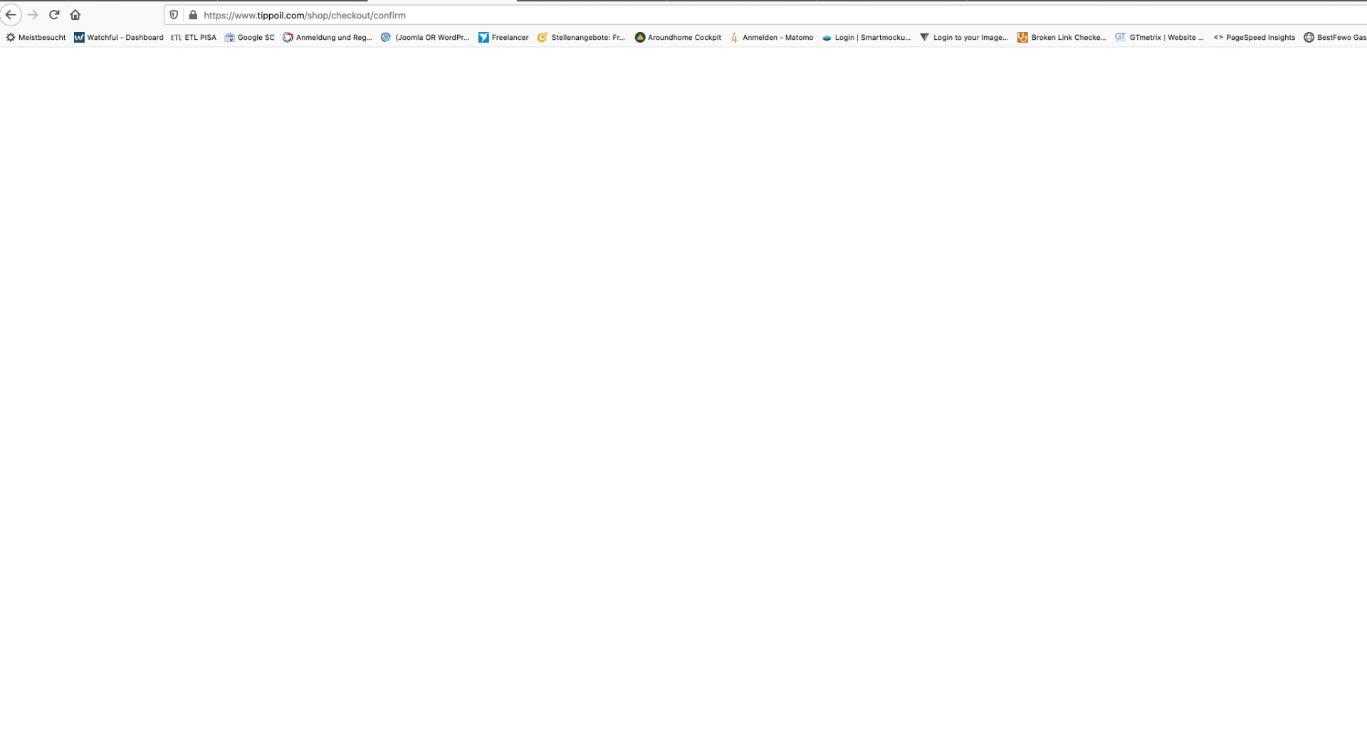

6 years 3 months ago #319799
-- HikaShop version -- : HikaShop Business: 4.3.0
-- Joomla version -- : Joomla! 3.9.18
-- PHP version -- : 7.4
-- Error-message(debug-mod must be tuned on) -- : white page
i just get a white page at the last step - checkout.
same logged in or guest. The template has no overrides.
At the backend i can see the orders.
Any idea?
Nadine
