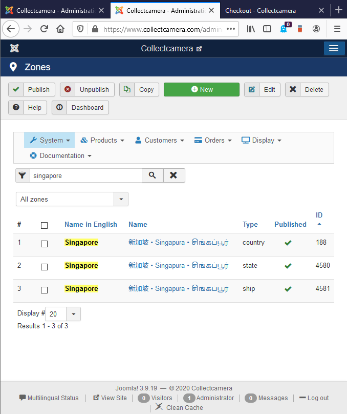

When I checked there was for Singapore only the "Country" zone
I circumvented the problem by creating extra zones for Singapore. I duplicated the "Country" zone for both "State" and "Ship" and added the State as subzone to the country. (ref. attachment)
