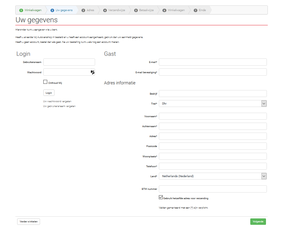

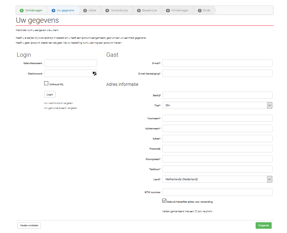

Finally, I almost managed to integrate the GDPR component form storejextentions on the checkout page.
The situation is as follows: when a guest is going to his card to finalize his order, is step two he can select if he wants to log in or go on as a guest.
In the case of a guest, he needs to set a checkbox of the privacy policy. This places the information in the database.
This is working when he is filling in everything. If he forgot to set the checkbox he can't go on. So far no issue.
But if the same user is only setting the checkbox, he is redirected back to the register page (login/guest) and will ask to fill the rest in.
Because the form has already been send and the Privacy Checkbox was set the privacy setting is registered in the database. This is not the proper way because not all field where filled is.
How can I solve it that when not all fields are filled in, but the privacy policy is set, the form is still not be sent? Something with javascript/jquery in the cjeckout.show.php?
I treid to use the defautl joomle solution, but I can't get it working for guest account. Please advice/help

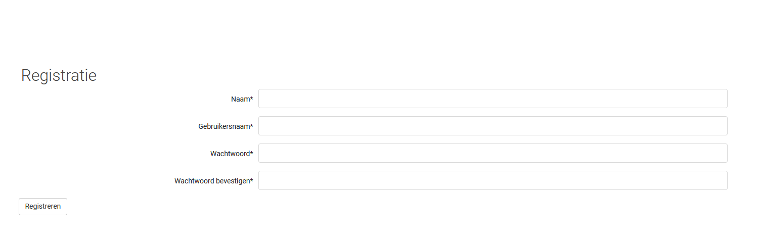

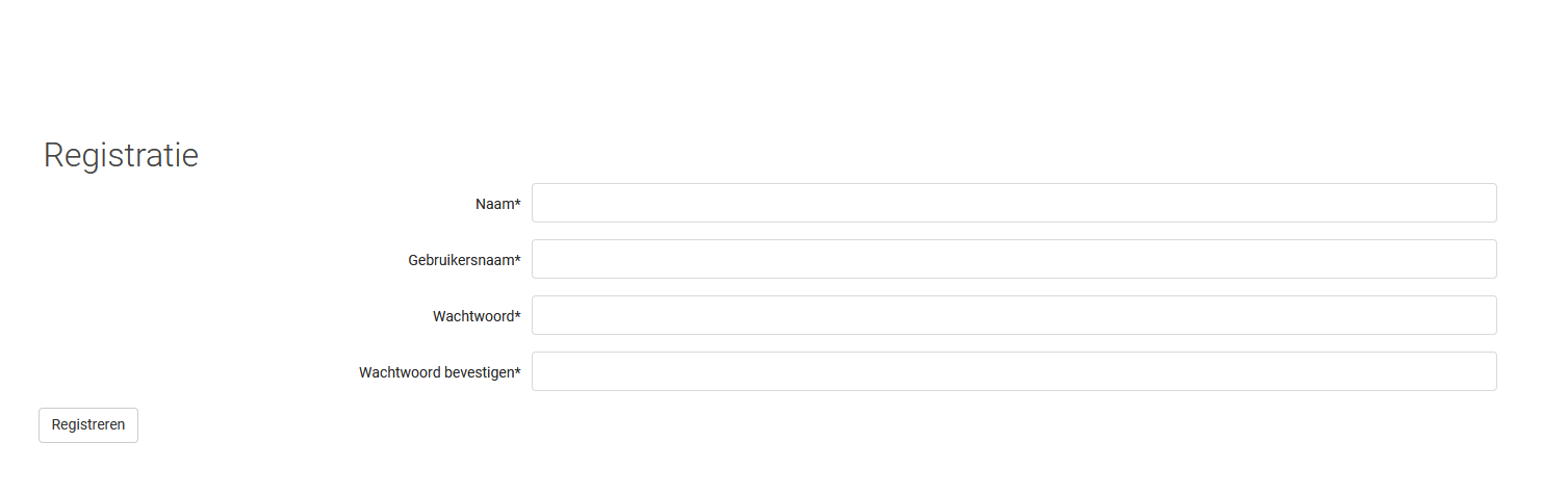

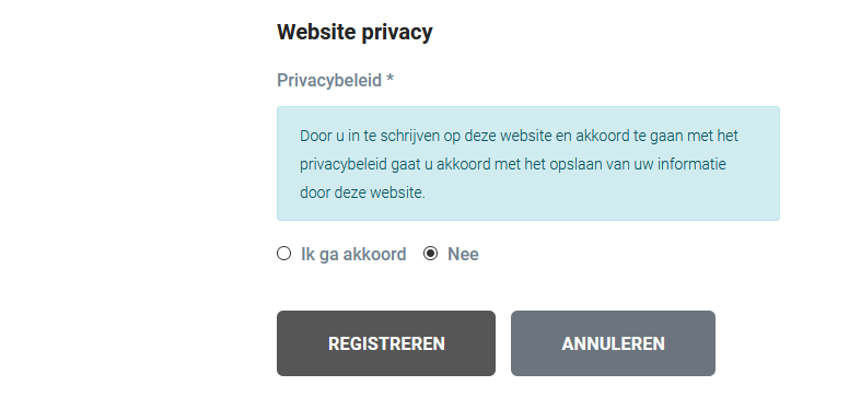

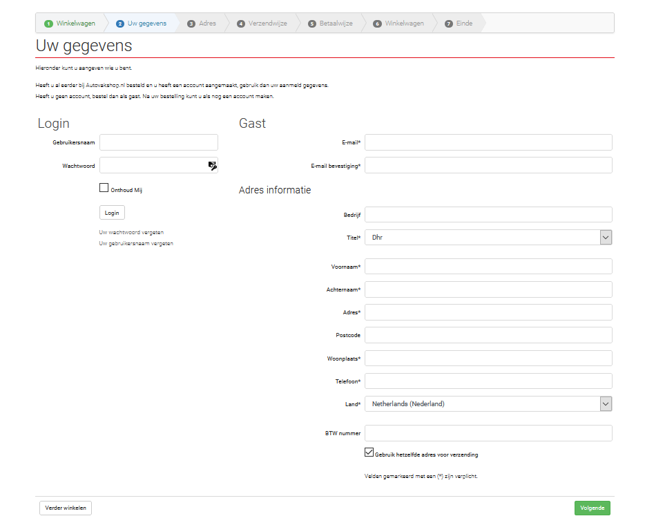

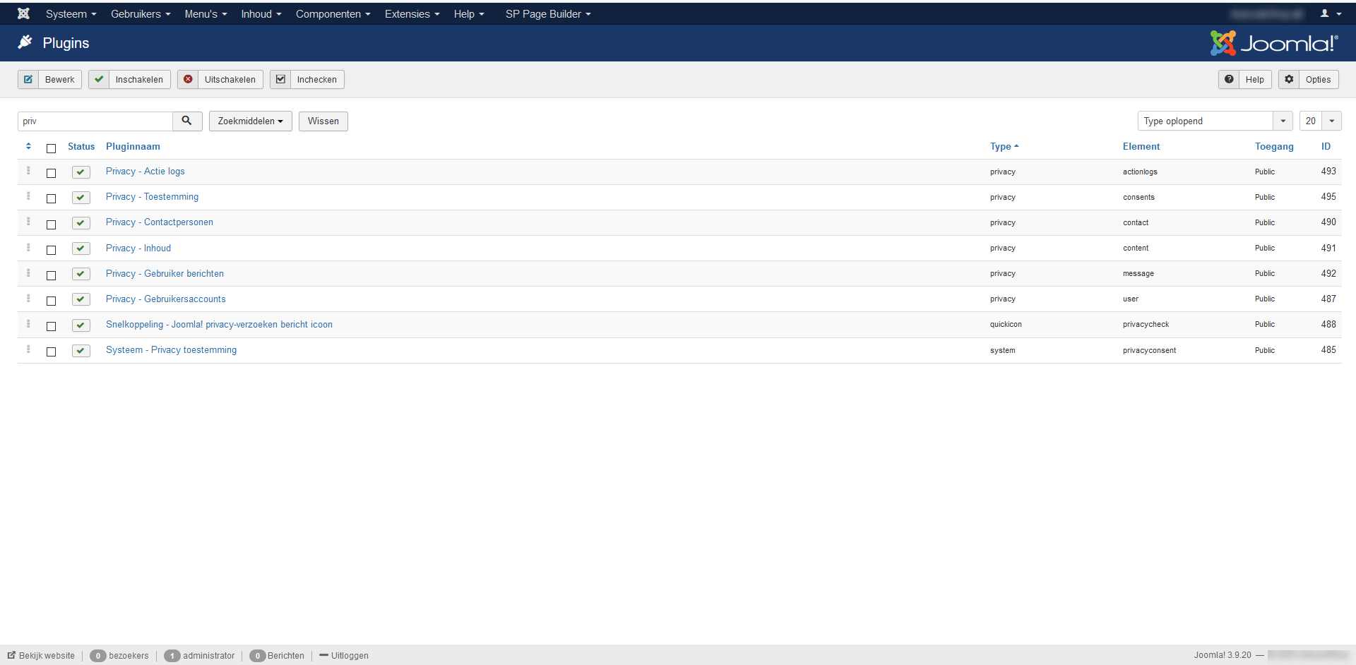

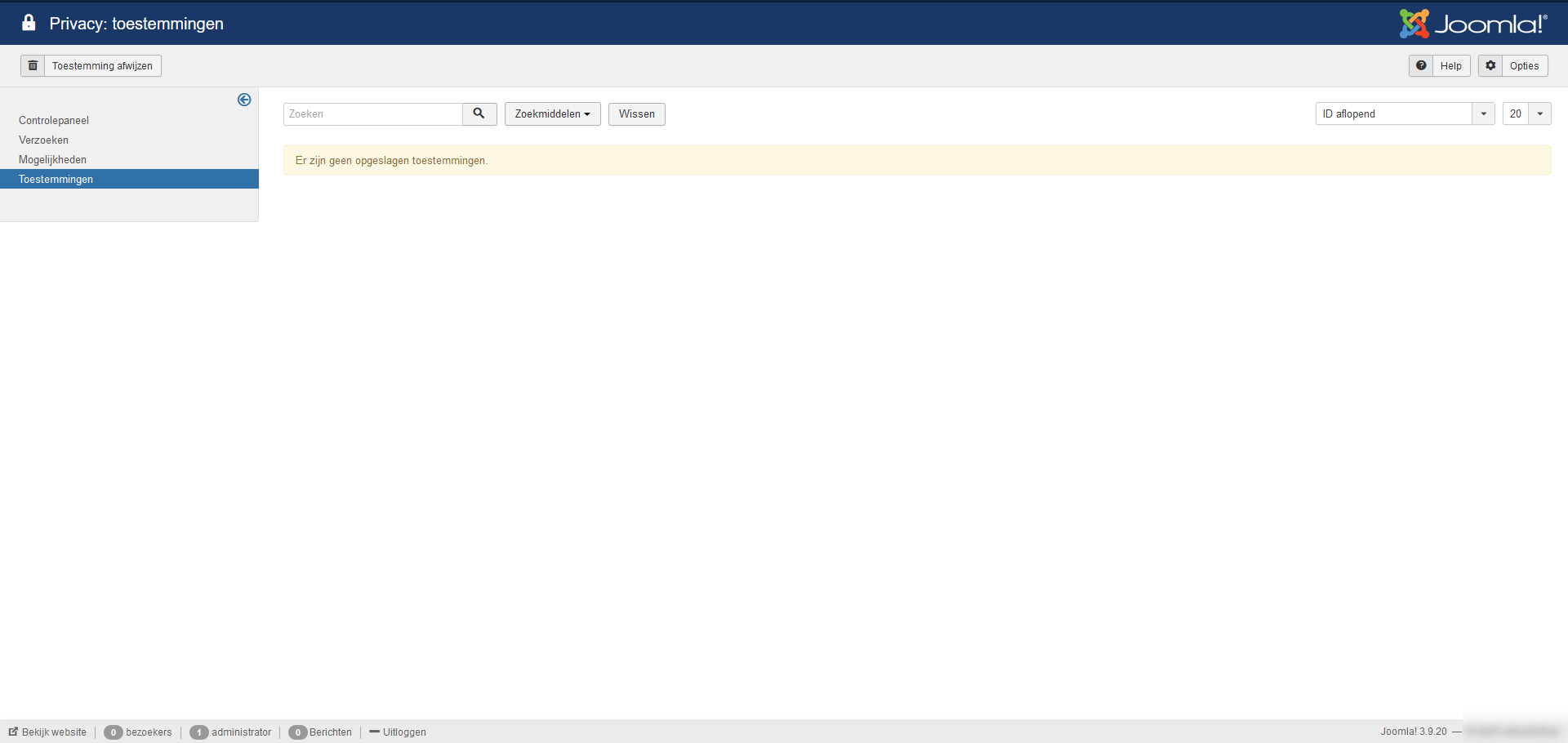

5 years 11 months ago #322807
HI Nicolas,
To be sure I was not working with the old data set of hikashop, I re-installed Joomla, Hkashop, and my template. plugins..

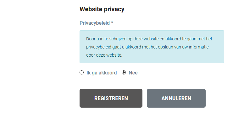

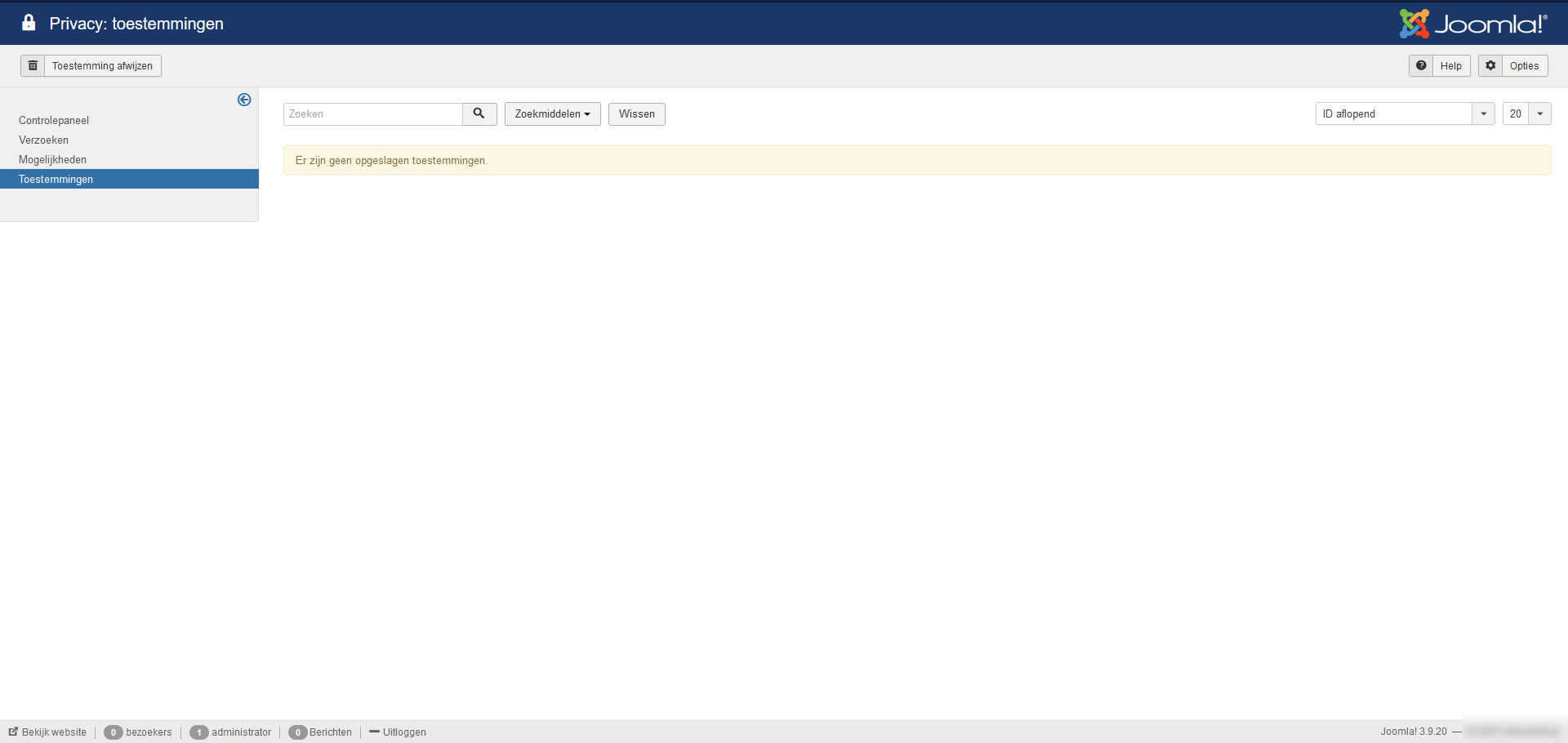

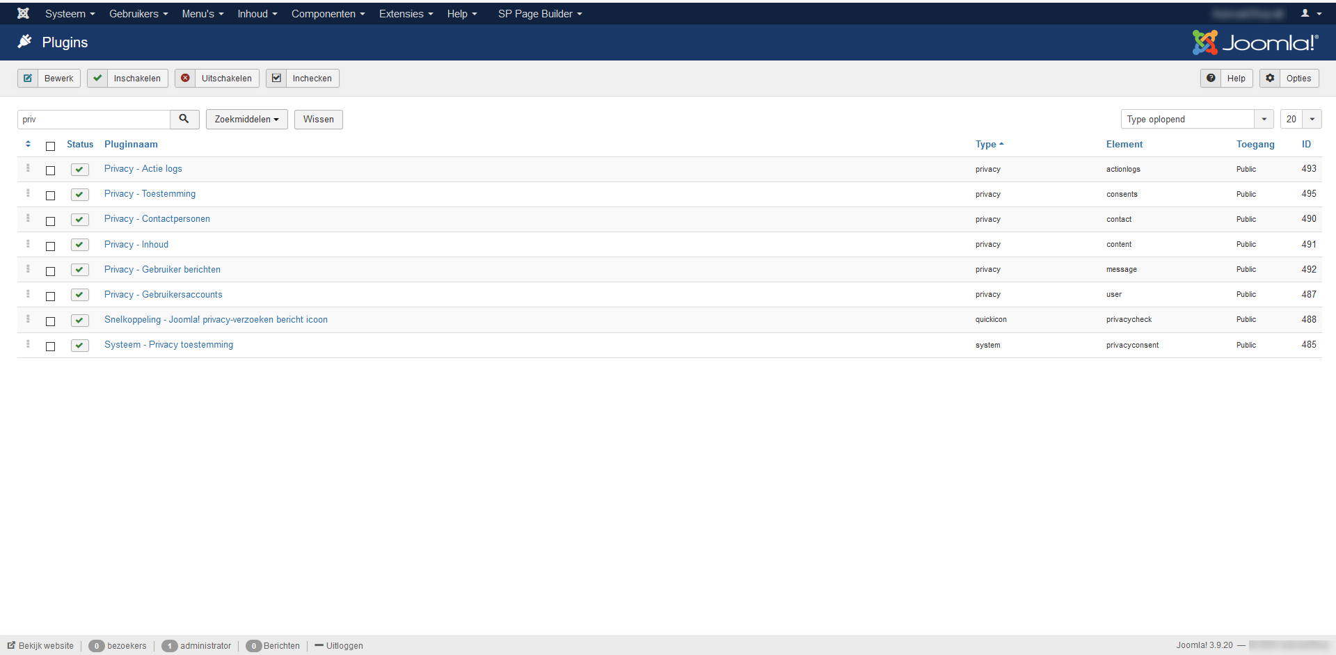

After that I enabled both privacy plugins (see the image below).
Fater that I check if the plugin was working in Joomla. And it is see image below.

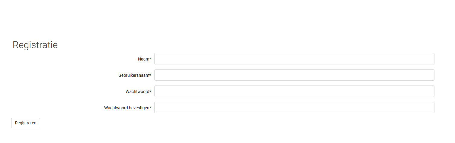

During the guest checkout I don't see the privacy consent but als not when I'm going to register via Hikashop (see images below).
As I told before: int the file checkout / sub_block_login_registration.php I see the code:
if(!empty($this->options)) {
and
This suggest that somewhere the option needs to be set. But I can't find where to enable these setting.
So what am I doning wrong? I totaly out of ideas. Probebly it is something very simple that I oversee.
Please help. This drives me crazy.
  • Posts: 85952
  • Thank you received: 14141
5 years 11 months ago #322810
You don't have the plugin content / confirmconsent on your screenshot.
The word "privacy" is not in the name of the plugin, so that's probably why you didn't find it and didn't enable it.
And thus that would explain why you don't see it on the guest form of the checkout.
Regarding your second screenshot, it doesn't look like the registration form of the checkout, but like the registration form of the HikaShop registration page. I check the situation there, and the system / privacyconsent plugin is integrated to it but only if you have the "enable bootstrap v2 design" setting deactivated in the HikaShop configuration as otherwise, it uses a view file where the integration hasn't been made. so please check on that.

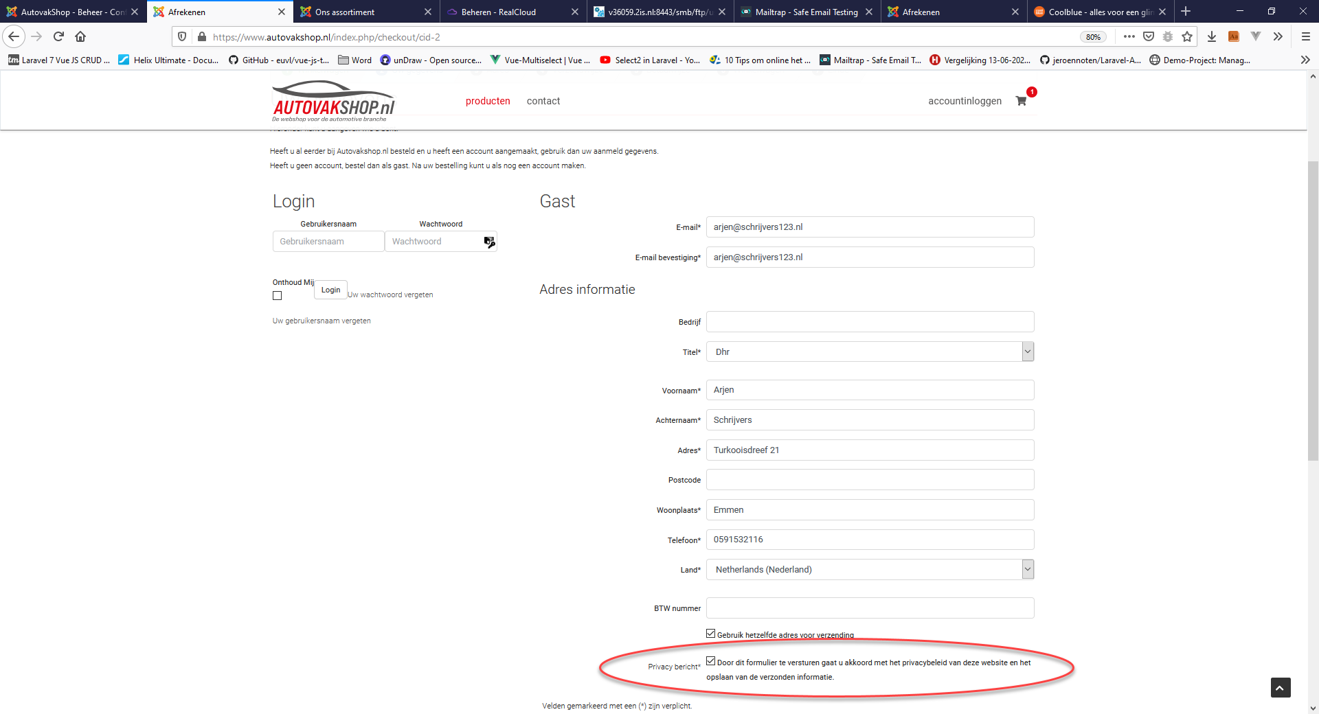

  • Posts: 52
  • Thank you received: 4
5 years 11 months ago #322819

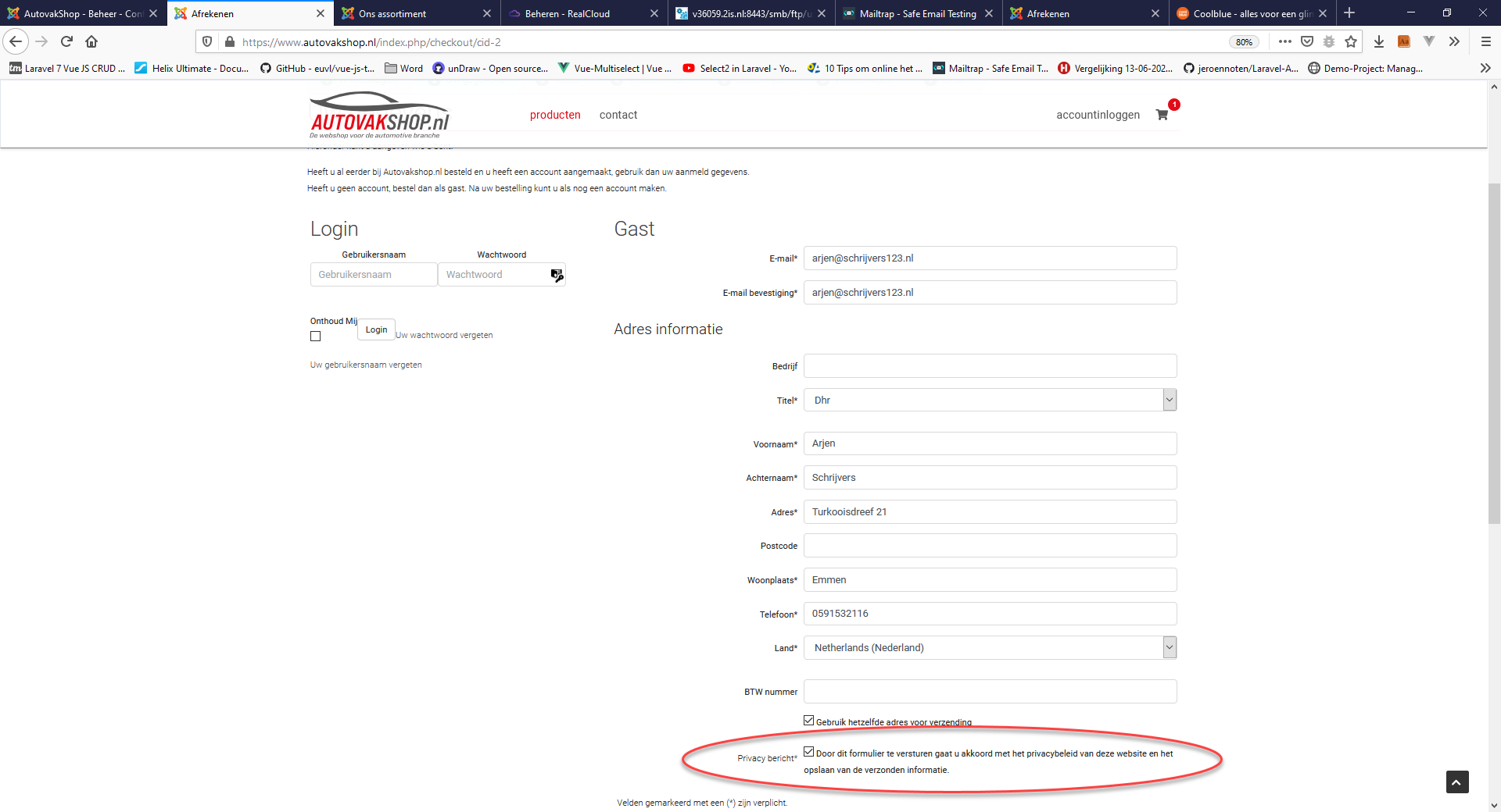

Hi Nicoals,
Indeed I forgot to enable the plugin confirmconsent. Now it's on the Guestcheckout Page.
On the registration still not (or it is because I enabled it during the first step).
BTW the Privacy Suite I can't see that it is not recorded.
Bootstrap design is on.
We are almost there. What's else?
Last edit: 5 years 11 months ago by Ginius.
  • Posts: 85952
5 years 11 months ago #322825
As I said, it will only appear if the "use bootstrap design" setting is OFF, not on.
I suppose that's what you're missing for the registration form.
