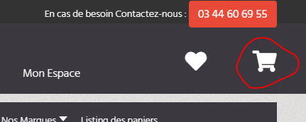

How can we have the cart module redirect on the cart page instead of the checkout page as it currently is ?
we set up the cart module as a mini cart module but when we click on it we go to the checkout page while we want to go to the full cart page
thanks for your help

So if I understand correctly, you want to change the "proceed to checkout" button of the checkout (or the link on the mini cart) to go to the cart details page instead of going to the checkout.
You'll need to edit the file product / cart.php via the menu Display>Views.
There, you can replace the code:
if($this->element->cart_type == 'cart') {
		$link = $this->url_checkout;
	} else {
		$link = hikashop_completeLink('cart&task=showcart&cart_id='.$this->element->cart_id.'&cart_type='.$this->element->cart_type . $this->cart_itemid);
by:

thanks but I'm not sure we are talking about the same thing here:
I want to change the behaviour of the CART MODULE (mod_hikashop_cart) not the view of the cart page view
  • Posts: 85952
  • Thank you received: 14141
5 years 10 months ago #323701
Yes, that's what I understood already. You want to change the link of the cart module so that it goes to the cart details page instead of the checkout.
And the code modification I propose should do it.
