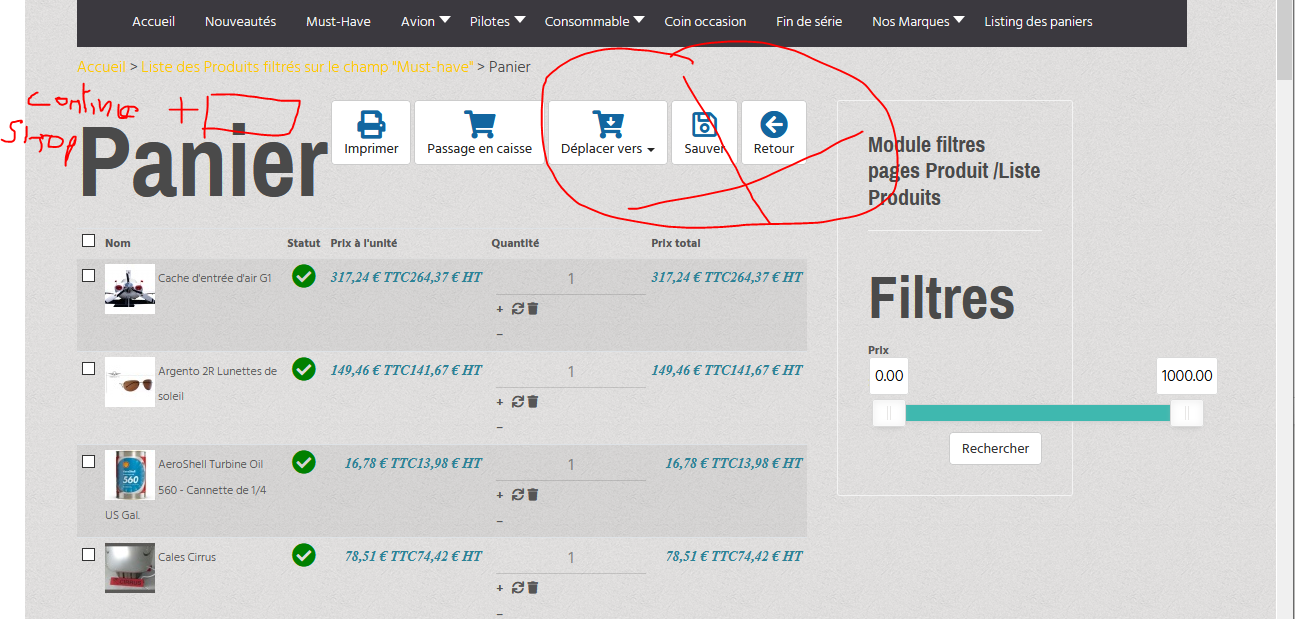

We need to customize the cart page to
* add a "continue shoping " button
* remove 3 existing buttons
please look at the attached screenshot:
We didn't find the answer on www.hikashop.com/support/documentation/1...ize-the-display.html
--> which file should be edited without blocking further hikashop updates ?

The documentation link you provide in your message indicates that you should activate the "Display view files" setting of the HikaShop configuration.
If you do, you'll see that this page is displayed by the cart / show.php view file. So that's the one you want to edit via the menu Display>Views.
There, at the beginning, you can add/remove things to the $this->toolbar array to add/remove buttons to the toolbar like you want to do.

Hello Nicolas,
Thank you very much for your answer,
I had read this page of the documentation however, but I did not understand how to display the filenames of each view .... it's super convenient
So, I did create an override of the "toolbar\default.php" file in my template, but on the other hand I don't see how to modify (remove / add) buttons ??
In this file the different links are not displayed in Html, but are called by a loop ....
foreach($this->data as $key => $tool) {
Does this file not fetch the values ​​defined in the parameters of Hikashop?
I mean: is the display or not of these buttons not defined in the settings of hikashop? I looked several times, and I can not find.
to add the button "Continue shopping", I added it in Html, following the html structure of the other buttons:
But to target the 3 buttons I want to remove.......
Please help me make this work,
Agathe.

We didn't understand why you start from the "toolbar\default.php" view as Nicolas told you to create an override from the "cart/show.php" view, and to simply modify the content of the array in $this->toolbar.
In details, do like this will allow you to add/remove elements (meaning here, buttons) to fit your needs.
Hope this will help you to progress on your subject.
