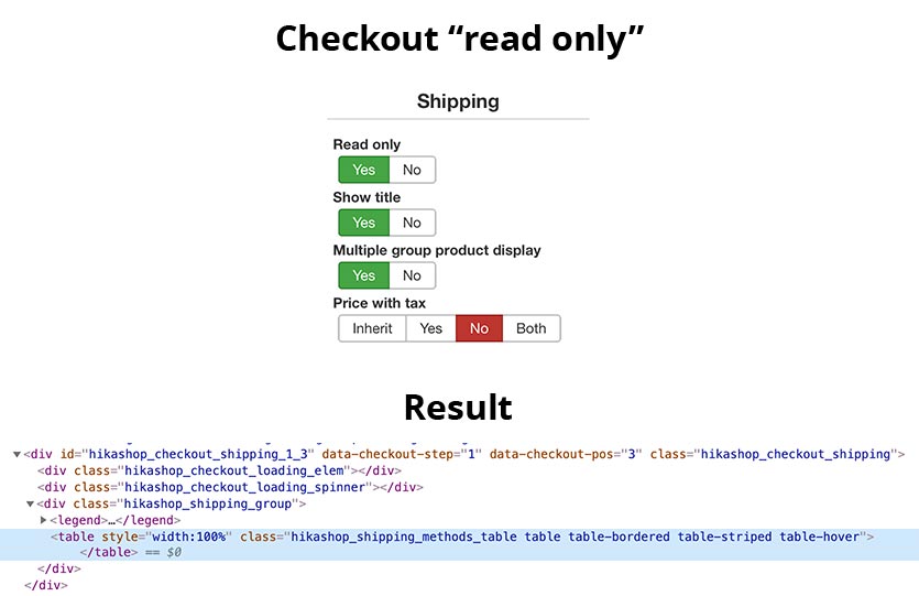

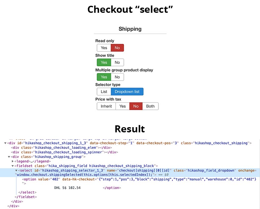

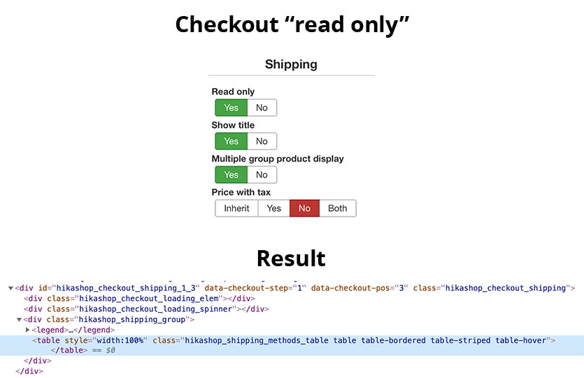

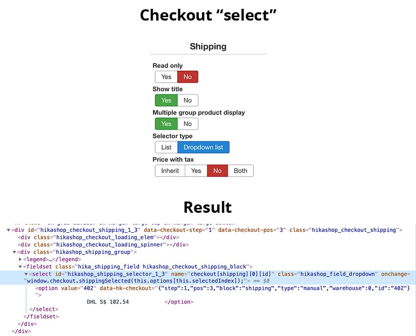

The system is configured to show always only one single shipping method, so it sure makes sense to set the section to "read only".
Except, it doesn't work. With "read only = no" it gives me a select or radio, depending on setting, But with "read only = yes" it produces only an empty table tag. Please see screenshots, and please rest assured that nothing else had been altered in between screenshots.
By the way, it's working fine with payment methods.
Thanks for a fix.

5 years 11 months ago #324674
Thanks Mohamed,
I had switched to Protostar when checking and before posting. Anyway, I'm now using a different solution as I have to move on. Perhaps I get back to this later again and, if it persists, then either set up a virgin site or clone the one in question for you to double-check.
5 years 11 months ago #324676
I just succeed to reproduce that issue which was happening only when one shipping method was available.
If it's not too late, can you download the last Hikashop version through our website, install it and test it again ? Thank you !

5 years 11 months ago #324700
Hi again,
Ok, indeed the mystery is solved now.
When changing my scenario to multiple shipping methods offered, I also stumbled over the bug that the default one wasn't pre-selected, as reported also by others here in the forum. That caused nothing being displayed with "read only", obviously. And installing the latest and greatest as suggested by you fixed it all then. So, thanks for that.
