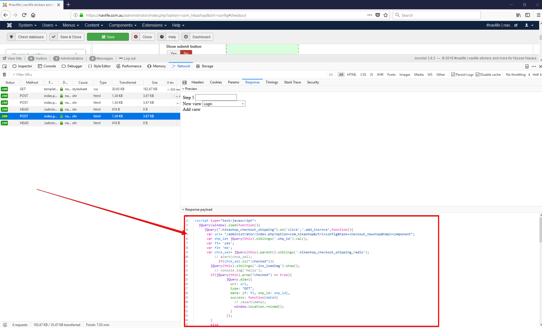

i install last version of hikashop on my joomla 3.9.2. i can not update my joomla because some of other extensions need sync and i need time to update. but i can see repeat this warning in console mozila firefox each time click on "add view" button:
Empty string passed to getElementById().
i study this post:
www.hikashop.com/forum/checkout/895437-c...eps-not-working.html
and see this pic:
and i understand "mellat" plugin for add Iranian payment method to hikashop is my problem. and when disable that , my problem is solved.
this post for future users...
thank you...

Yes, you can disable the plugin while configuring the checkout workflow to circumvent the problem.
Ideally, it would be better to modify this plugin to output its javascript only on the frontend, not in the backend. And that would solve the problem.
If you can contact the provider of that plugin to notify them about the issue and what I wrote above, that would help people using the payment plugin in the future.
