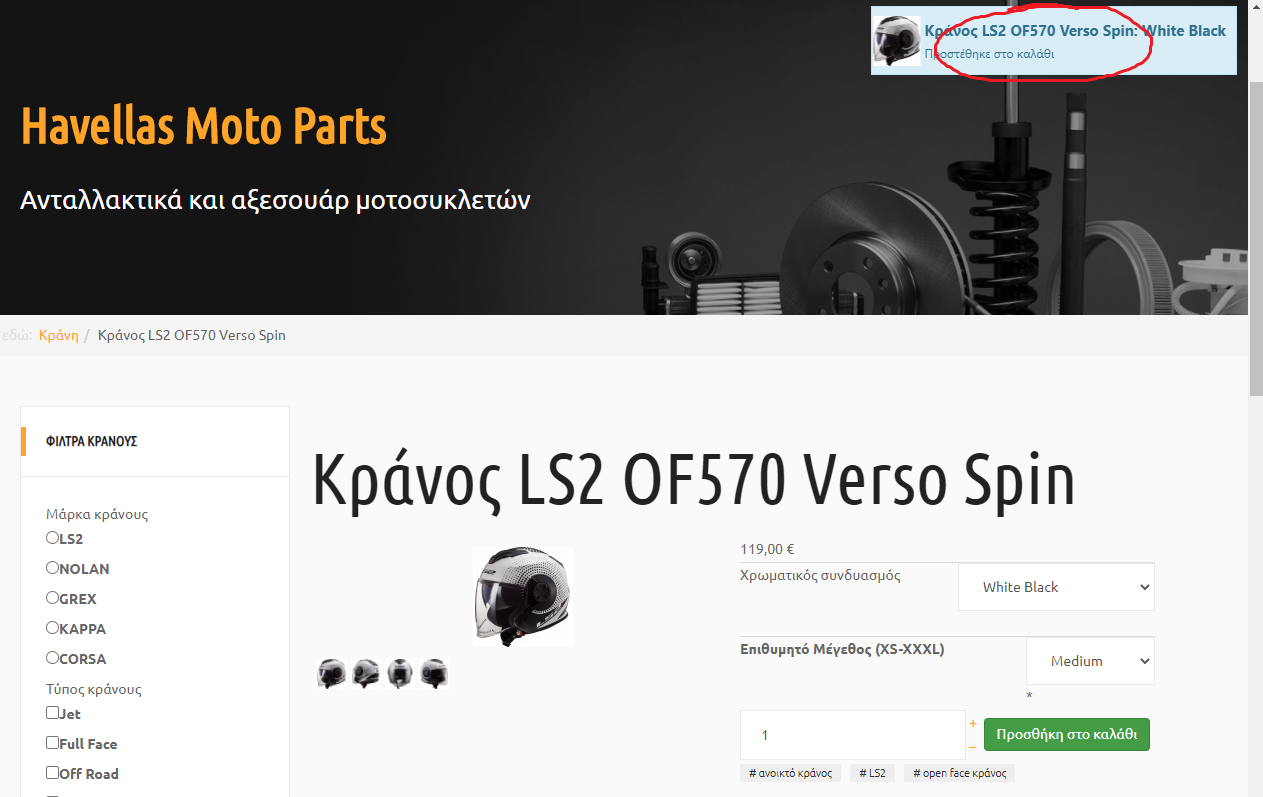

I would like the add to cart notification to be clickable in order to get you quickly to the checkout (cart).
I can see the cursor changes when I hover the mouse but clicking on it does nothing.
Thank you in advance!
Yannis

5 years 9 months ago #326925
The library we use to generate that notification box doesn't allow us to make it clickable.
What you could try is to do a translation override of the text displayed there to add a "a" HTML tag around the text.
That way, you could click on the link.
Another solution would be to change the notification box with the settings of the HikaShop cart notification plugin via the Joomla plugins manager. There, you can change it to use a popup and in that case, the popup will contain a button to go to the checkout.
  • Posts: 66
5 years 9 months ago #326951
the text method is not optimal as I cannot click the whole "notification".
I wouldn't use the popup as it is too obtrusive.
Can I make it clickable with some extra Javascript?
Yannis

  • Posts: 86214
  • Thank you received: 14221
5 years 9 months ago #326967
You could try something like that:
		$(document).on("click", ".notifyjs-hidable", function(e) {
			window.location='xxx';
where xxx is the URL of the checkout page.
  • Posts: 66
5 years 9 months ago #327016
Thank you,
this is quite a simple fix. Why don't you include this simple patch in the notification plugin?
...just for others who may use this code, in my template (T4 Framework) I had to replace $ with jQuery:
jQuery(document).on("click", ".notifyjs-hidable", function(e) {
