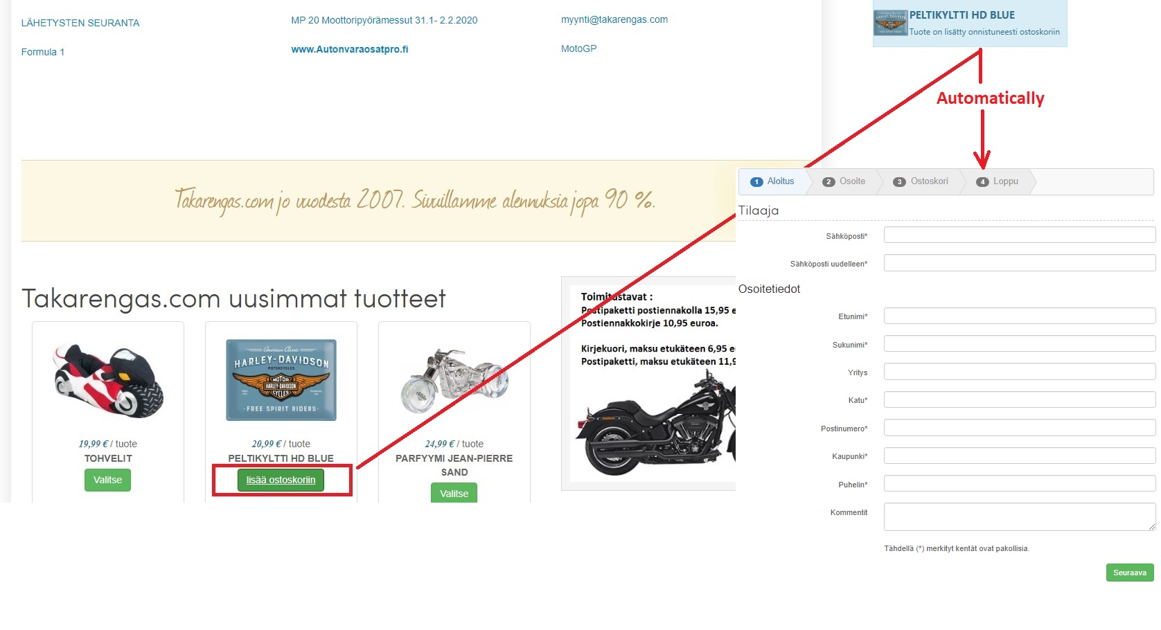

I would like to after selecting the product, do not checkout.
Test pages have been upgrades, the checkout workflow was quite different. I could not everything got changed in the back. ( like www.takarengas.com/ , not yet updated).
How do I get action back ?
Best regards,
Thunder

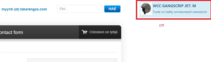

How do I get a pop up window off, because it doesn't work ?
Best regards,
Thunder

  • Posts: 68
5 years 8 months ago #327850
Now we got to what was beginning:
What to do now ? Should work like www.takarengas.com .
Best regards,
Thunder
