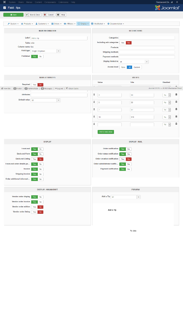

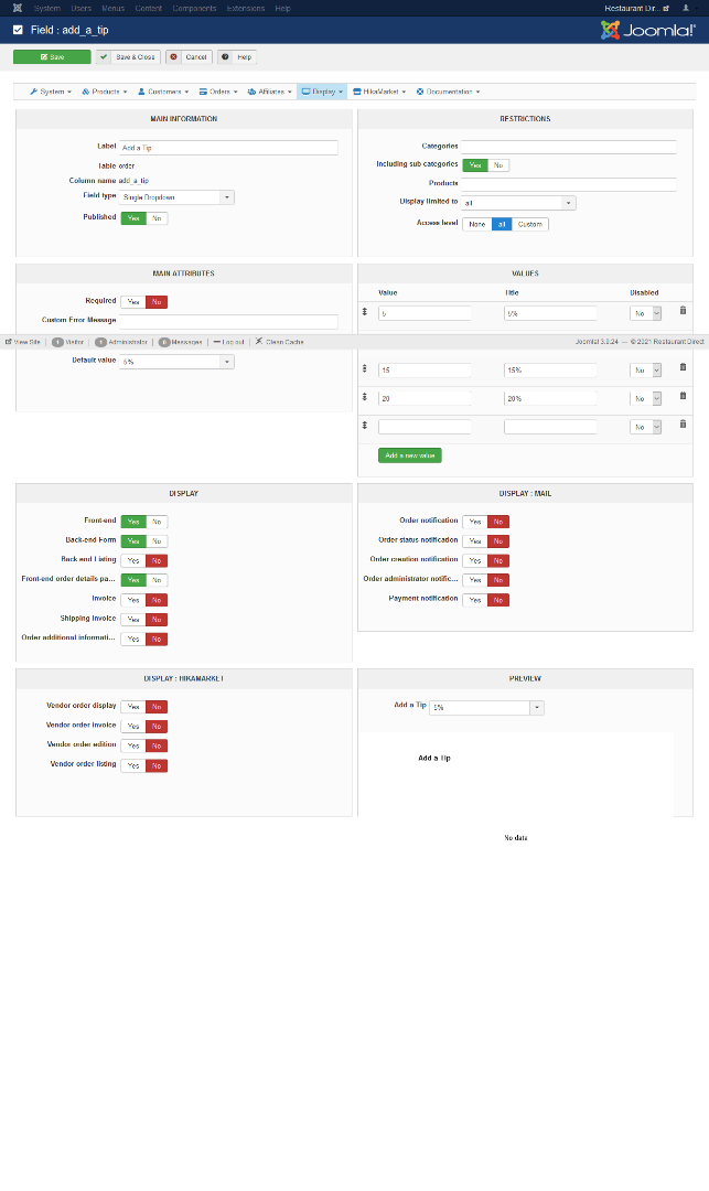

5 years 7 months ago #329527
Hi again,
I tried to do this, but I think I am doing something wrong!
Can you take a look at the settings on the two "steps" and let me know what I am doing wrong? I do need them to be percentages, so that might be complicating things?
Thanks!
  • Posts: 86214
  • Thank you received: 14221
5 years 7 months ago #329598
The plugin doesn't handle percentages.
Note that I never said that this plugin could handle percentages.
And you need to enter the values and corresponding prices in the "prices" table of the plugin instance. So if in your custom field you have the values 5, 10, 15 and 20, you need to have 4 rows of prices in the plugin instance, one for each value of the custom field with the corresponding price that will be added to the cart when the value is selected by the customer.

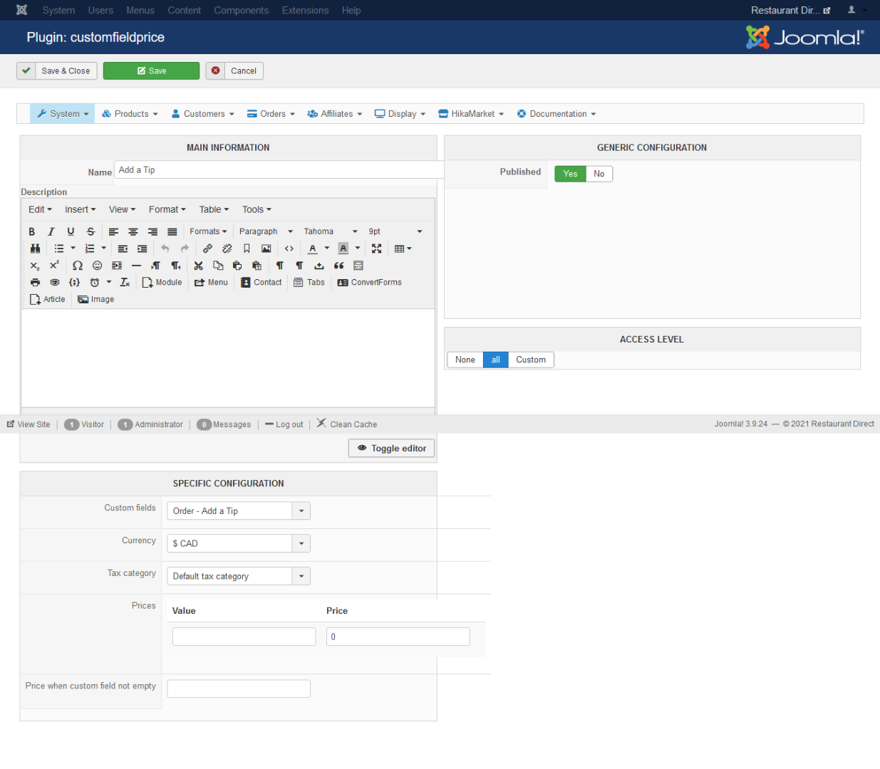

5 years 7 months ago #329604
Hmmm. I did say it was for tips though. That's usually percentages.
ANYWAY, when I try to set up the plugin, it will only allow me to create one price. The "+" sign disappears after I add the first one.
Obviously I need to add several. How do I do that?
  • Posts: 26387
  • Thank you received: 4078
5 years 7 months ago #329608
What "+" are you talking about ?

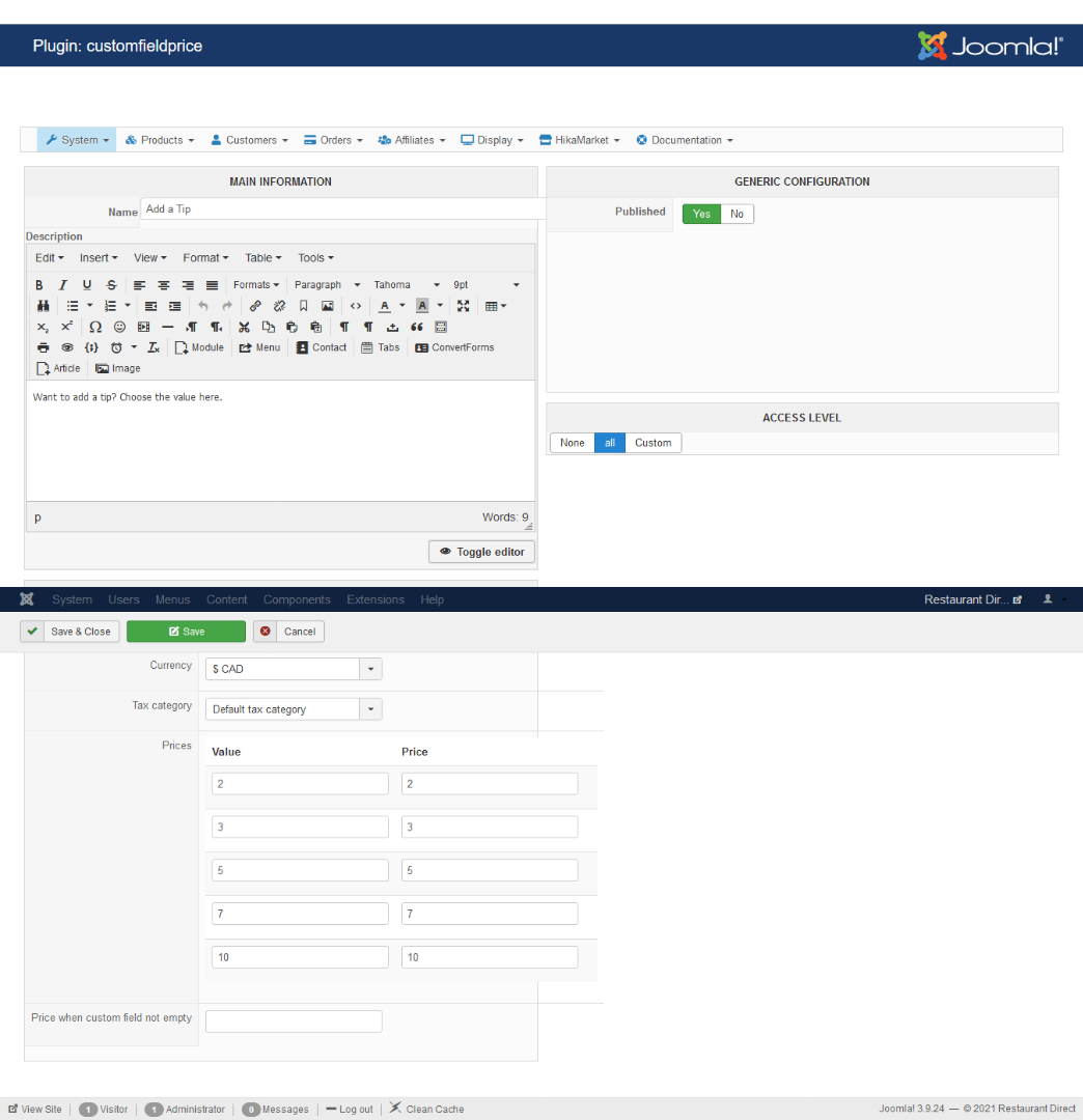

5 years 7 months ago #329671
This one.
Do I have to do a different instance of the plugin for each price?
Would be nice if there were documentation.
  • Posts: 26387
5 years 7 months ago #329722
Looking at your previous screenshot :
www.hikashop.com/media/kunena/attachment...customfieldprice.png
I do have the feeling that the "+" button is still working but is not visible for you.
Some fields are too wide for what they should. It looks like a CSS issue
I suppose that if you try to resize your browser window, you can force the display of the page in "one column" instead of "two" ; and make the "+" button visible again.

5 years 7 months ago #329737
Hi there,
I got it to work, and I've added the prices on the plugin. I added the custom field to the checkout process, BUT, when I select a price from the drop down list, it does not add to the the order value?
What am I missing?
  • Posts: 26387
5 years 7 months ago #329769
We need to see your website directly in order to understand what could be the issue.
