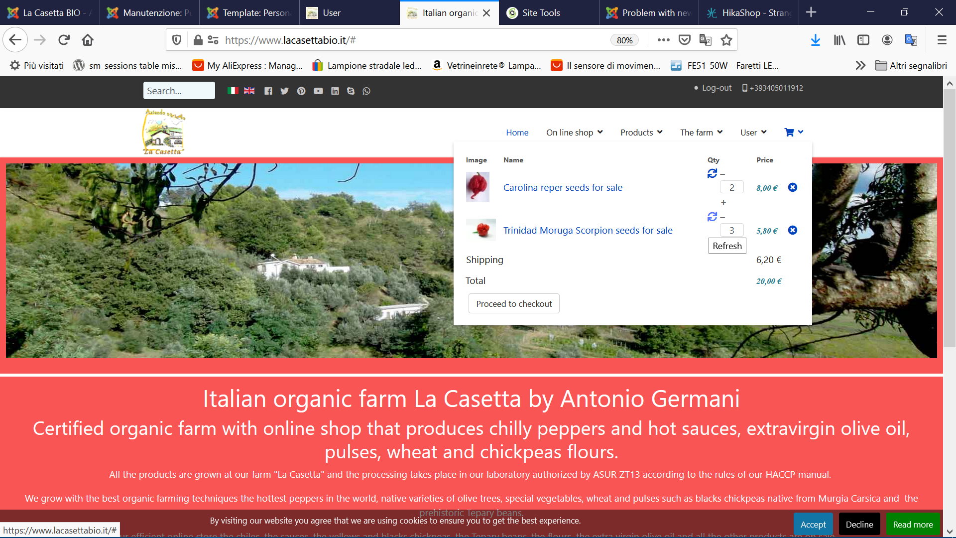

Hi, I noticed that on my minicart does not work the refresh/update button.
The refresh/update works fine on the check-out cart.
Could you help me, please?
Thanks a lot
Best regards
my site with Hikashop
www.lacasettabio.it
Last edit: 5 years 6 months ago by lacasetta.
  • Posts: 86214
  • Thank you received: 14221
5 years 6 months ago #330170
The refresh actually works there if you enter the new value in the input field and click on the refresh button.
From what I can see, it only doesn't work when you use the - and + buttons to change the quantity before pressing it.
And if I check the console of my browser when I do so, I can see some javascript error when using the refresh button.
And I can also see that the javascript of this button has been customized (which is why you get that error) :
i.imgur.com/UlUfyi9.png
Apparently, that cart module is customized by your template or something else.
I suppose that if you rename the file templates/YOUR_TEMPLATE/html/com_hikashop/product/cart.php via FTP, it will then work fine, which will confirm that the issue comes from some customization in that view file override.

Replace the code:
<a class="hikashop_no_print" href="#" onclick="<?php echo $script; ?>" title="<?php echo JText::_('HIKA_REFRESH'); ?>">
by:
	<a class="hikashop_no_print" href="#" onclick="var input = document.getElementbyId('<?php echo $id; ?>'); if(input.form.onsubmit && !input.form.onsubmit()) return; input.form.submit();" title="<?php echo JText::_('HIKA_REFRESH'); ?>">
in the file components/com_hikashop/views/layouts/tmpl/quantity.php and it should fix the problem.
