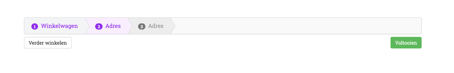

I just upgraded to the latest version of HikaShop business, however my checkout steps are gone now. I already reconfigured them, but I cannot get the address details to appear (so cannot complete checkout now).
I already enabled the setting to ignore product weight. Also login/registration is not enabled.
What can I do?

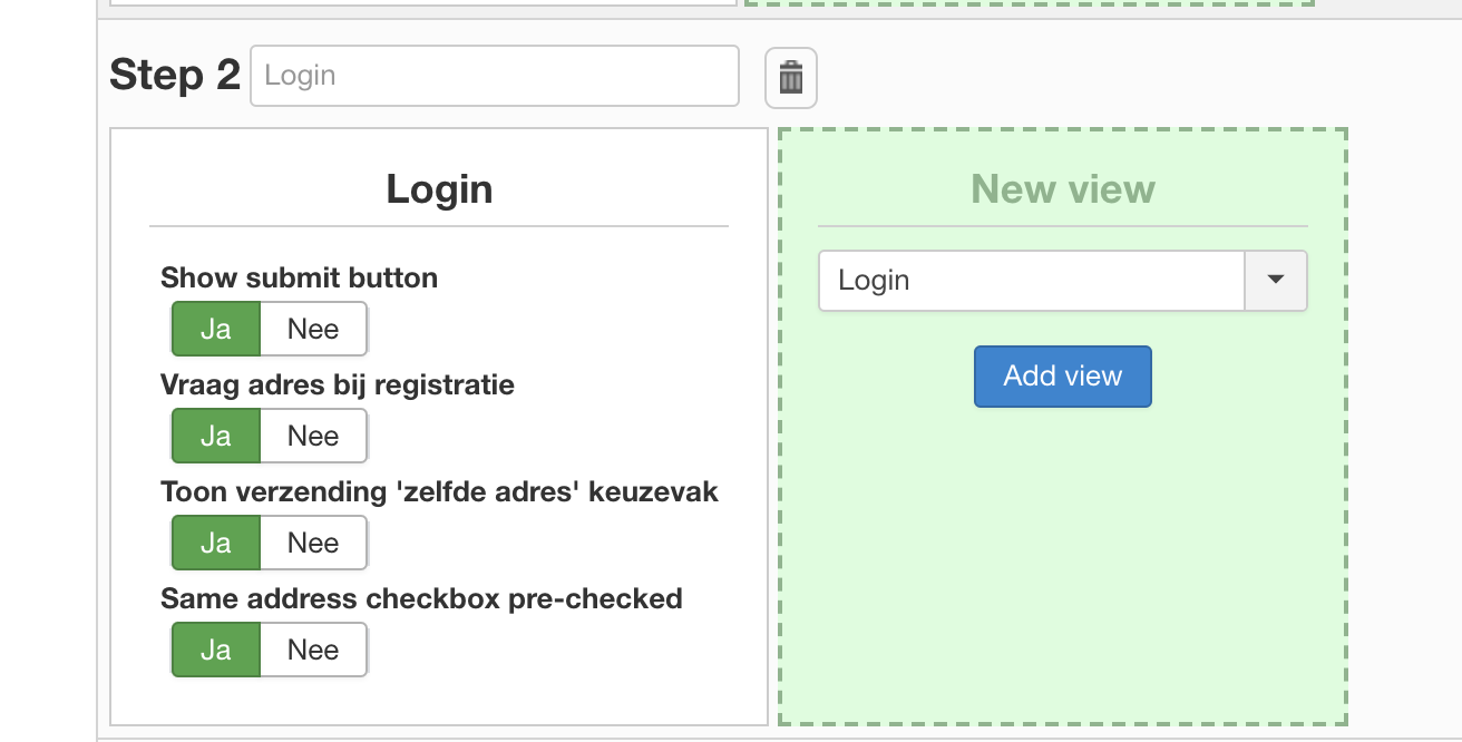

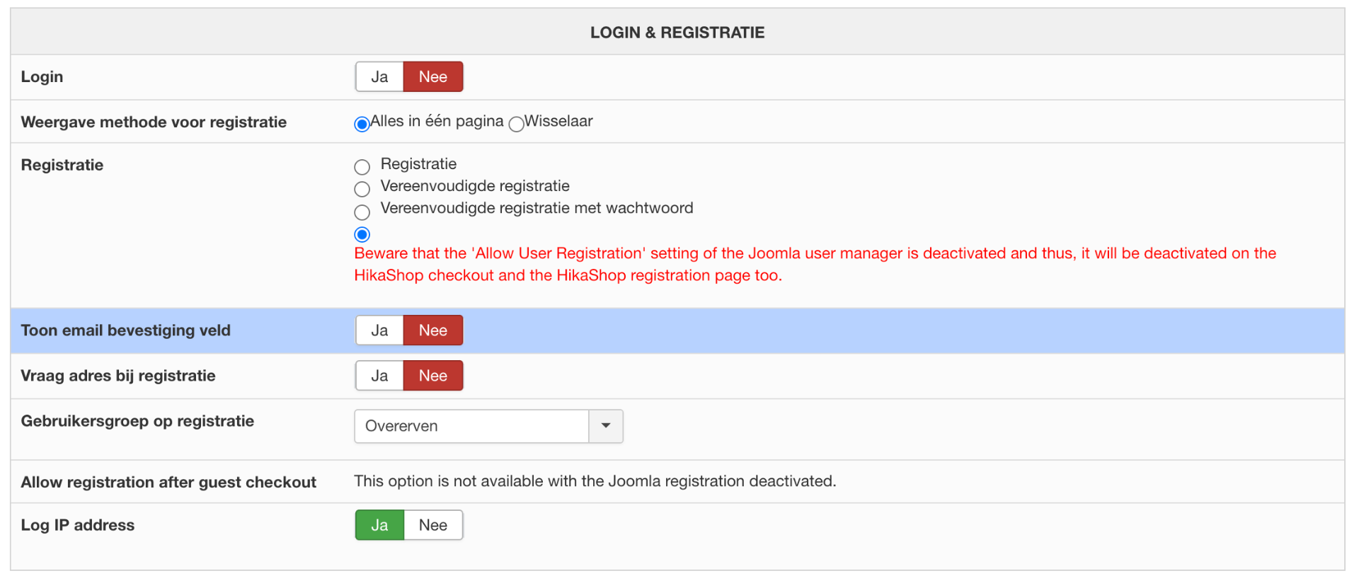

  • Posts: 8
5 years 4 months ago #332278
Thanks for your reply. Okay, I did the following:
  1. Disabled registration in Joomla (again)
  2. Added the login form in the workflow (see attachment)
  3. Checked if login setting were set to Guest checkout (see attachment)
This should work I believe, but results in a 500 error on my checkout page (in the login step)
