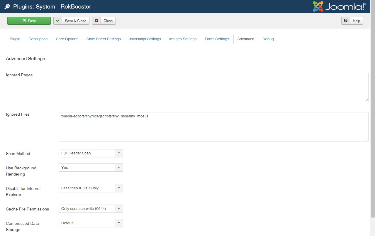

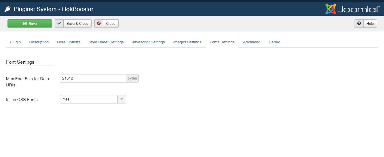

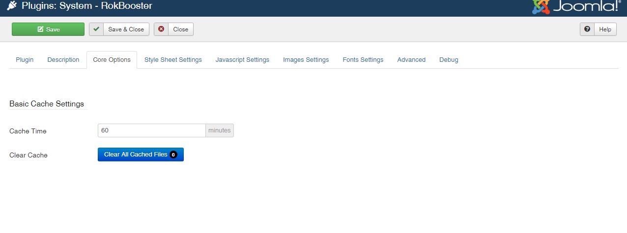

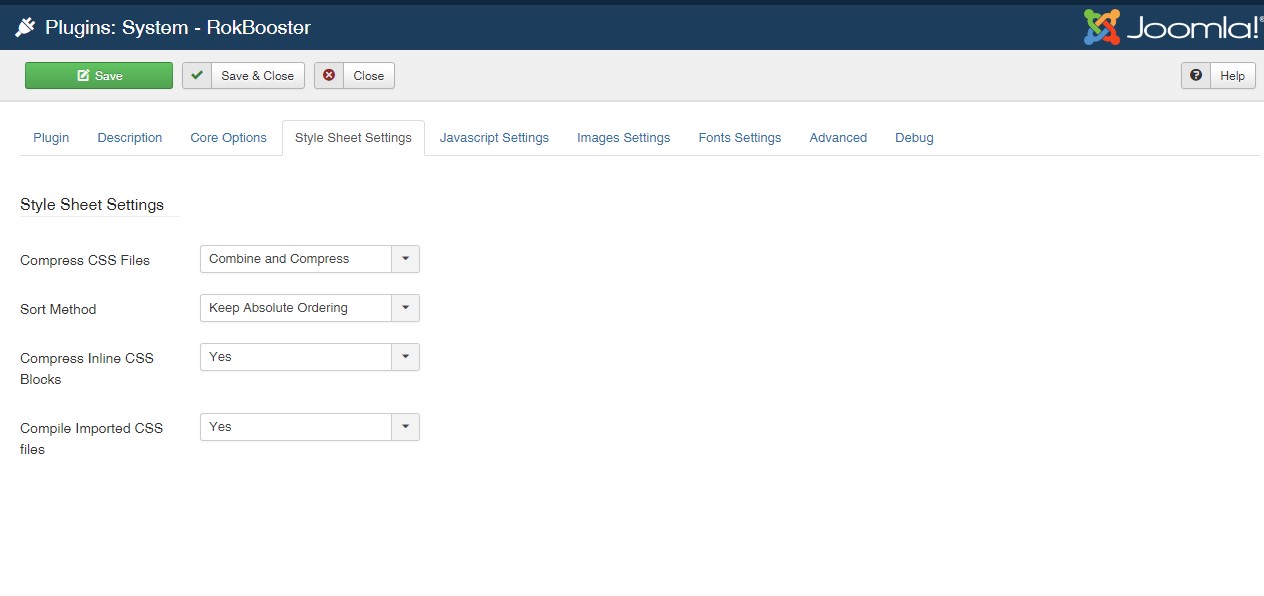

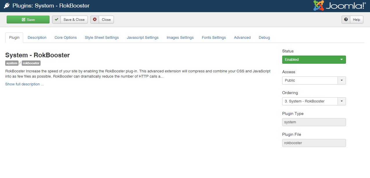

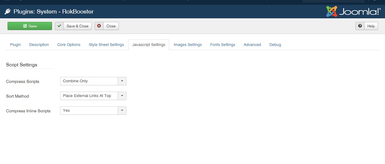

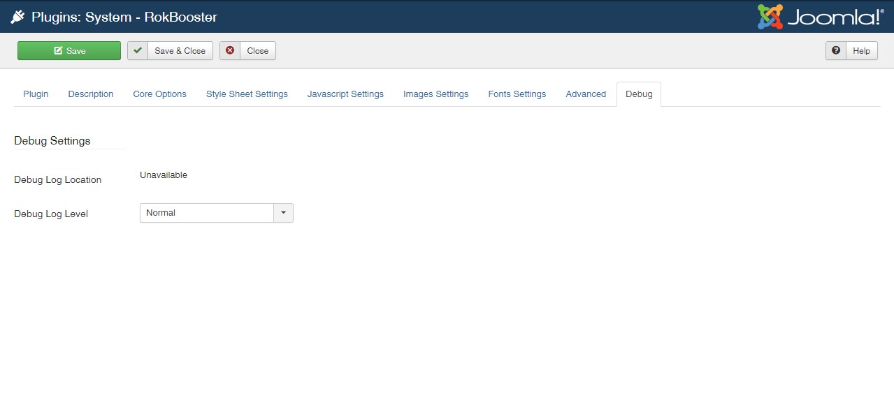

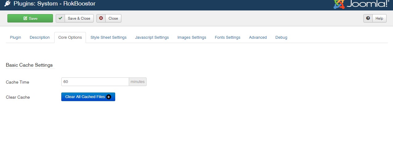

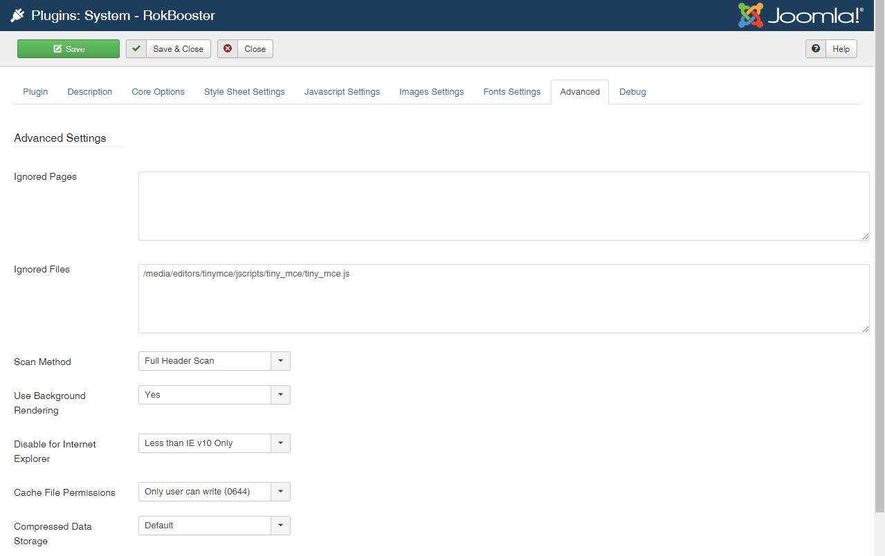

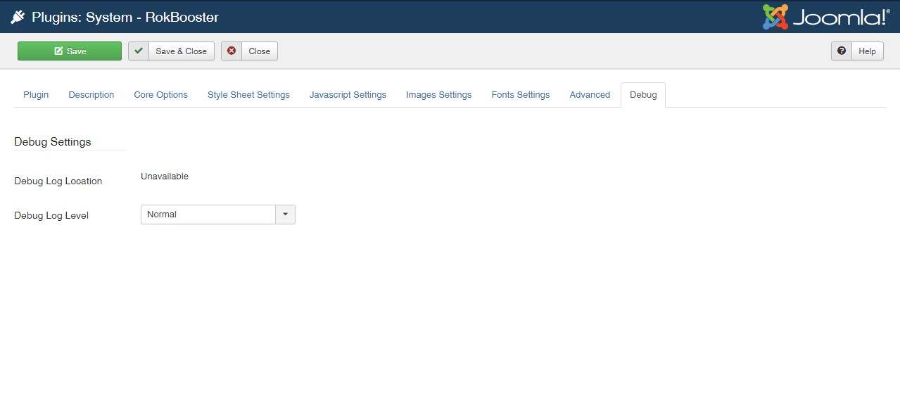

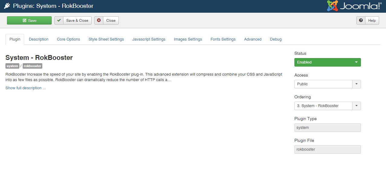

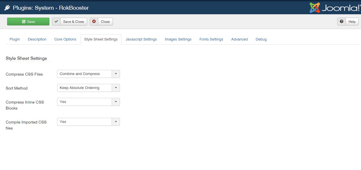

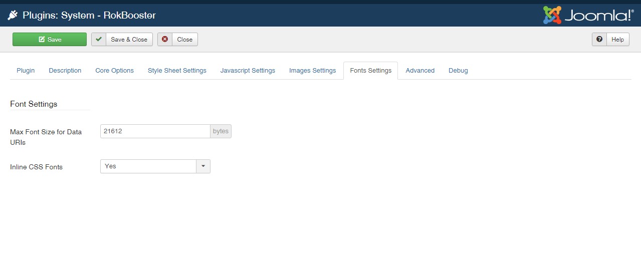

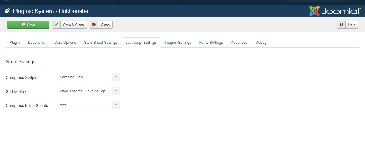

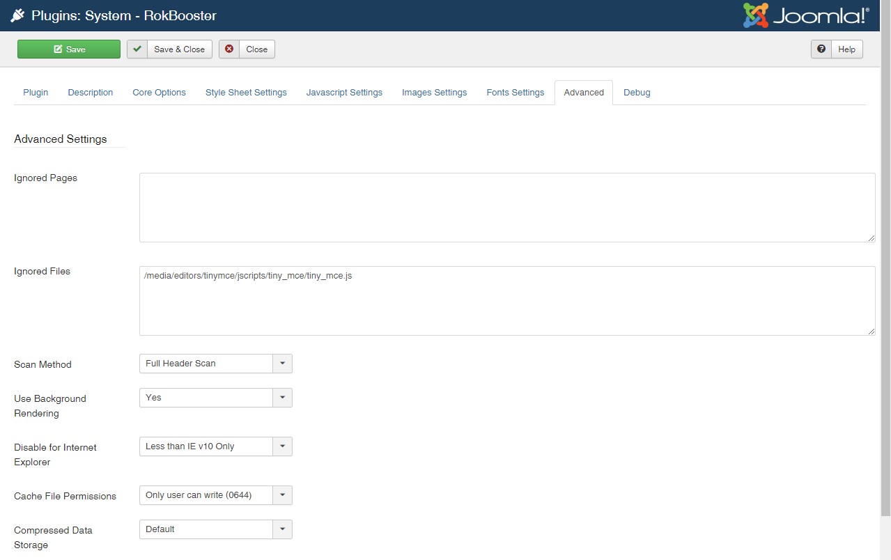

unfortunately i dont know much and i have none can help me :( :(
this what i found ... gives you any idea?
Best regards
  • Posts: 5
5 years 4 months ago #332601
Last edit: 5 years 4 months ago by Aris.
  • Posts: 86214
  • Thank you received: 14221
5 years 4 months ago #332602
I don't know how rokBooster works. You should ask RocketTheme's support about what should be done.
From the options I can see on your screenshots, the "use background rendering" option seems like the most probable of causing the issue.
Try to disable it.
If that doesn't help and you can't get in touch with RocketTheme's support, you can always turn off the rokBooster extension.

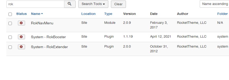

  • Posts: 5
5 years 4 months ago #332619

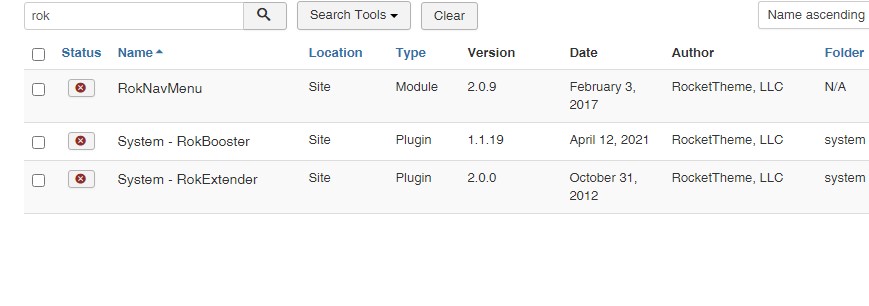

Hi!!
i disable all rok...
still the same...
