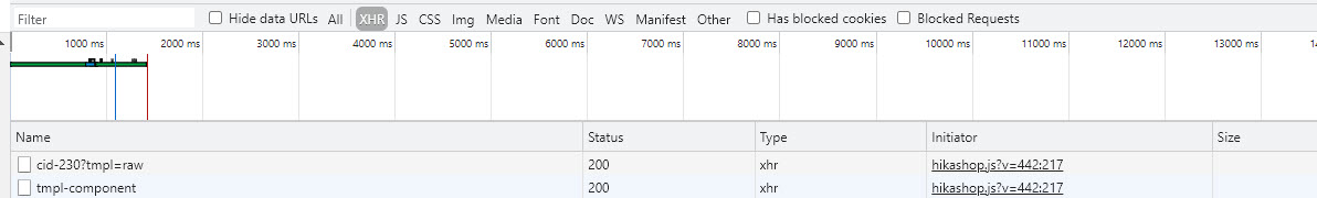

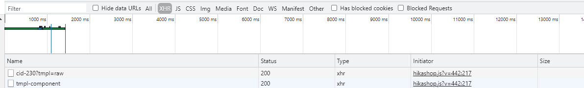

We have cleared all errors reported in dev tools and within Joomla's error reporting but the issue persists. We ran an xhr test in both chrome dev and firefox and both results were the same (see attached). However, firefox showed the item in the cart and Chrome did not. FF allows us to go to the checkout, chrome redirects to the product page. I feel like the user session is being lost. Any ideas of why that would happen in chrome? Is there a way that I can send a super user login to you privately so that you could help us determine why this is happening.

One thing I can think of would be a plugin which synchronizes the backend and frontend user session, or that you have activated the "Shared Sessions" setting of the joomla configuration.
In that case, when you login in the backend, it's normal that it wipes out the frontend user session with the cart. And maybe there is a bug between this mechanism and the cookies handling on Chrome (or a Chrome extension that you all have installed).
So I would recommend to check on that.
If that doesn't help, you can provide a backend access via our contact form along with a link to this thread so that we can try to reproduce the issue on your website and check your backend settings:
Maybe that would allow us to figure something out.
